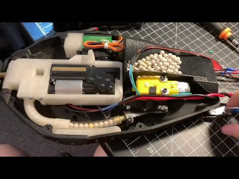

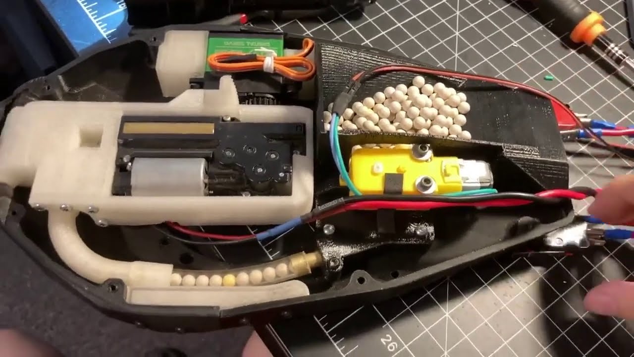

    So this is something that I cooked up the past week, utilizing a geared dc motor to pump feed BBs into an airsoft magazine gearbox, all neatly tucked away into the turret. In the current configuration magazine can hold 450 shots and has a rof of 300 rpm. That makes for a solid 90 seconds of nonstop full auto. Capacity however can be arbitrarily increased to more efficiently fill the cavities inside the turret.

      That looks amazing. Did you replace the HL airsoft unit with a different one or is it the stock unit?

        It's an airsoft pistol gearbox, making it much much stronger than the stock unit.

          You inspired me, that's quite some engineering. I know the type of airsoft unit however I was not able to find the exact dimensions and weight. Now I know it will fit into my tank. Welldone
