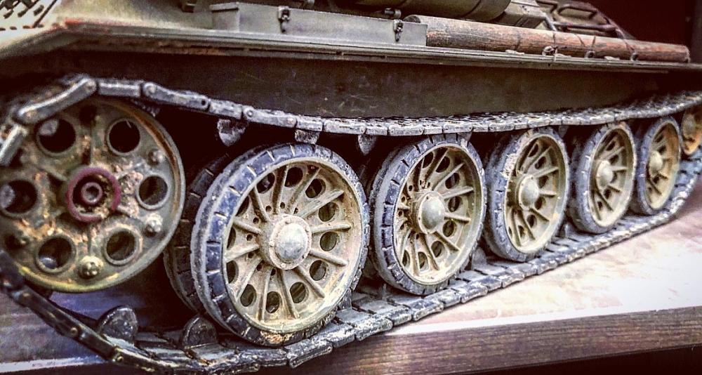

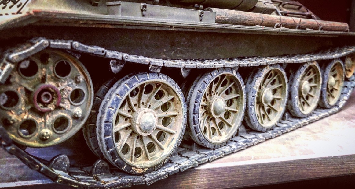

    First question. Are all your tanks 6.0 versions?
    WWII German tanks were well known for having track issues and this is carried over to the scale models. They do require a bit of tinkering to get to run well just like the real ones did.
    If your T34 is a 5.3 version it will NOT have an adjustable front idler. If it is a 6.0 version IT WILL have one. Regardless the T34 is well known for being very forgiving with its track tensioning. I run mine rather “slacked” where the track is laying on top of the road wheels. Both my T34s have no track issues. If you loose a track though the easiest way to put it back on is to simply unscrew the rear sprocket halves and replace the track then screw it back together.
    Keep in mind on all your tanks you may have to remove links or add links to achieve the proper tensioning even with adjustable idler wheels.
    Metal tracks take a while to “wear in” as they are stiffer when new but as they wear they become far more flexible then the plastic tracks but maintain being many times stronger.
    HL 6.0 T34 with metal tracks.

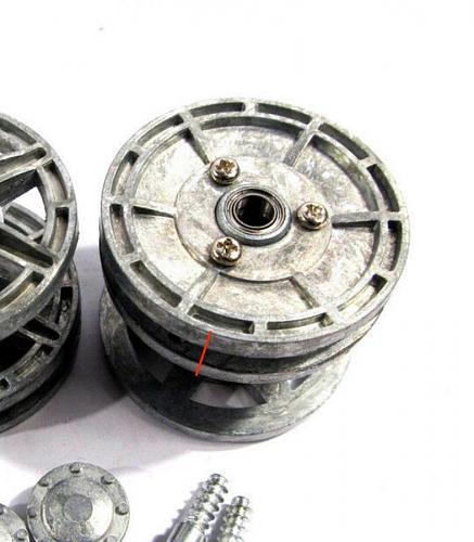

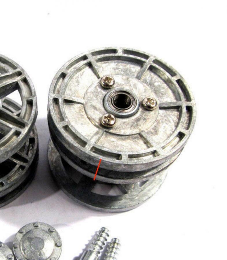

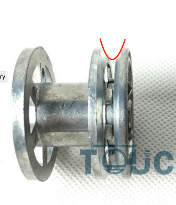

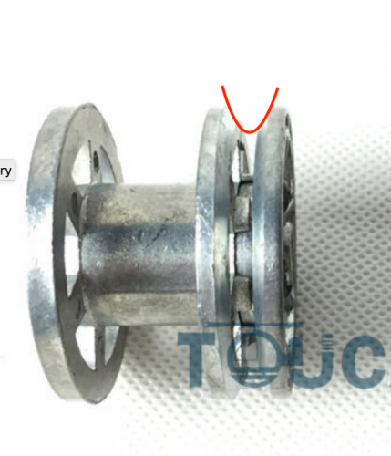

            I have noticed that the larger modern main battle tanks flex more than the smaller WWII tanks. The metal tracks grab the ground really well which makes the flexing even worse. I had nothing but issues with my Challenger II with metal tracks. I could not go 5 minutes before the tracks would come off. I added bearings to the main drive shafts which helped a lot. That should be a standard feature. But ultimately I put on a set of plastic tracks and now I can drive the tank all day. The plastic tracks will slip more on the ground and take the pressure off of the hull.
            I am not sure about your JagPanther but my King Tiger with metal tracks, sprocket, road wheels, and Idler had a tendency to creep off of the idler groove. And always sounded rough like the teeth were catching an edge. After some investigation I discovered that to resolve this issue the King Tiger's idler needed to have a V shaped groove ground into the Idler. This mod made the tank much smoother and the tracks would no longer creep off of the correct part of the Idler. See images. below. I believe Heng Long upgraded the Idler because you can now buy one with the V shaped groove already there.
            Here is the what it should look like with the V in the part of the Idler that the teeth go.
            Click image for larger version  Name:	Screen Shot 2020-10-08 at 11.25.51 AM.png Views:	0 Size:	368.6 KB ID:	282114
            Here is how the Idler came in my King Tiger. It was totally flat. Once a tooth caught an edge it would pull the track out of the grove.
            Click image for larger version  Name:	Screen Shot 2020-10-08 at 11.27.25 AM.jpg Views:	0 Size:	72.6 KB ID:	282115
            I was able to grind in a rough V shaped grove in my Idlers using a Dremel tool and grinding bit.
