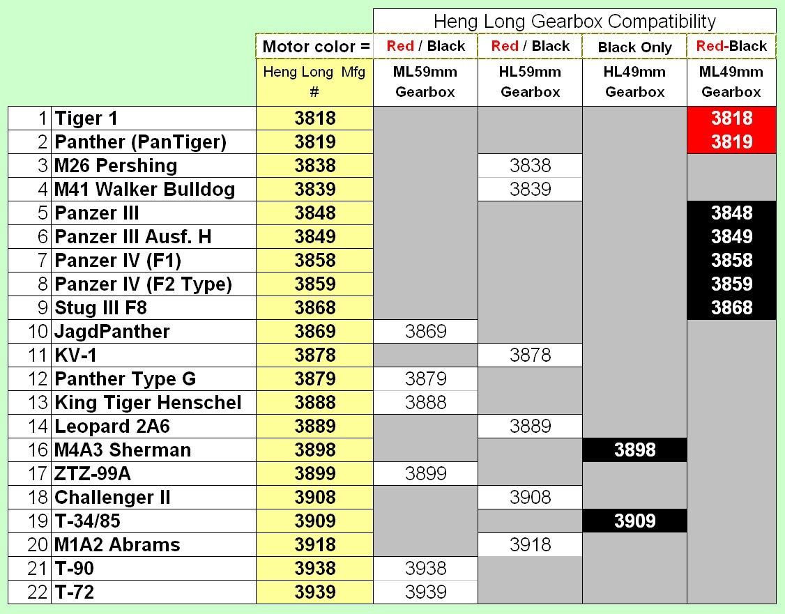

          Heng Long gearbox fit chart.
          Click image for larger version  Name:	fetch?id=272855&d=1599320066.jpg Views:	0 Size:	233.6 KB ID:	283070

            The quest continues....The Heng Long sealed gear box turns out to be a 49mm not 59mm. Screwed up twice. Researching out a steel gear box that will drop in with soldering fit. So the HL Ultimate 2 59mm looks like it will fill the bill. In the meanwhile,I have a sealed HL 49mm. May try it on the PanTiger. It has a 49mm shaft. Gotta do a smoker removal on it anyway, so I can take a look. Going to try a laser mount in the barrel attaching it to the 6.0 board to #1. Fun and games continue. I hate it that I learn the hard way. Ghesh!!

                I continue to upgrade the gear boxes on the HL Abrams M1A2. I came with plastic gears and with the upgrades of idler, drive and track, I know steel gears are essential for durability. When I ordered the HL enclosed gear box, the plastic gear box had a 49mm final drive, so I ordered a short 49mm. The fitment chart calls for a 59mm long shaft. Is that my problem with fitting the gear box? Would i better off with a 59mm? Were some HL Abrams fitted with 49mm plastic gear boxes? The mounts match up. Any insight would help me fabricate a proper mount. Thanks in advance.

                  All of the Abrams are 59mm. The 49mm output shafts are to short and will not position the sprockets in the correct alignment with the road wheels and tracks.
