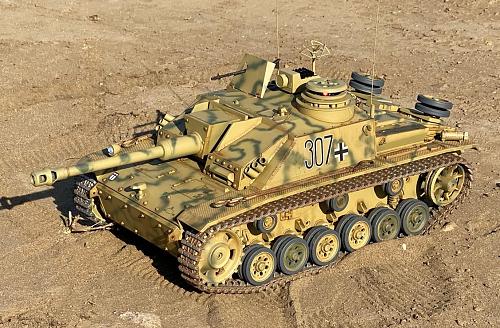

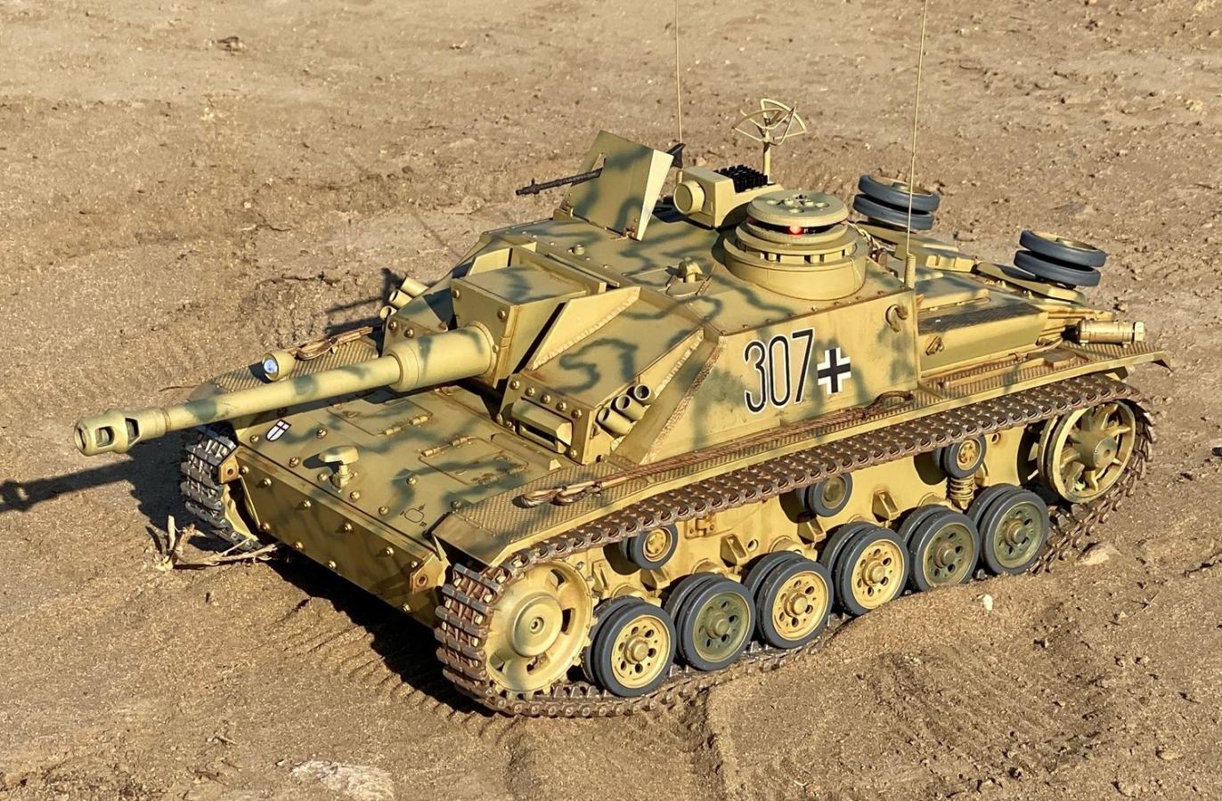

                      One thing I've done is use the magnet on the underside of the turret or tank top to mount a camera. You can see an FPV camera in this photo. It is offset, but you could glue your own magnet underneath. You can then place and remove it with no impact on "authenticity". If you set up a camera in line with the barrel, you'd have traverse so you'd only have to estimate elevation. You could also incorporate the laser diode in that mount!

                        Nice job! That blends in very well on the stug. Now that I think of it, an fpv camera setup is simpler on stugs, jagdpanthers, etc since gun and vehicle facing always align, so it does gunnery and driving all at once.
                        By the way, is that camera powered off the camera port on the board?
                        • SoCalBobS
                          • 2754
                          • Southern California
                          It can be, I just haven’t wired it. I use a 1S500 tucked in the rear deck. On 1S it has about the same range as the tank Tx, so static tells me “come back”.
