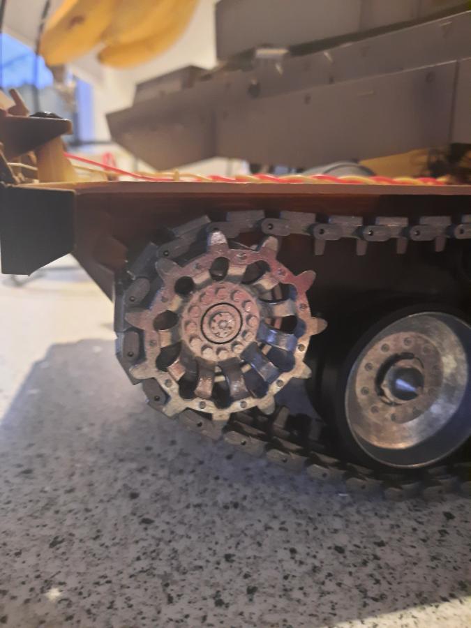

ID:	285610 Well got the chally from Toucan, big shout to them, got my tanks here in 2 weeks. But on the chally the drive sprocket, which is metal, has partially separated, so I assume that the Allen screw is loose. Do it up I hear you scream, at Toucan they put the hub covers on, and the one on the sprocket is recessed. How can I pull that damn cover off?My last option could be drilling a small hole in it and screwing in a small screw just to get leverage on it. Help

    Take both sprockets off and the re-install them making sure they fit flush together. Sprockets halves routinely come loose and need to be checked and re-tightened from time to time. Best to leave the drive sprocket screw exposed so it is easy to inspect.

      My problem is with getting that hub cover off. I think HL needs to start putting out a range of 1/16 scale mechanics tools for these things

        Use a small drop of oil and let it soak in around the “hub cap”. This has and does help with the metal on metal caps as they tend to be overly tight on all the tanks.
        I use a thin narrow flat head screwdriver as a pry which has worked out well for me when I have issues with metal caps not wanting to come off.

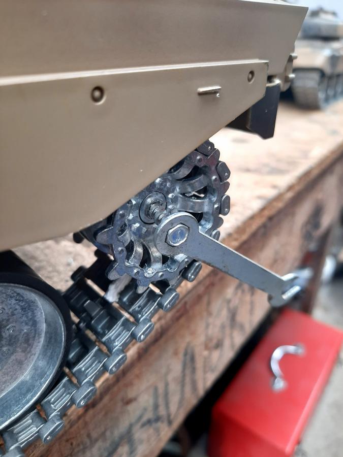

            Well, I tried the penetrating oil, left it overnight and no luck, so out with the big guns, drilled the hub, put a self tapping screw in, prayed and started turning, success, word of wisdom to others, don't put the metal hub cover on the drive sprockets Click image for larger version

              Sometimes you just have to go “cave man” ....LoL. Why I leave all my sprocket screws exposed.
