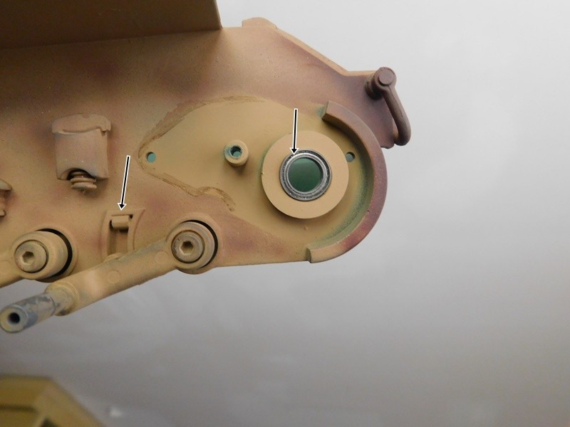

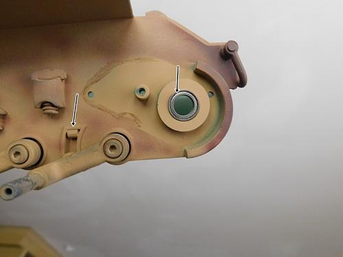

            If you want to go full road wheels and metal tracks. Made bearing support and stopper for front and rear road wheel. https://www.youtube.com/watch?v=sLzedhFCfLw&t=115s
            Click image for larger version  Name:	DSCN0761.JPG Views:	0 Size:	60.2 KB ID:	287836
