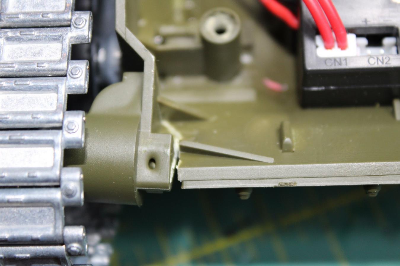

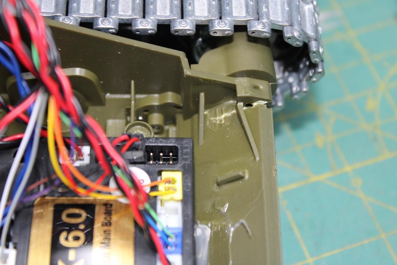

          The clicking when the turret is turning is caused by something catching and binding. The T72 has a ton of wires crammed into a rather tight space and it is easy for them to catch as they move around inside the hull. The 360 rings are not full proof and do have a number of random issues from time to time.
          The forward lower hull cracks are common and happen often because of the weak design. Usually though they happen on tanks that are run hard outdoors and take some time to develop. Seeing them on a new tank or “indoor” tank is more rare.
          There are a few fixes that strengthen the forward hull section and solve the cracking issues. Some easier and cheaper then others.
          Adding epoxy alone will not solve the problem. The material used in HL hulls does not allow epoxy to bond well to it especially in high stress or areas of high torque loads. The cracking areas are both. I used two steel wire bracings running along the outer hull anchored at two points through the hull to address the stress issues then imbedded them in epoxy to further strengthen them and “tie both together” The epoxy and steel wires act kinda like cement and rebar.
          This method is cheap, easy and fast, yet highly effective! Trust me I beat the living SH*T out of my T72s and after doing the above fix have had no further cracking issues. Oh and even with the side skirts off on my tanks no one has noticed the reinforcement because they are painted over and largely hidden behind the idlers and #1 road wheels. With the side skirts on it is not be possible to see the reinforcement.

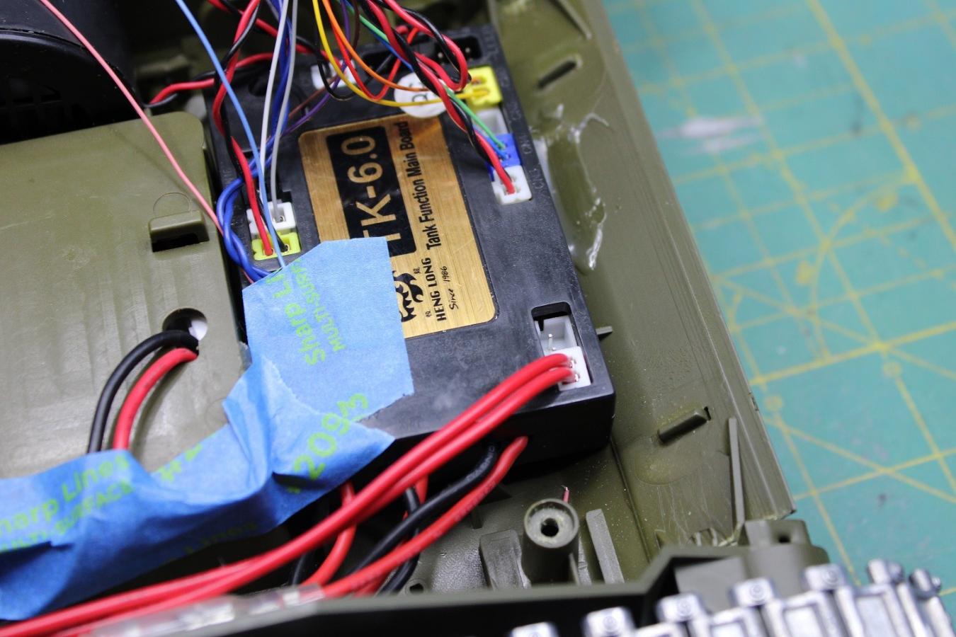

                        There are 2 CN10 slots. One on the MFU with the connectors came off and put back (THIN WIRES). There is a small board with thicker wires. I took the connector from the small board ( THICK WIRES) and plug into the MFU. Now I have BB/recoil function. So what does the connector with THIN wires do? I am asking TH to send me new top ( broken screw lug) and lower hull (cracked) and I will repair. I think it is important that I learn the engineering so I can handle if I am going to be in this hobby for a while. Dai
