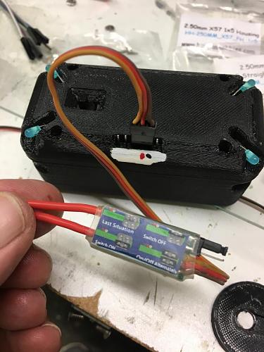

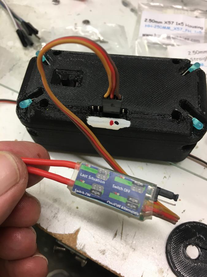

                            I tested mine. It works, but how does it trigger noise from the signal output? I hooked up a turnigy remote on and off to the top of the box and it wouldn't trigger it to go on. I took pictures of my wire hook up Does the this look right? I might try another remote switch but have todig it out of a plane. Click image for larger version

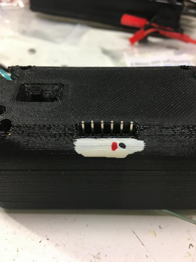

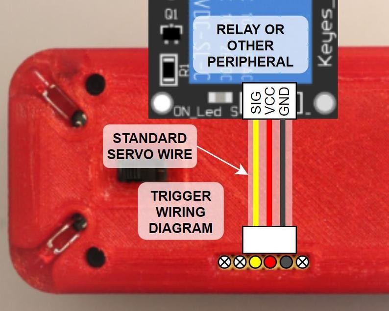

                              I don't understand how this unit is supposed to trigger anything using the pins for outside devices like smoke or sound. I tried measuring the pins with my multi meter and the only pin with power is the second from the left. Which according to the schematic isn't even part of the equation. Nothing comes out the wire pins in the schematic.

                                    yellow line goes to 3.3V when all 5 hits have been registered, when lights are flashing repeatedly. (dead) not on hits 1-4

                                      How can I boost that to 5volts? Change batteries to 2s and put a BEC on it to keep power to 5 volts? Your description in Esty is sort of misleading. It says it will output 5 volts once all hits are registered. Is there a buck booster inside or can be added? Just and FYI my pill box output wires were completely opposite of the schematic. The 3.7 volts will trigger LED but no a receiver switch which I am guessing needs 5 volts.
