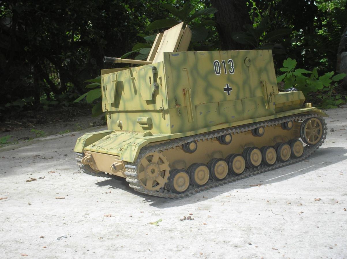

    I'm looking at (lusting after!) one of Vandra's 1/16th modification kits, the Mobelwagen self-propelled anti-aircraft vehicle on the Panzer IV chassis. I ran across this spectacular video from someone in Germany, I believe. A basic mod using a stock MFU would yield the traverse and elevation, but not the sides dropping, the cyclic recoil, muzzle flash and synced sound. It sure looks cool! Anybody gotten their hands on one?

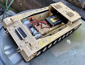

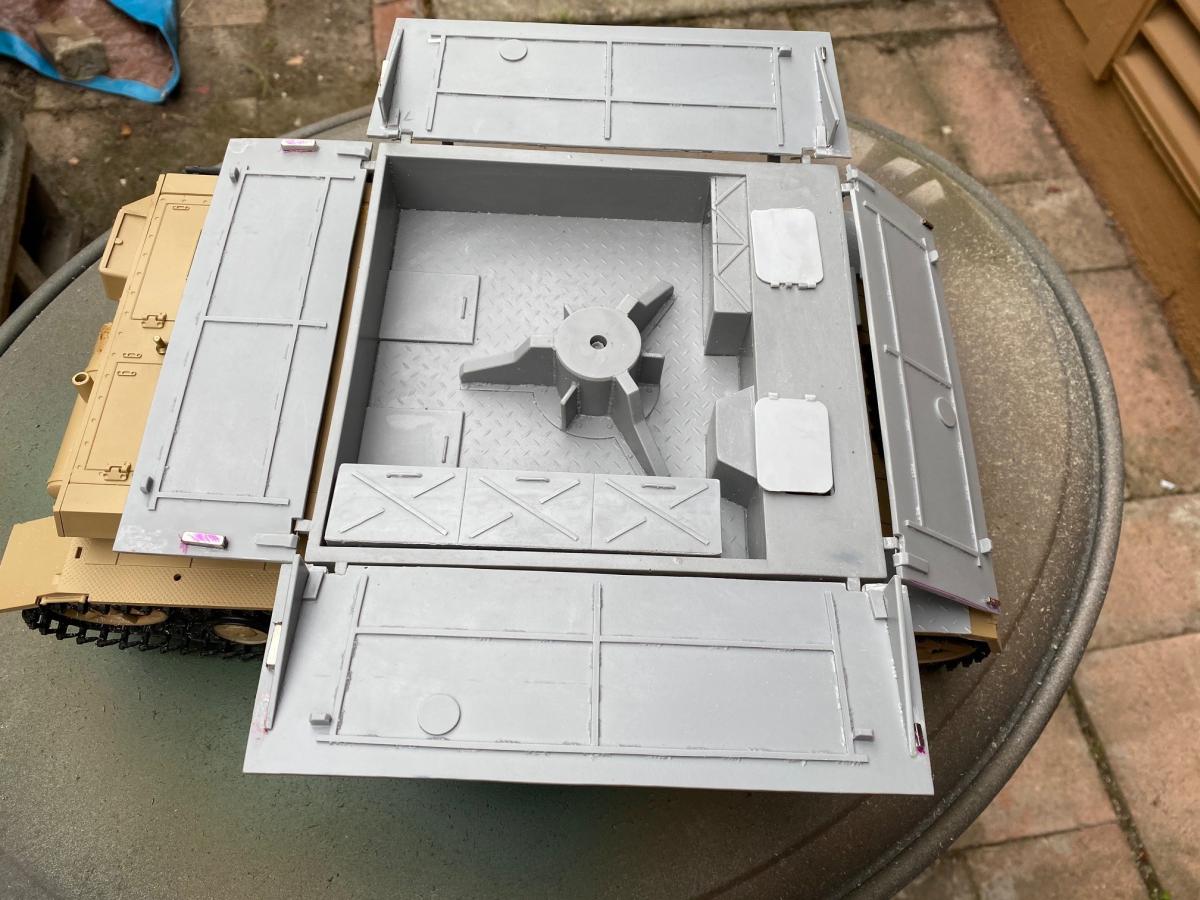

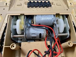

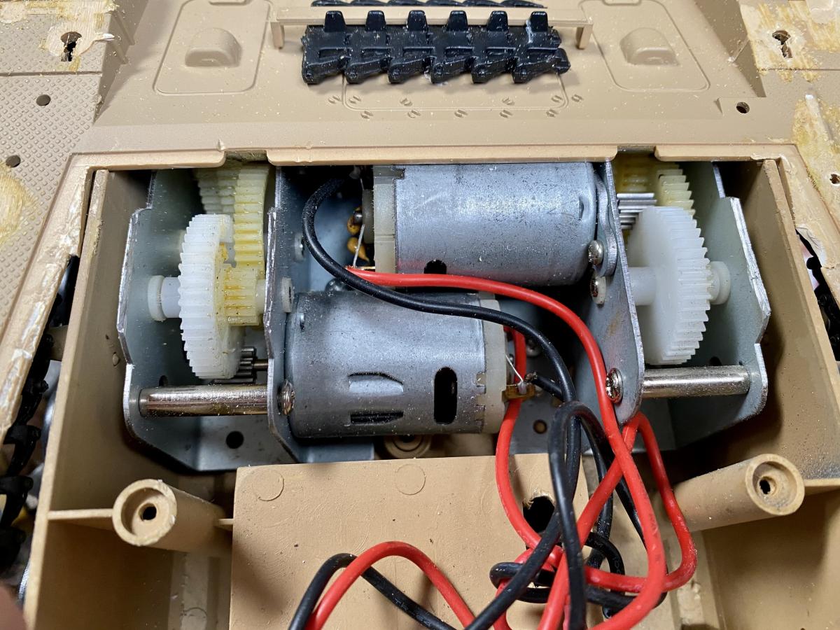

                      I've started construction on this vehicle, as I'm on hiatus externally with the M3 Lee project. I'm blogging both of these so that those contemplating Vandra's conversions will know what they're getting in to. Overall impression: nothing fits out of the box, there's a lot of cutting, filing and fitting involved. I think Vandra may do some of this purposely, as it's better to have too much on a part and be able to remove stuff than to not have enough. You do end up with a unique AFV, and I enjoy the shop work.

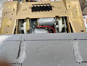

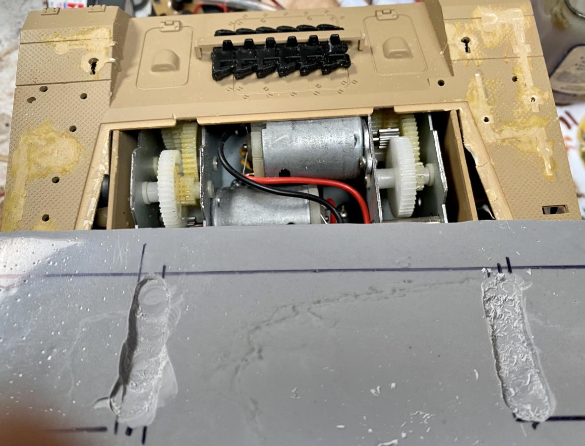

                      So, the first step is to remove the front top deck of the Heng Long Pzkfw IV. Let me tell you, that's one tough mutha! HL's plastic is strong. Cutting discs, circular saws and sanding cylinders on a strong dremel type tool are all needed.

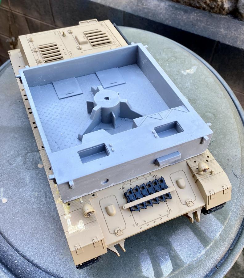

                      This is where the fitting work starts, seating the new deck on the hull:
                      All done? Not so! The new deck is a solid block, whereas the original is hollow. The gearboxes sit slightly higher than the hull.
                      You'll have to trim some off the gearbox frame, and make a recess on the new deck, to ensure the gears themselves don't hit the deck underside. Also, since there is no underside room on the deck, relocation of internal components is necessary. The stock speaker originally sat on the side of the hull, and hit the new deck. I removed the smoker and put the speaker in it's place. I'm using a 6.0 MFU and that didn't fit vertically in the hull either. It now sits on the battery box after I removed some protrusions.
                      I'm also starting the hinge work on the box sides; very fragile, tiny holes need to be drilled. More on that in a later post.
                      Are we having fun yet?

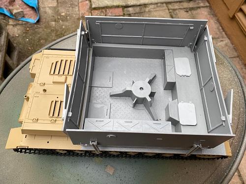

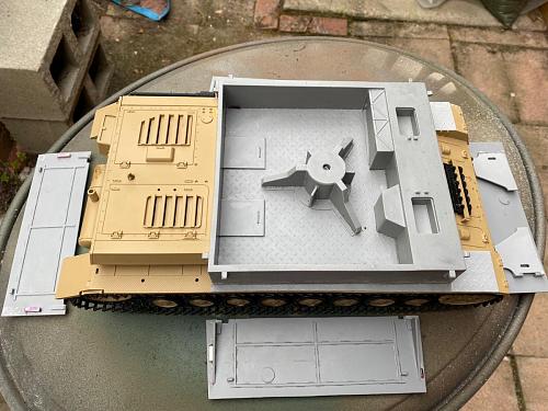

                        Well I think I'm going to end this project. It's a lot of work for not enough result. This post is for the benefit of anyone contemplating this conversion.
                        I encountered a number of issues, all of which could have been overcome. However, without major effort I would have ended up with an AFV that would sit on a shelf as a motorized display model. First, the issues: My previous post described the modifications necessary to place the superstructure. Once it was in place, there would be little to no room for mechanisms to have the gun articulate or function in any other way. Also, the resin castings do not lend themselves to the precision needed to have the sides hinge well.

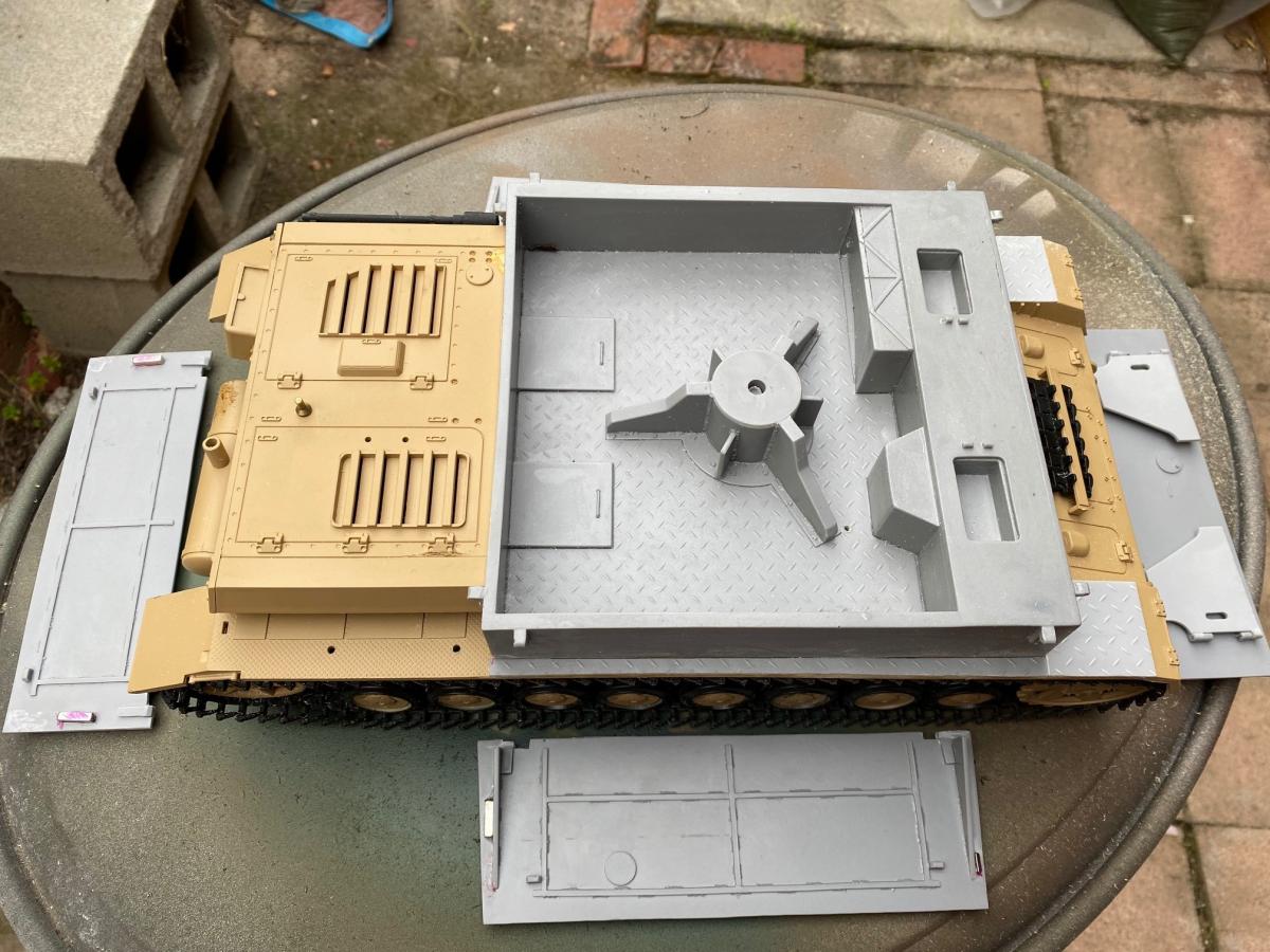

                        Here is the body ready for the box sides.
                        Sides attached. Note the tiny magnets I placed to hold the sides together when folded up.

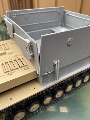

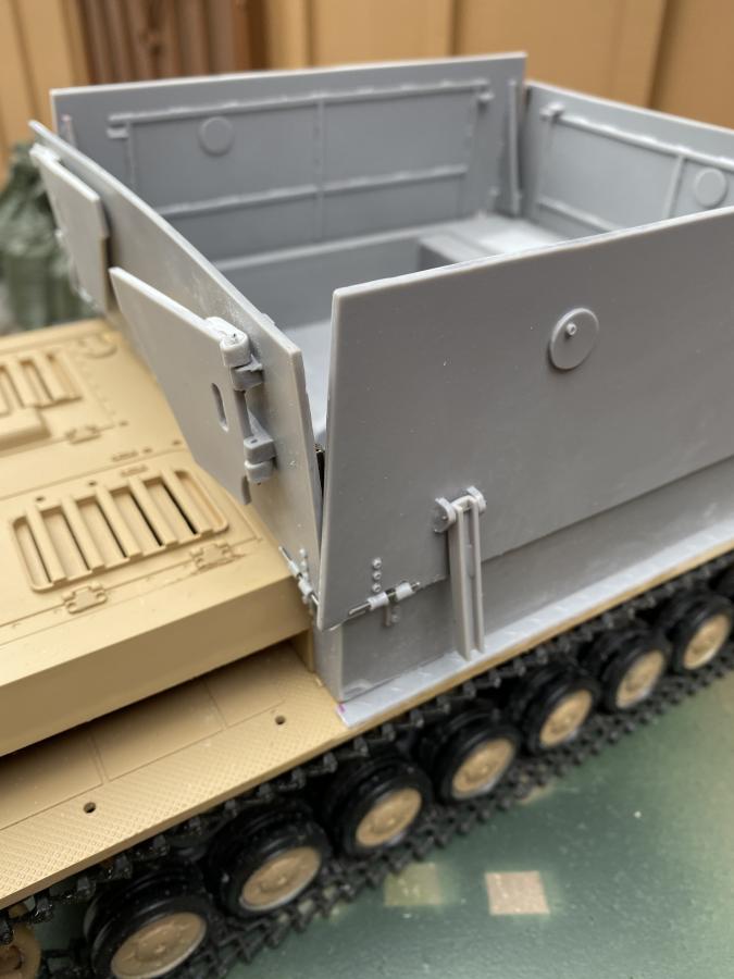

                        Sides folded up. here's where the problems arise. Notice that the sides don't match up. One piece will line up out of one adjoining piece, but inside the other adjoining piece. Some is warpage, but some is the hinge work.

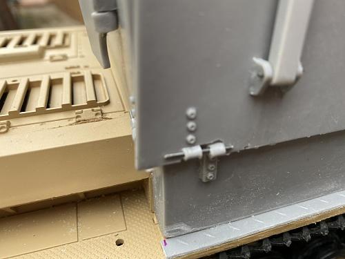

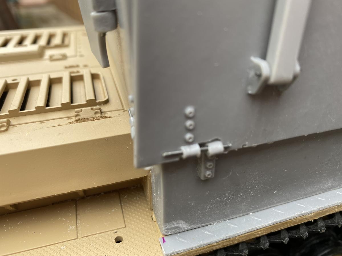

                        To articulate the hinges, holes need to be drilled with a 1mm bit. You can see that it's difficult to access the needed points and drill a straight hole.
                        Also, the hinges don't line up at all, so filing is necessary. There are dimples where the holes should be drilled, but look at the upper left hinge. That's after a bunch of filing and it still stands proud. And notice the gap in the side hinge.
                        I did not break any of the resin, it's pretty strong, but I doubt it would hold up in outdoor exercises. Finally, I'd have had to find a way to mount an IR receiver, and alter the gun for an IR emitter, and place traverse and elevation servos on the gun, which meant a Clark board & a compatible transmitter.
                        Fortunately, all is not a total loss. Vandra makes a StuG IV conversion. More conventional - room inside for mechanics, amenable to IR battling. I can migrate the chassis to that project.

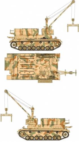

                                That's what I would have done, but that's where the speaker and 6.0 MFU had to be relocated! All of these ideas COULD be done, but then again, it wouldn't be something I would use on a battlefield, and that's my focus. Good thinking, though.
                                I guess I could make it into a "munitionschlepper" (sp?)

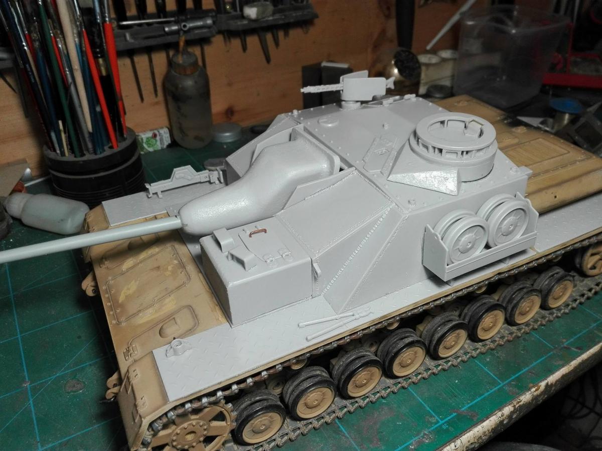

                                However, the body will be recycled as a Sturmgeschutz IV. Vandra's photo, not mine.
