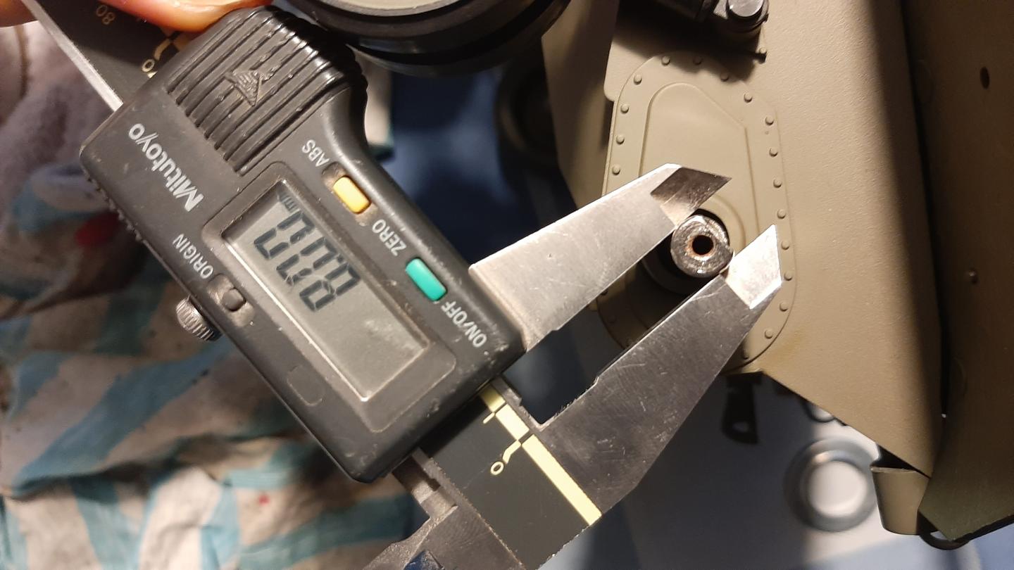

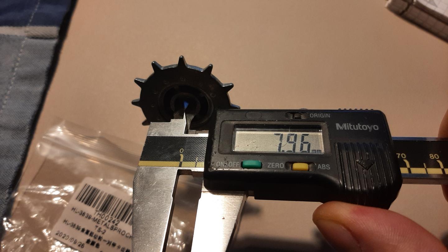

      The difference at .04 mm seems really marginal. Isn't there metal flash getting in the way on the inside of the sprocket?

        Well 0.05mm is enough to make things really hard to push in. So instead of a slide fit it becomes a press fit.
        Honestly I was a little surprised by the bad initial fit. I'd expected it would slide right on, especially for that price.
        Ah well, I scraped some metal off the hole on the sprocket to make it fit. After all the part doesn't fit. The axle isn't the issue.
        BTW I wouldn't recommend sanding down the axle. If HL gave it a surface finish you just sanded it off.
