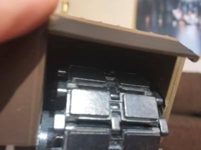

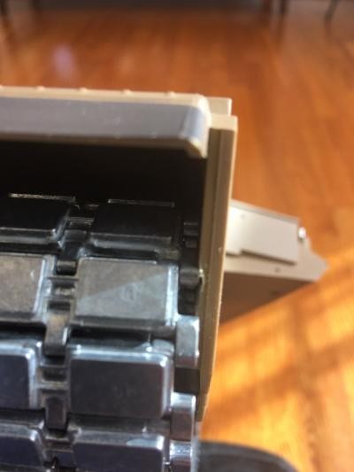

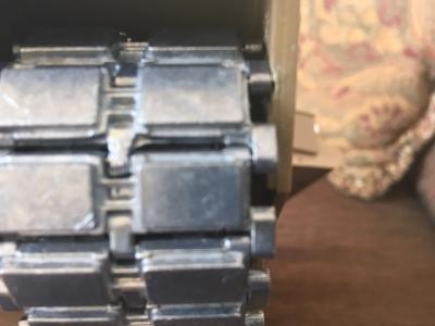

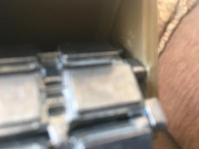

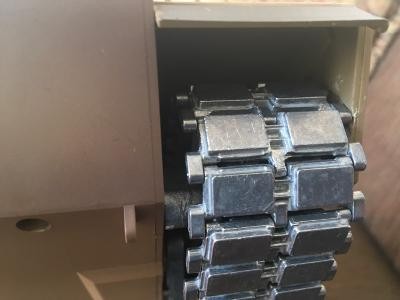

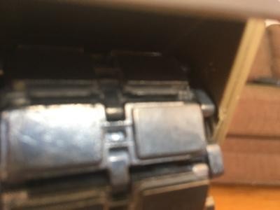

    Got my 1st tank this month. After about 15 minutes, I noticed that the tank wasn't driving as expected. Its metal tracks were scrapping against the armored skirt of the HL M1A2 Abrams.
    Emailed seller. They said it was within the manufacturer's specs. My continued use will certainly cause more damage and possibly affect the life of the tank.
    My thoughts were either to return the item within the 30 days or request other compensation (Rubber track replacements, paint to conceal the pending damage, or other appropriate compensation)
    Any and all input would greatly be appreciated.
    Originally posted by HardRock View Post
    Help needed.
    It is totally normal wear and will not hurt the tank or track. It will wear away a small grove on both sides and then stop once worn down enough for the track to have room to move side to side inside the idler wheel track guide groove as the tank turns.
    These are NOT precision tanks so rubbing and wear is rather common on most Heng Long tanks. Heck even the $1000+ Tamiya tanks have similar wear tendencies.
    Hope this help put you at ease.
    On another note your Abrams has Leopard 2 metal tracks. Not that this in anyway is contributing to the issues as the Abrams and Leopard can run each other’s track type, it’s just an observation.
