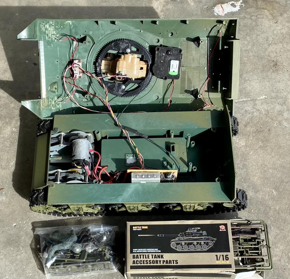

    I am in some very early stages of gathering resources for a Vandra M3 Lee modification of a Heng Long Sherman. Not having experience with this type of mod, I want to keep the costs at a frugal level to start with. With that in mind, I was intrigued with the eBay offers of "HL static tanks, no r/c, for collectors only" by Toucan and their affiliates. So I ordered one. I haggled it down to $78 including shipping. Here's a first impression of what I found:
    The kit includes the shell and plastic wheels and tracks. Inside are metal gearboxes with zinc (gray metallic, non-magnetic) gears. The motors look like generic 380 size. The motors are hard-wired to an old generation 27mhz main board, which I believe includes a receiver, given the antenna wire that snakes up into the turret. There is NO transmitter! There is a turret traverse setup, motor and ring. There is an Airsoft gun and an elevation motor. LED headlights and taillights. There is a full set of separate accessories, and the ever-present airsoft pellets. No smoke generator. There is an LED bulb in the turret, I believe for the machine gun function.
    There are a number of spots for external switches, one with the on/off switch. This is a mold of the early HL products, as those other spots are for switches no longer used. It does not have any accommodation for IR - no socket for a receiver, no IR bulb in the mantlet.
    So, is it worth it for my purposes? Absolutely! The upper hull will be discarded. I may be able to use the traverse mechanism, or at least parts of it for the Lee turret. I can use the airsoft mechanism for hull gun elevation. I'll be eliminating the pellets in favor of an IR bulb in the barrel. I have a loose 6.0S main function board graciously donated to me for this project. I guess I could add a smoker, but I don't think so. I don't intend to thrash it, but I expect to be driving it around eventually.
    So now you know. If these static kits meet your needs for modifications, or just want the body and some guts, it's there for you.

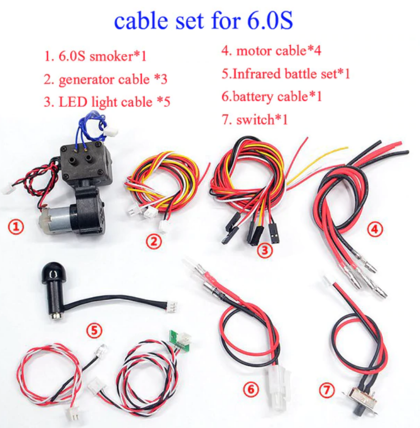

                                You’ll need the board of course, but this along with it. eBay search or ask Toucan for it, using that term. The cables are the same for any of the v6 boards. Credit to Karltrek for showing me this.

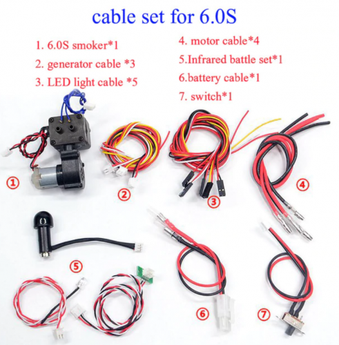

                                  #17
                                  I found a similar set on ebay. It does not include # 1) 6.0S smoker, 2) generator cable (?), or the IR mushroom.
                                  I am not too concerned with the smoker unit or the IR mushroom right now.
                                  Do you know what the "generator cable" is used for? Probably for the turret?
                                  • SoCalBobS
                                    • 2754
                                    • Southern California
                                    #18
                                    I'm guessing it's for the smoke blower motor. Depending on price, sounds like a deal if you don't want smoke. Also, if you intend to play IR at a later date, you'd probably be upgrading from the stock apple anyway. If you can, let me know who's selling it on eBay. That kind of info is always a good resource.
