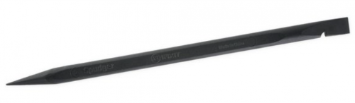

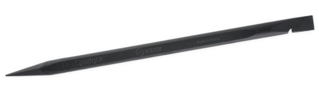

        It's not threaded. You need to get leverage under the plastic rim. Be careful not to damage the plastic.
        I use a nylon spudger tool for mine. You can buy these super cheap from places like eBay, Amazon, Aliexpress, local phone-repair shops, etc.

          For most HL tanks, there is a tiny notch in the hubs. A pry tool, like UV recommended or any pointy object will pop it out. They're not glued, just press fitted.
