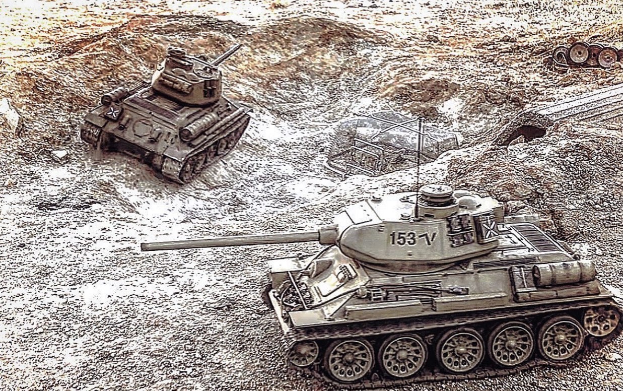

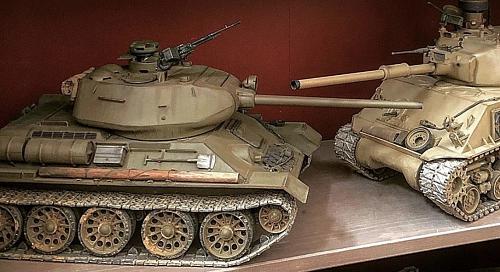

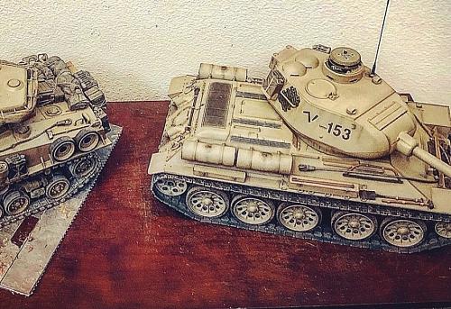

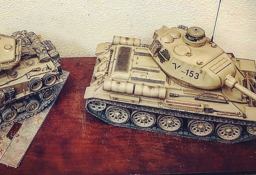

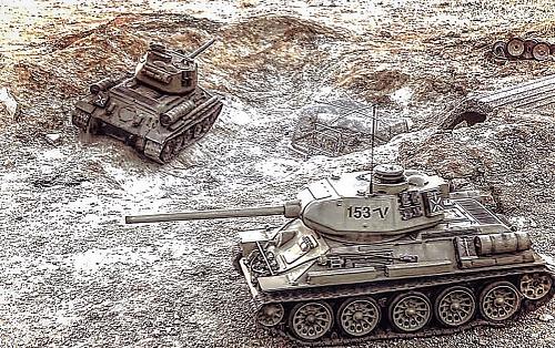

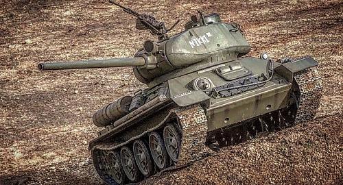

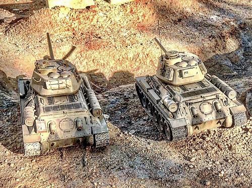

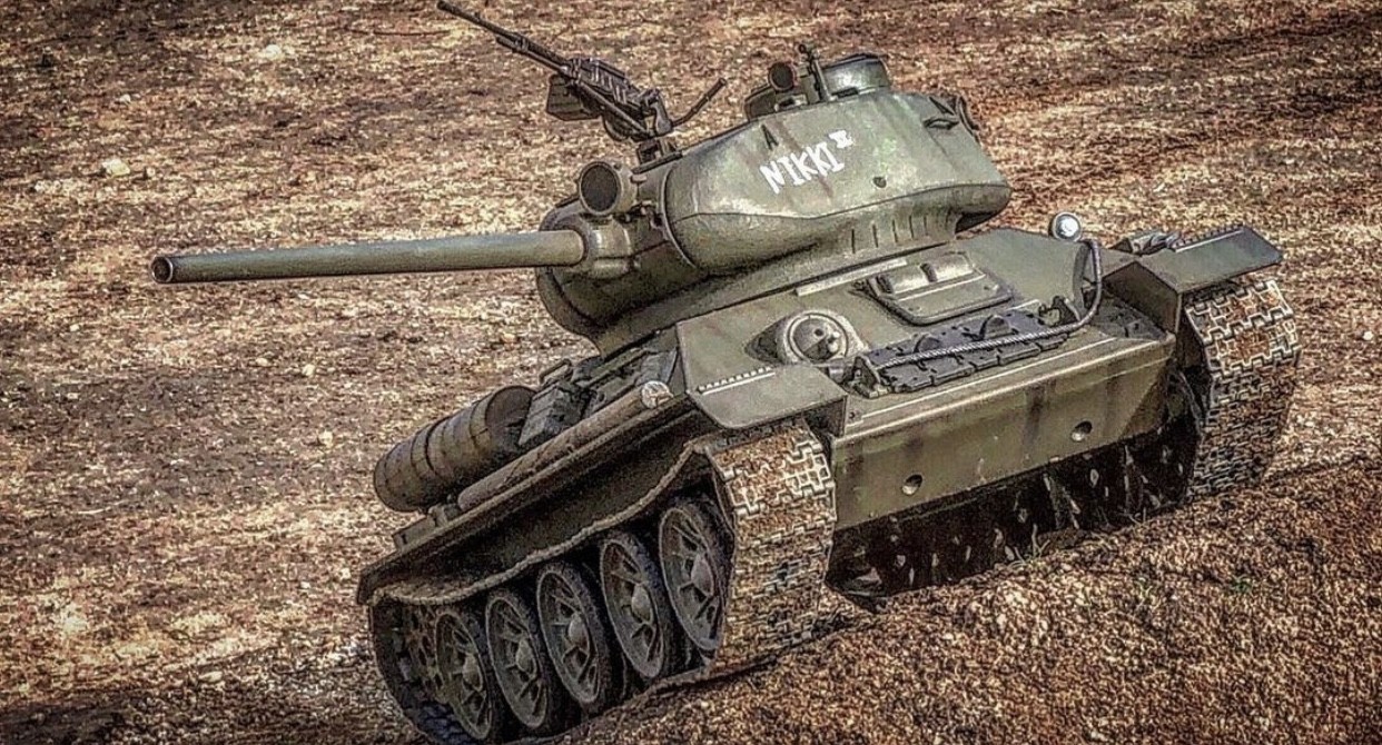

      Out of all the tanks you mention and given what you indicate you wish to do with your tank I highly recommend the T34-85.
      By far the T34-85 is the single best all around performing HL tank for hard outdoor use. It has no vices, is extremely reliable and with some paint and weathering can be turned into an excellent looking tank. It also is one of those few tanks that service life spans two eras from WWII through the middle of the Cold War.
      The HL Sherman and Panther G are also decent tanks. The Panther G is a rather large tank about the size of a “modern” tank so be aware of this.
      Here are a few photos of two of my T34-85s. I use these as loaner tank at IR tank battle events. One is a typical European green and the other is a desert tan (1960-72 Arab).
      Click image for larger version  Name:	BFF59AF1-C93F-4A07-88B6-9EAD9824AFBF.jpeg Views:	0 Size:	225.6 KB ID:	301906 1960-1972 desert tan used during the Arab Israel wars. To left just off screen is an IDF M51 (M4 with HVSS and 105mm gun)
      Click image for larger version  Name:	9855CD95-DD9B-429C-9A72-97E8D2BCA6DF.jpeg Views:	0 Size:	194.2 KB ID:	301907 European green, 1950-60 theme with heavy MG and search light. Off to right is an IDF M51 with 105mm gun.
      Click image for larger version  Name:	573D9854-92B6-446C-9E1E-692696C79EAC.jpeg Views:	0 Size:	507.0 KB ID:	301900Click image for larger version  Name:	6326B0FA-46A7-43AD-9FCF-2D961886C59F.jpeg Views:	0 Size:	285.6 KB ID:	301903Click image for larger version  Name:	FAD18FA2-AF1C-4F95-9327-710C3C623141.jpeg Views:	0 Size:	365.7 KB ID:	301901Click image for larger version  Name:	FDB4A695-0127-49B0-BC6C-23F2F9E794F2.jpeg Views:	0 Size:	214.6 KB ID:	301902

        ​​​​​​​Lastly, I don't know if you are deliberately taunting me with those beautiful Israeli Shermans or not. I also saw the Merkava IV, but I'm not looking to invest at that level.

            Yes the IDF M51 (M4) was a friendly tease.....
