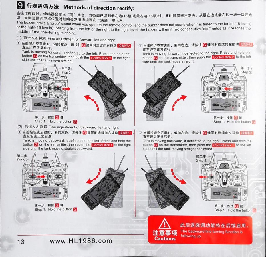

    Hello new member here. I want to know how to overcome trim error on forward traction Heng Long tank. The transmitter only has fake trim levers. has anyone overcome this problem, thanks

      Rubicon99 thanks for the reply I have read through the manual V7, I received with the tank and I am unable to find any reference to adjusting trim, as the tank tends to drive to the left. Unless it is mentioned in a wording that is misleading me. Could you elaborate. thanks

        Should be press “G” and at the same time move stick left or right as needed to adjust trim.

          Here's the page in question, from the manual for V6.0 and V6.1 Might be the same thing tho.
          Click image for larger version  Name:	WhatsApp Image 2021-06-30 at 18.48.04.jpeg Views:	0 Size:	164.5 KB ID:	317221

            Thanks for that my manual say's something different but with your help it now makes sense. Thanks very much for your help.
