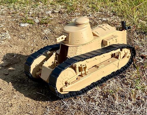

    Renault FT

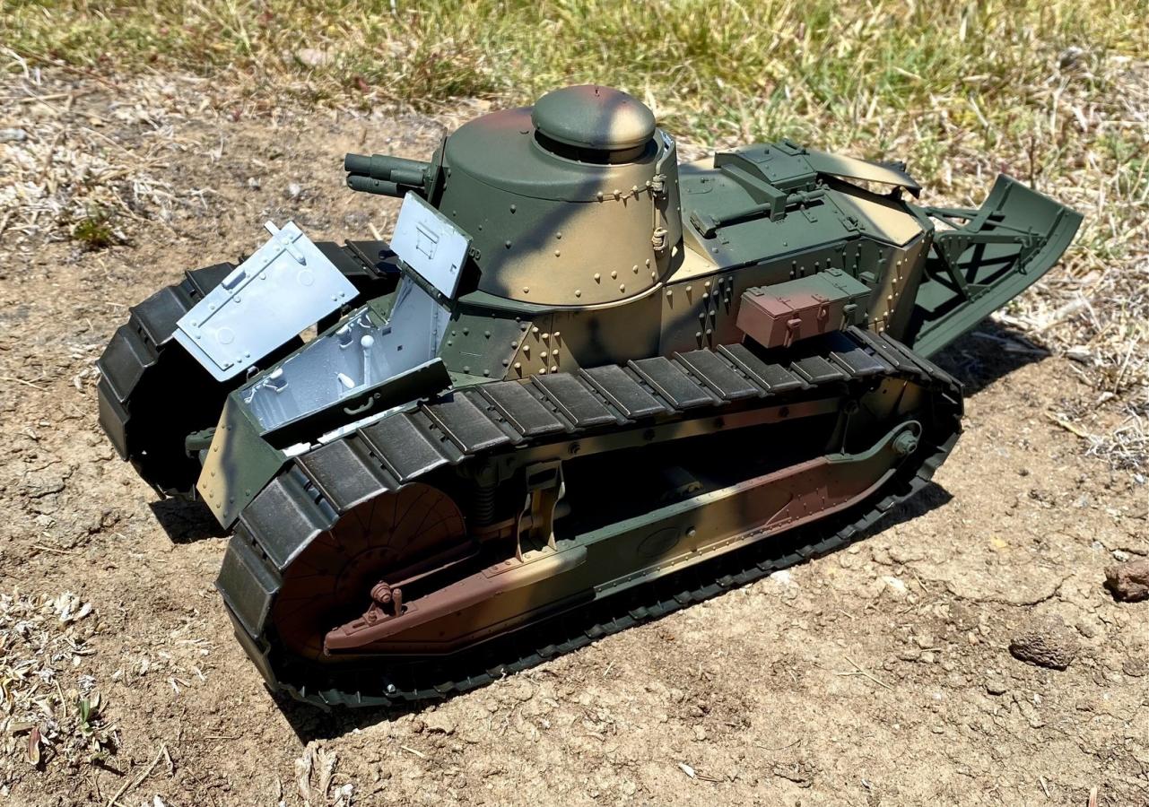

    Just a teaser for now.
    I'm motorizing and r/c'ing Takom's 1:16 Renault FT. This photo is at the stage where motorizing and r/c'ing is complete. After this, treads come off and detailing, painting and weathering will commence. Given the equipment I've had to work with, It's faster than the real one would be, but hey, it runs!
    So far I've had mixed results. I use the transmission, main board, radio controller, and sound and lights from Heng Long's 1:30 M4 Sherman as appropriate for my conversions. It's the right size, and my LHS can get them for $50. Unfortunately in this case the mechanism for turret rotation won't fit in the hull, it's too narrow. Making lemonade as the saying goes, this will be a hybrid - part r/c model, part display. The kit comes with a complete interior, crew and engine compartments. I've filled the engine compartment with the motors, main board, speaker and battery. That's all fine. The crew compartment and turret is where the rotation mechanism would have gone, so instead I'll do the crew interior!

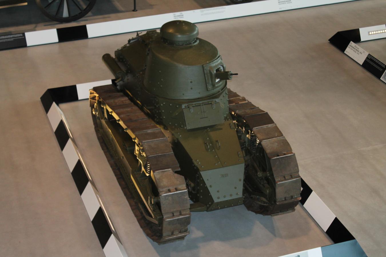

    Ooooh, nice one. I saw one of those just this week. The real thing, not the model. It's tiny!
    Click image for larger version  Name:	IMG_0303.JPG Views:	0 Size:	91.8 KB ID:	319043

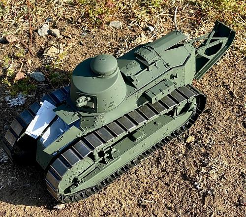

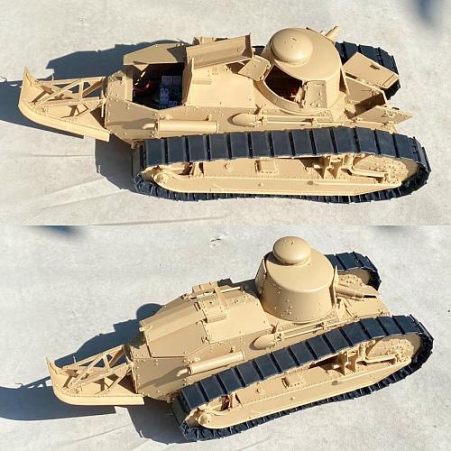

              Hatches open, hatches closed! Just finished hingeing them. Electronics are partially visible in back. The whole top deck comes off. It’s held on by magnets.

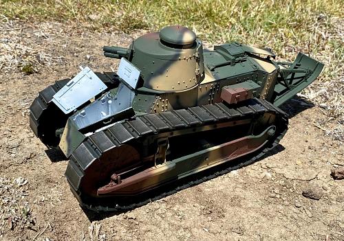

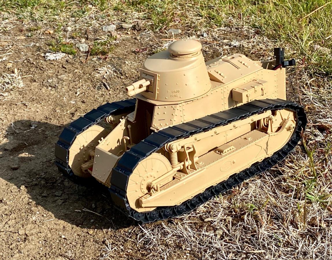

                  Second stage teaser. I'm a novice with an airbrush, as much paint on me as on the kit, so painting the inside white and outside it's base color was stressful. And this was the first time I sprayed it black as a primer. Eek!
                  The tracks have three layers of color on them - Nato Black spray can, AK Track Wash and AK rub-on Iron. Still needs grime and rust, but it's a good start. My wife unprompted said it looked like metal.

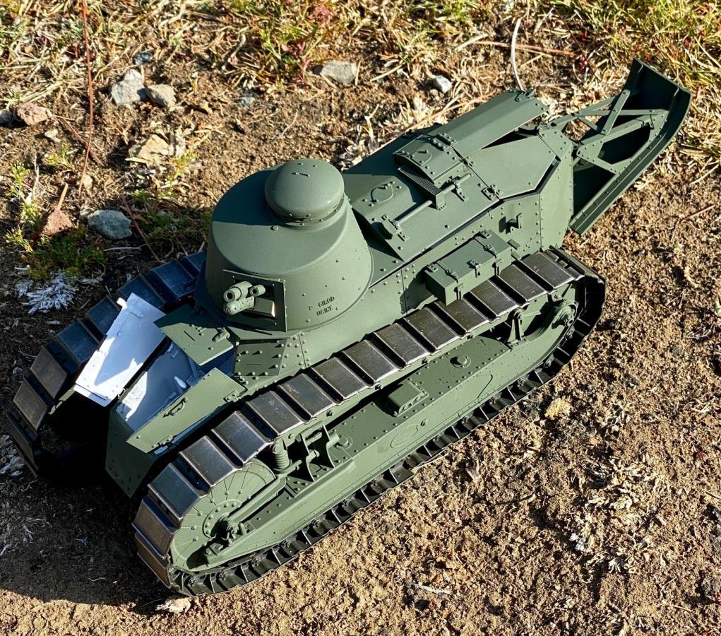

                    In for a penny, in for a pound. The airbrush was already warmed up.

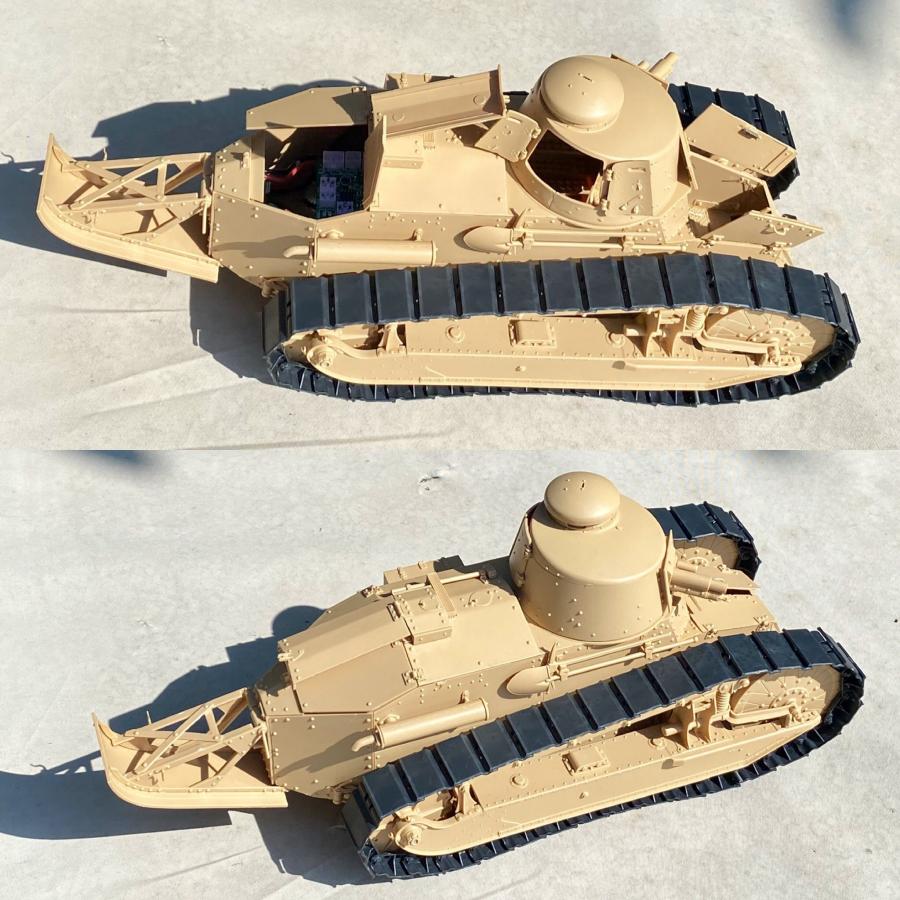

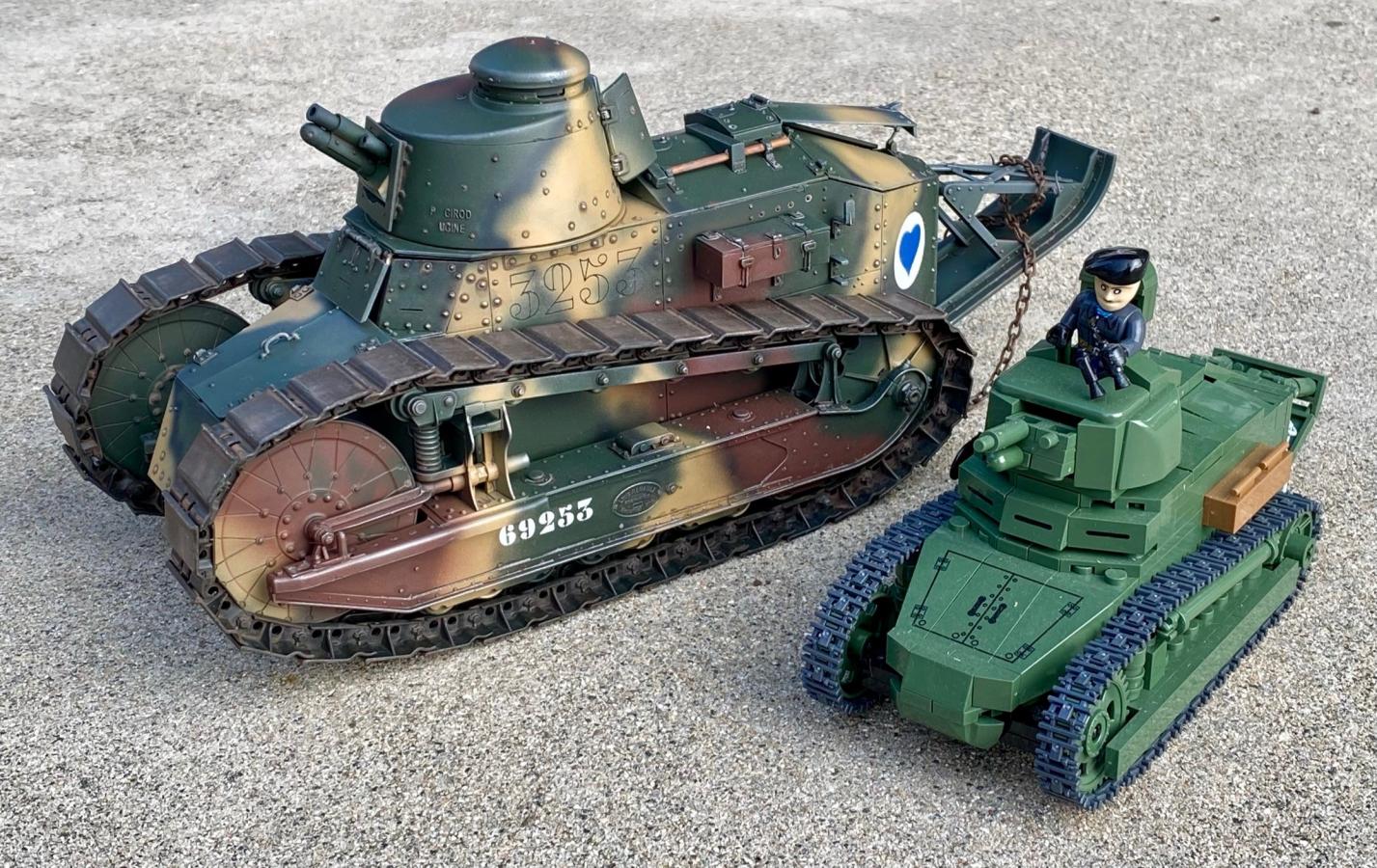

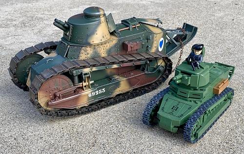

                                  #17
                                  Rennie had a visit from his son. 🤪

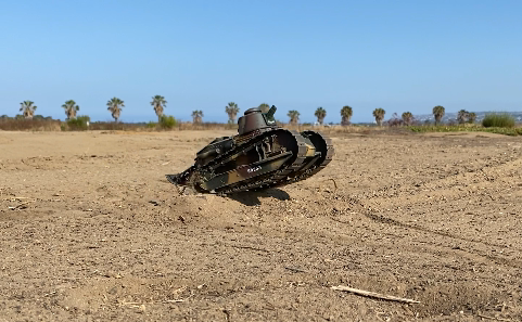

                                    #18

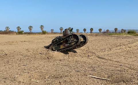

                                    L'avion Renault:
                                    Click image for larger version  Name:	Snapshot_2 (2).jpg Views:	0 Size:	269.6 KB ID:	321432
                                    Bet you didn't think an FT could jump! Well, more a flop than a jump.This is a snapshot capture from a video clip. It's on Youtube. The tank did NOT like the soft dirt it was in, so the clip is real short.
