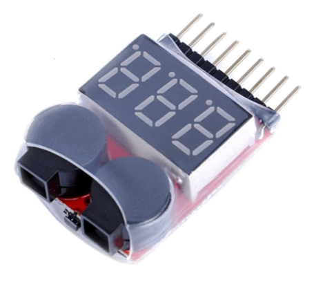

          • Rob1970
            Grumpy Old Dutchman
            • Jun 2021
            • 278
            Get one of these. Thank me later.
Name:	Opera Momentopname_2021-08-01_110810_www.aliexpress.com.png
              TTFN,
              Rob
              Rob,
              This may be of no use to OP, Torro's are shipped w/ NiMH using Tami plugs. OTOH, the gadget is a cheap life-saver for Li-xx.
