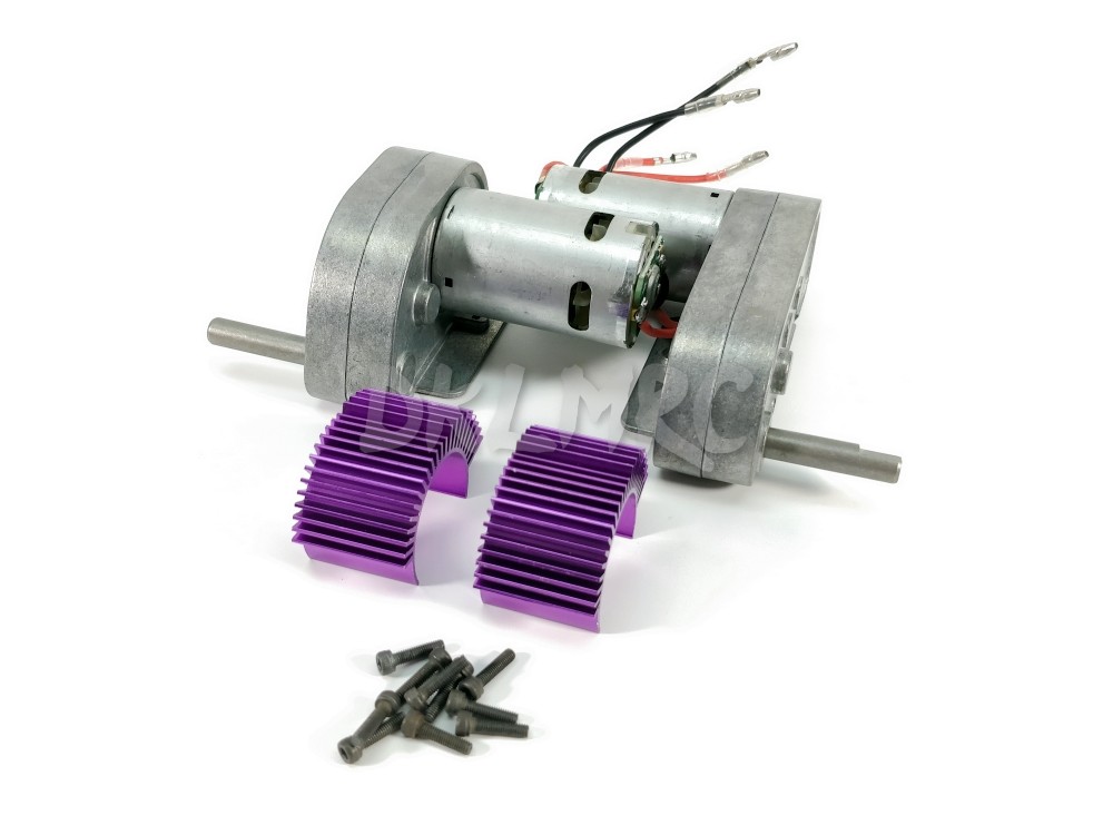

Am looking for replacement gearbox for my Taigen Leo 2 currently using the stock 4:1 - (90:1 ratio) using stock v3 MFU. Has anyone tried with success using the 550 like this? https://www.dklmrc.com/Dual_550_motor_4_1_steel_gearbox_for_116_Leopard_2 A6/p2389473_14664952.aspx

Rubicon99 Would you mind elaborating why the 550's (in the 1st post) won't work. Dominique from RCtank.de also indicated loss of torque with the 3:1, and that the new 7:1 (v3) won't give me the proper speed for a Leo (i.e. not much better than the stock 4:1). May be I have to change controller...
I have already recommended what to do. As others here can attest I am well know for my modern tanks top end scale speeds and excellent low end handling characteristics.Originally posted by sclui56 View PostRubicon99 Would you mind elaborating why the 550's (in the 1st post) won't work. Dominique from RCtank.de also indicated loss of torque with the 3:1, and that the new 7:1 (v3) won't give me the proper speed for a Leo (i.e. not much better than the stock 4:1). May be I have to change controller...
I have spent the time and money experimenting / learning first hand and making expensive mistakes. If you want scale top end speed and excellent low handling while keeping the complexities down you need 390 motors, 3:1 gearboxes, 9.6volts and one of the control system I mentioned prior. This will drive a modern heavy tank at -45mph scale top speed and provide the low end power needed for excellent off road handling in almost every terrain types.
There are issues and unseen variables in every tank. With modern tanks like the Leopard 2, Abrams and Challenger it is their length and if they are running rubber padded track. The rubber padded tracks have an extremely high coefficient of friction. Add this to a heavy modern tank and this can cause some issues with turning performance on concrete, asphalt, carpet and grass.
Now to answer you question. 550 motors at 7.2 volts under load are only producing roughly the equivalent power of a 390 motors at 9 volts (max RPMs for motors are typically shown for their max voltage rating usually 12v so the RPMs shown are often misleading) So simply changing the battery can greatly increase the performance of the 390 motors and the difference in price for a battery vs expensive new gearbox can be sizable. Next the gearbox is still a low gear ratio. So your net total at 7.2volts is more torque but not really any more speed over what you have now.
Now to run that 550 gearbox above 7.2v you need a control system rated for the voltage and much much higher amp draw. Here again you will need to replace the Taigen/Torro system with either a HL 6.1S or a Clark 80 series. Both these are rates to handle the higher voltage and amp draw of the twin 550 motors. Failing to change out the Taigen system WILL burn it out.

Rubicon & Rich, the 3:1 v2 boxes came in, only 2 of the mounting holes line up with the 3 on the Leo, so I had to add the 3rd hole, swapped over the 390's from the v2 4:1 originally boxes, pulled out the pinion gears a bit to line up with the 3:1 input gear, and I am happy with the speed improvement using Taigen's v3 MFU & 7.4v Li-ion, so I know I would be disappointed with the more expensive v3 boxes. Low-speed driveability is fine since I can modulate just like before with my own Tx.
