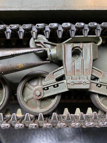

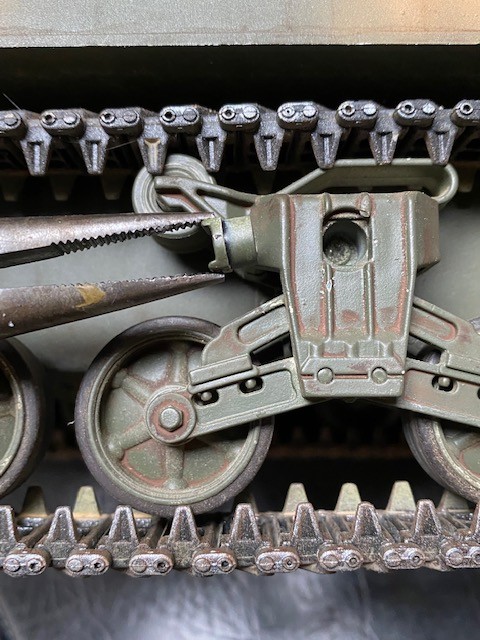

          Use a pair of pliers and twist and wiggle. Be ready to touch up the paint after, though!
            Thank you Bob!
            I'll give it a try, if it looks like I'm gonna muck'em up too bad I'll leave'em be..
            nice weather/grime job!
