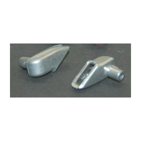

    Check this video, around the 45 second mark; . I'm going to do the same to my KV-1. For the exhausts you can try to drill out the plastic ones, or get a set of metal upgrades. That's what I did anyway.
    KV-1 - exhaust, made of metal Delivery: 2x exhaust This exhaust can be fitted directly to the smoke unit!

        https://www.rctank.de/KV-1-exhaust-made-of-metal-2-pcs
        Thanks for the info, Rob 1970 I ordered a set of those metal exhausts from that website. probably will take a while to get here. Where can I get the connectors and other fittings for the tubing ? Is that ordinary aquarium tubing stuff, or something special ?
