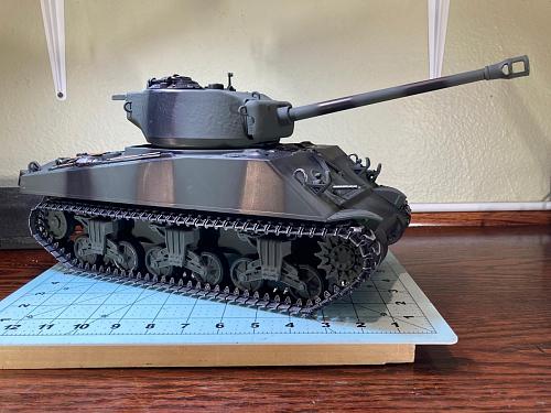

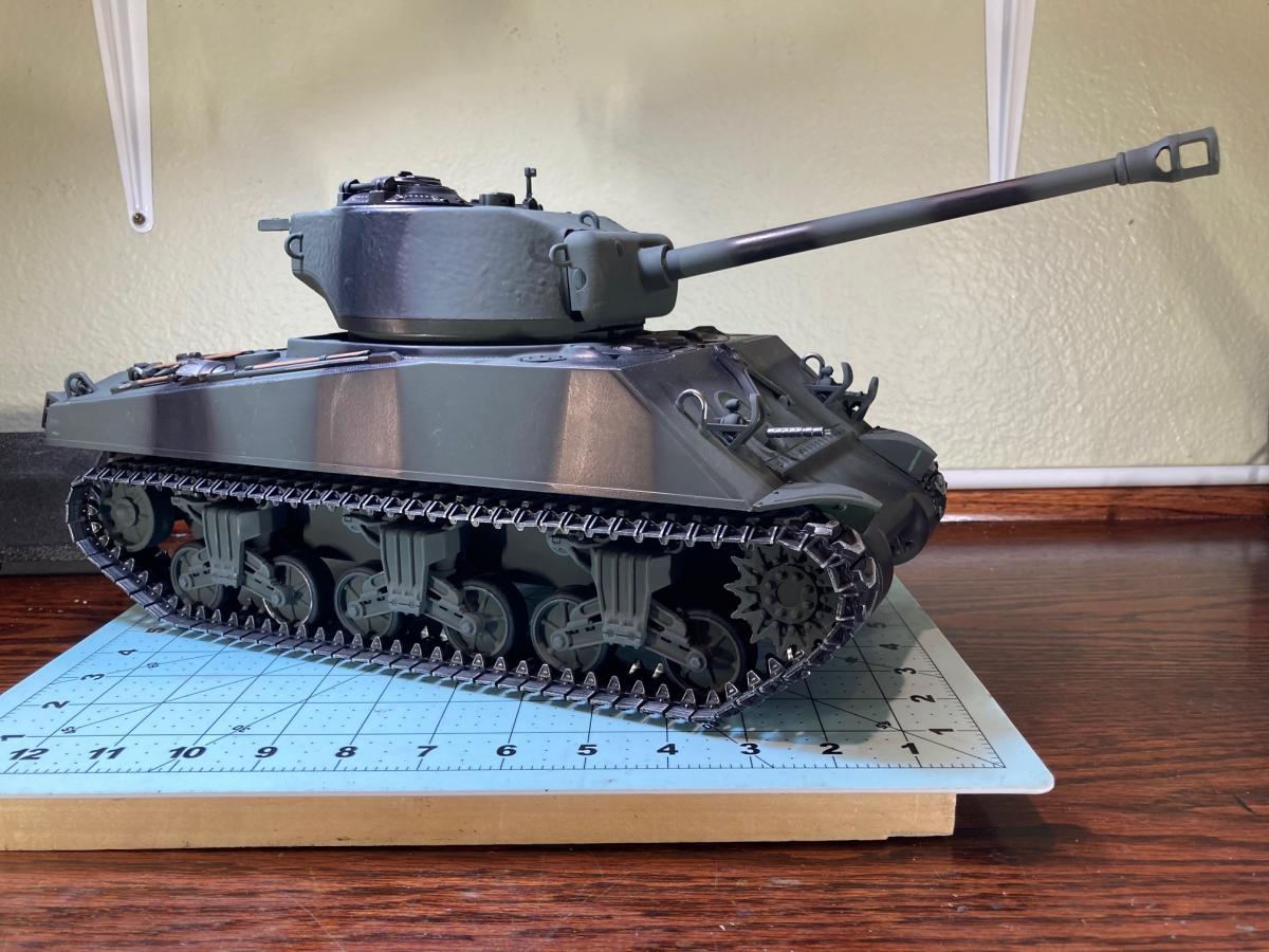

                            I have just received mine on Friday. I am not sure about the glossy black stripes that Taigen painted on this tank. Does anyone have a color picture of this tank that he can share? I would like to repaint it. Thank you!

                                  [SIZE=14px]I have just received mine on Friday. I am not sure about the glossy black stripes that Taigen painted on this tank. Does anyone have a color picture of this tank that he can share? I would like to repaint it. Thank you!
                                  David, I am so glad you found the shimmering black questionable. I can't understand the reasoning behind that!

                                    I can’t help with a good reference image but the gloss black is an odd choice for sure! I’ll probably coat mine with Mr.Hobby Clear Flat top coat after I do some weathering and that should dull it down and even everything out
