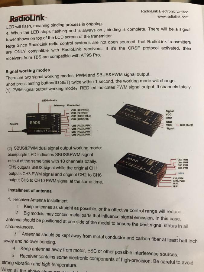

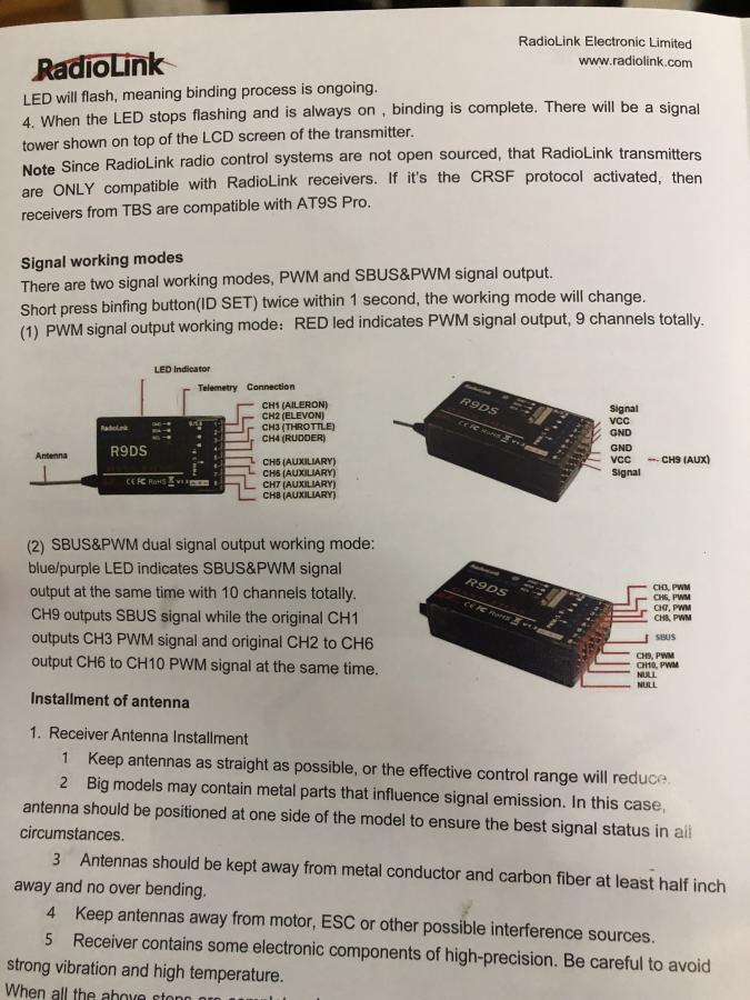

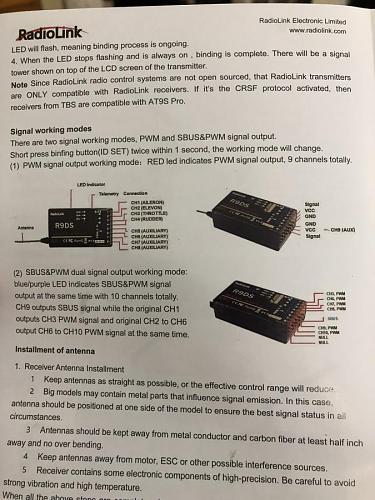

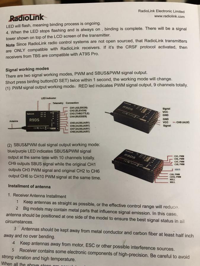

    So I’ve just received my Torro/Taigen Sherman and I’m really happy with it overall- looks fantastic and works perfectly with the stock transmitter. However, I tried to set it up with my Radiolink AT9s Pro and I can’t get anything working for some reason. Hoping someone here may be able to help. The tank has the Taigen V3 board. I followed Taigen’s instructions, plugged in the “transmitter selection plug” and then plugged the channel leads into the ports on my receiver. I’m using the R9DS receiver that came with the transmitter. I know the RX has to be in PWM mode to work with the V3 so I had that sorted as well. Channels all look like they’re working as they should on the TX itself. It does say the output protocol is PPM so I’m not sure if that’s an issue even though the receiver is in PWM mode? The TX only has PPM, SBUS and CRSFR as options. What am I missing? Hoping it’s just some noobie mistake since this is my first go with a tank but any direction would be appreciated!
