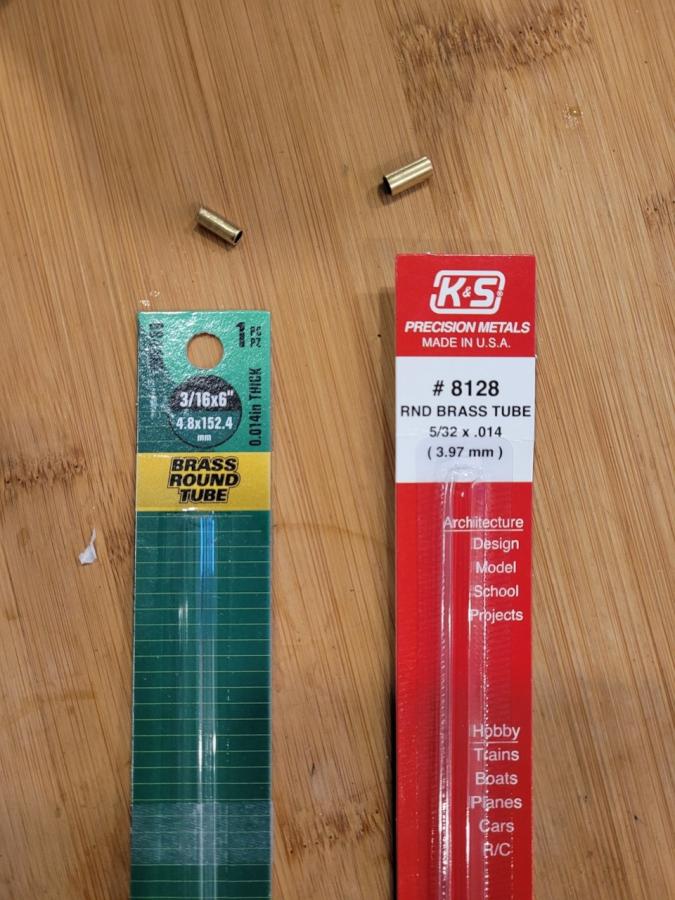

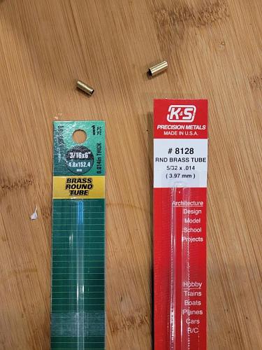

    Spent the afternoon running the M4A3 76 in the grass, only to realize two road wheels came off, found the wheels (screws hanging onto the bogies), but not the brass bushings. BTW, I checked all the wheels and loctite the screws in the last 30 days, not sure why these 2 came off, in fact, one of the bogies was loose, worst yet it's the one block by the gearbox.
    Reached out to Erik but was told the M3 brass bushings are not available as parts, only way is to buy a set of road wheels. To his credit, he did look around for orphan parts in the warehouse to no avail. I ended up with DIY fix using brass tubes, outer 3/16 & inner 5/32 (just right for the M3 screw). This will have to do for now.
    If anyone knows of a source, please tell. TIA.

    I telescoped a few sizes Of brass tube to make them up.
    I had the same problem on one or two tanks. I have a lot of taigen shermans.

      Rich,
      Appreciate the confirm, the mixing of brass tubes works fine so far. I should actually prepare a few more sets just to have some ready. Thanks.

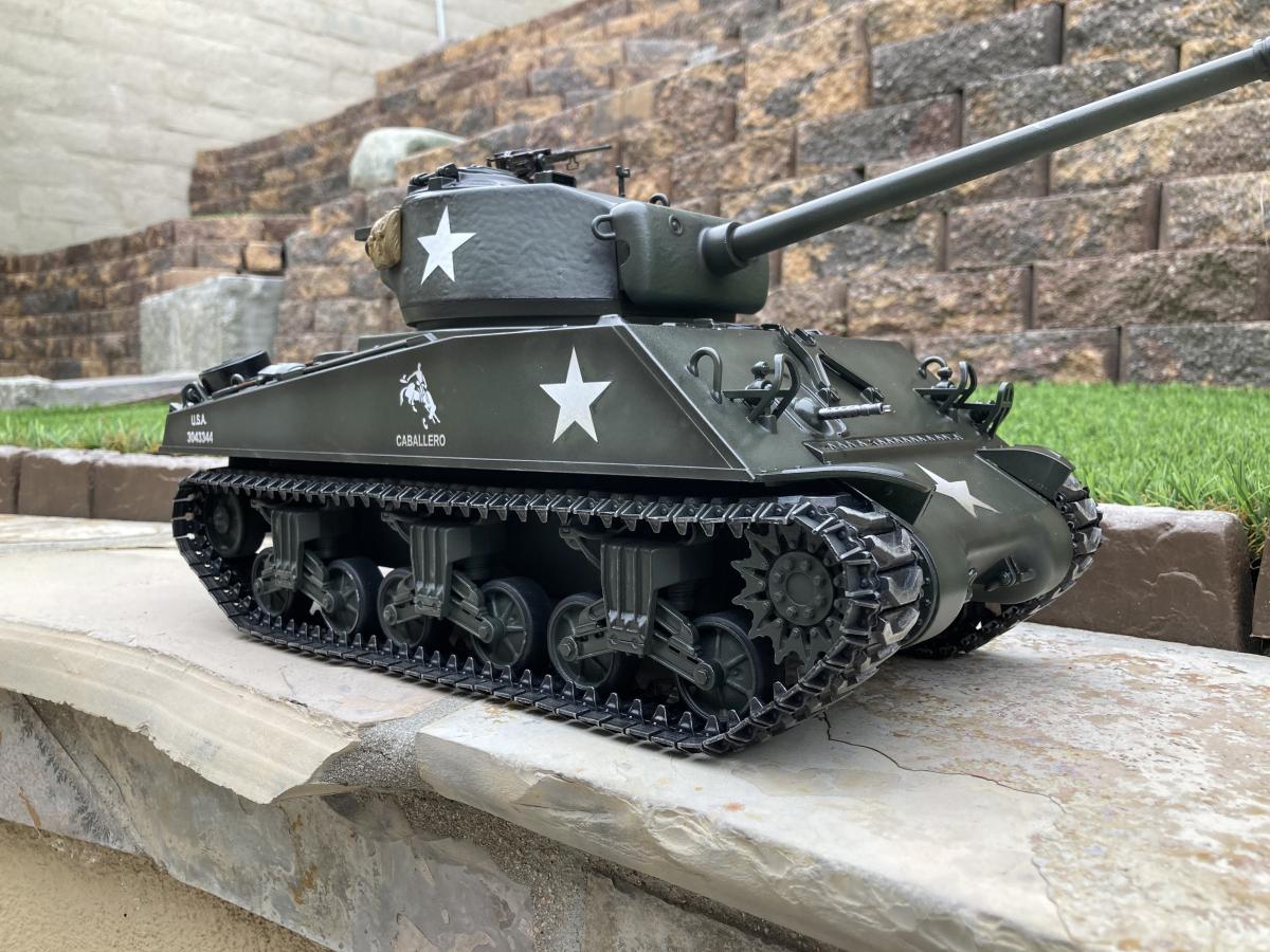

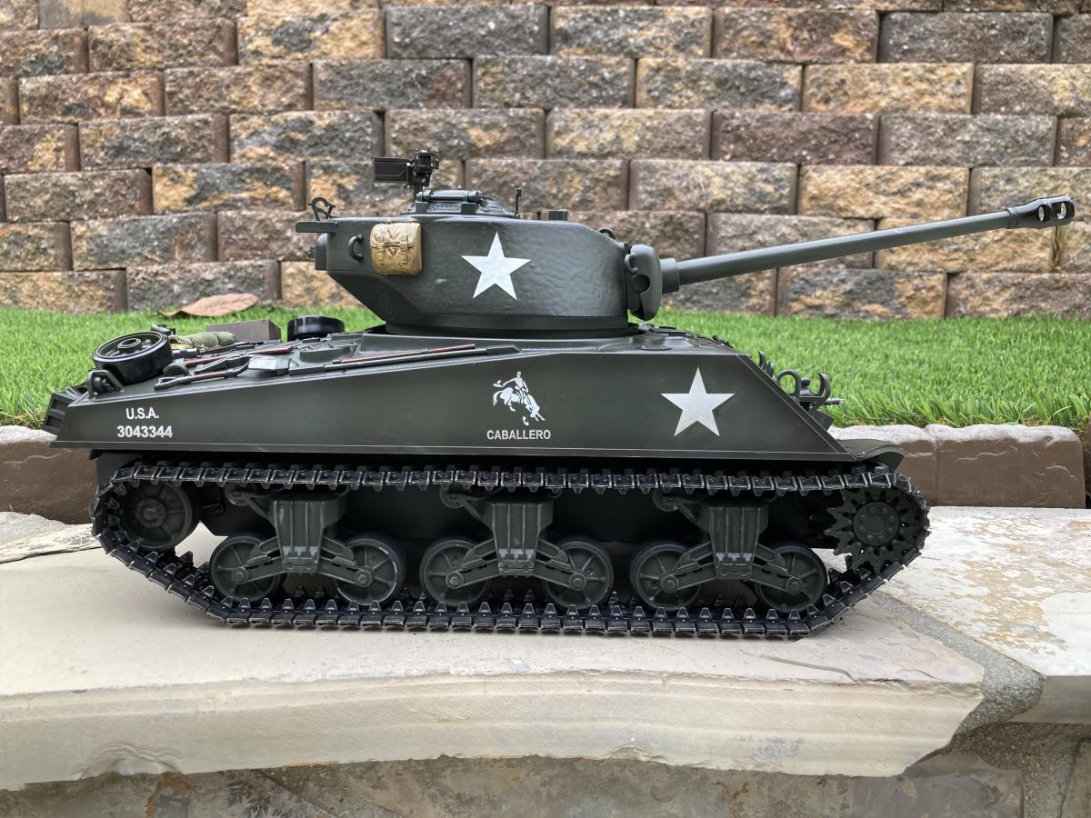

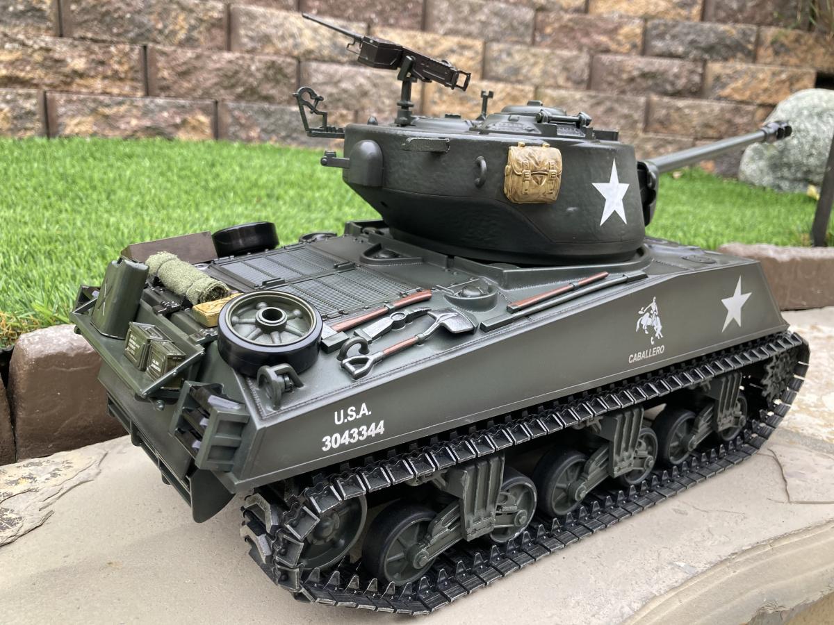

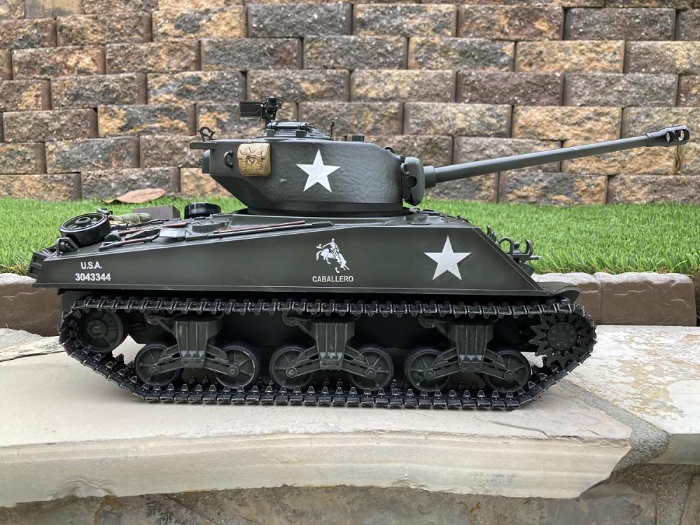

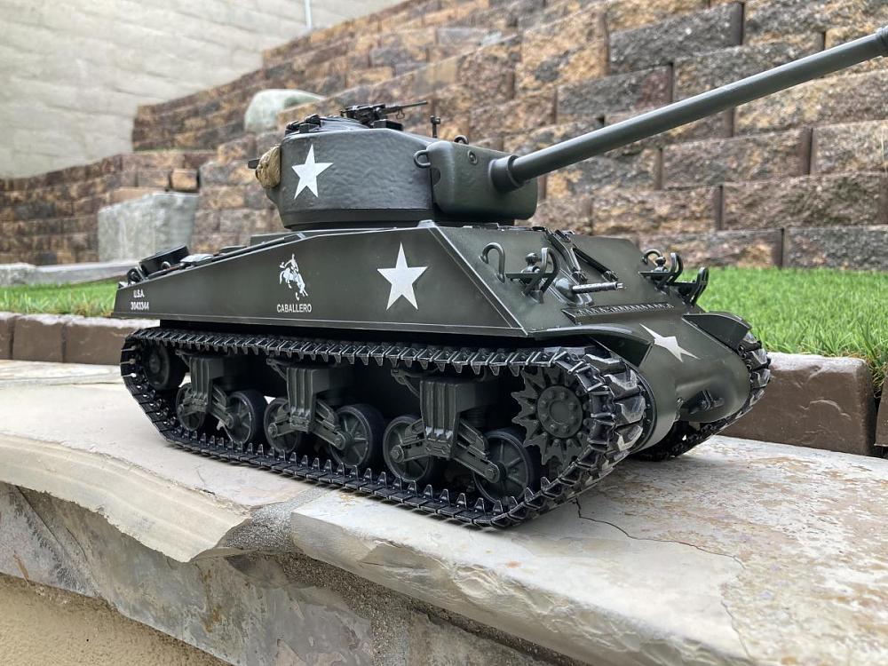

                              Because of the outer rubber road wheels issue, I did not want to take them off to paint the new OD color. So I decided to stay closed to the color painted by Taigen and eliminate the black stripes. Here is my new Taigen M4A3/76:

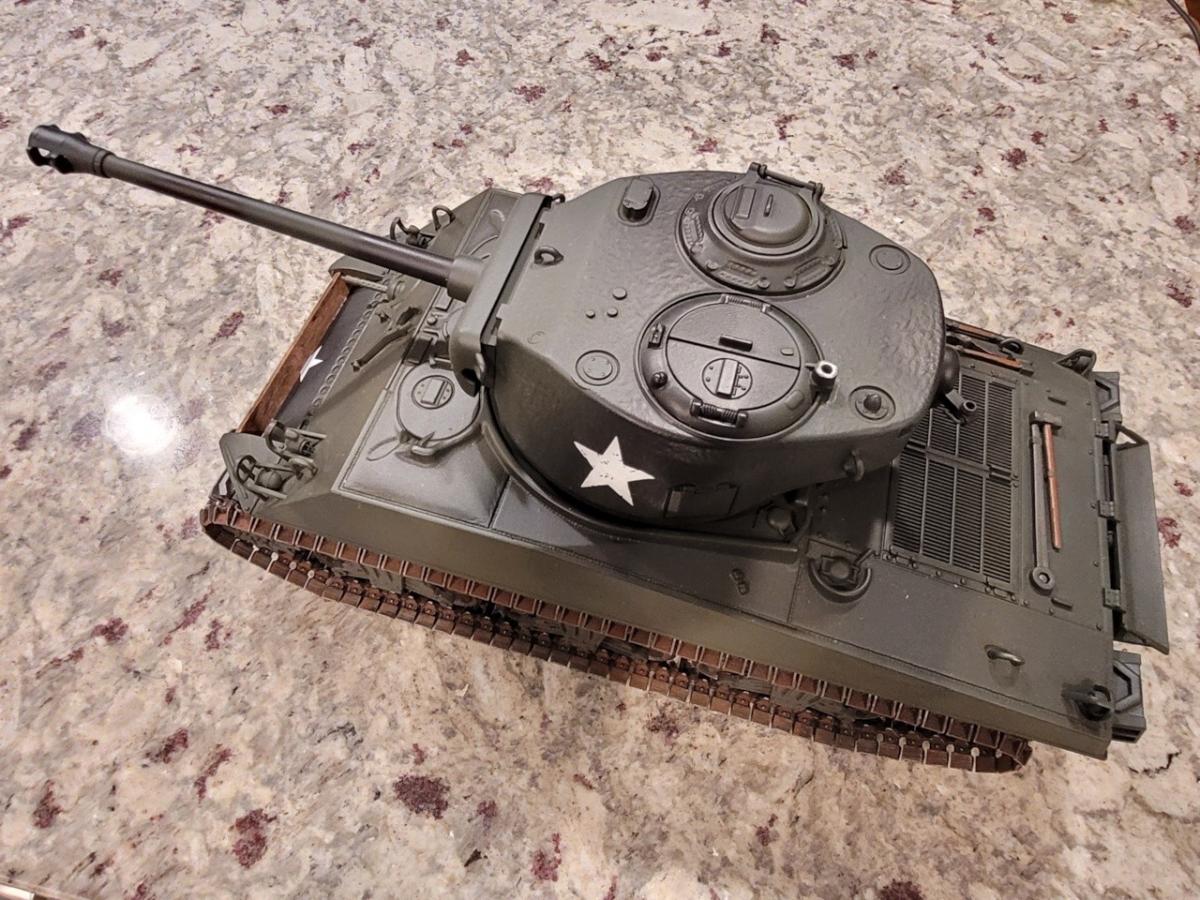

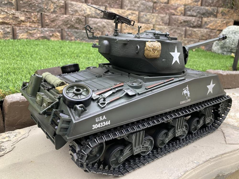

                                  Haven't really done much with mine other than opening up the diffuser and toning down the black stripes, no time to strip for repaint so this will do.

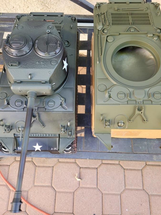

                                      Rich, had an upper hull and Tami TS-5, decided to give it a spin. The left is the Taigen factory toned-down and right is the Tami OD. Will eventually reshoot.

                                        The Tamiya OD paint used to be a tad too dark and needed dark yellow mixed into it by a 4-1 or 7-3 ratio. Then when they added the sticker to the lid in 2021 they changed the color formula and added brown to it.
                                        I have been hopping the color change would get noticed and they would fix it.
                                        when the local hobby shop gets a new order in stock I will buy a bottle and test it again as I did really like my mixed formula.
                                        though that MCW Laquer is so nice looking.
