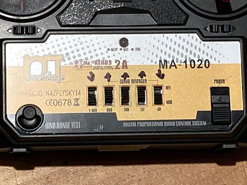

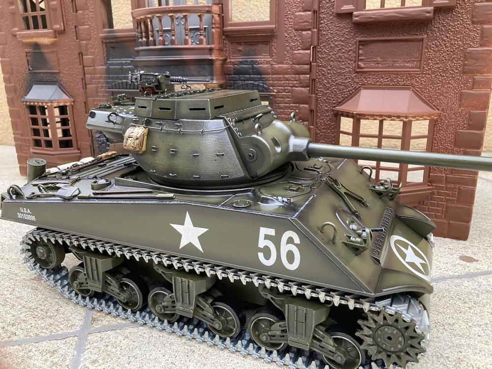

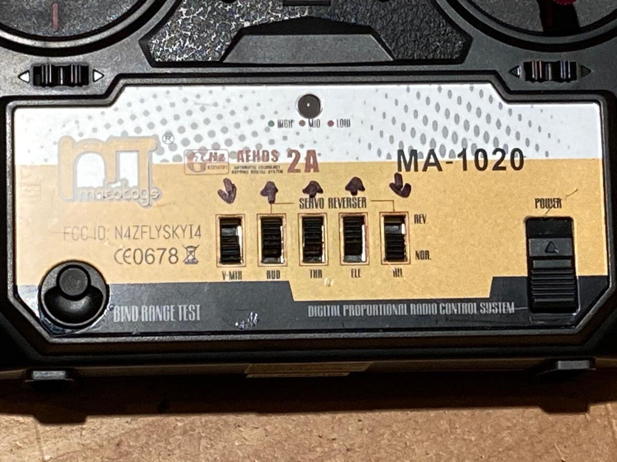

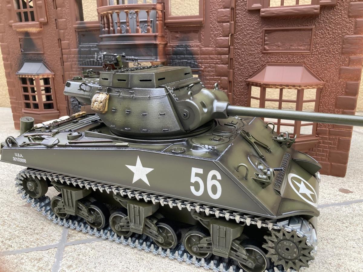

    I hope this response helps. I only have a Mato King Tiger. I marked the position of the servo reversers on the transmitter. So in case if I accidentally shift one of them, I know their original spot and switch it back. You probably shifted one or two of those 5 servo reversers and your tank responded differently. If you don't remember their position, here is mine for you to compare. If it still does not control correctly, then I don't know. Maybe your tank has a different setting. So you might need to play around with those switches until you get your tank running correctly. Many people in this forum have issues with Mato. So for my M36B1, I bought a HL Sherman and a Mato M36B1 turret. I took out the Sherman turret and put the M36 turret on the Sherman chassis. It also cost 50% less :-)

      Hi DavidN thank you for the help, I ensured the servo reverses are set up like yours. But unfortunately the tank still will not steer correctly. Perhaps something is jammed in the steering mechanism. I only had it for a day and it ran fine until I went through some sand and cleared out some weeds from the left track. That’s when I noticed the problem. Thank you for your help, I will trouble shoot those servo positions.
