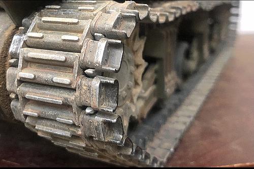

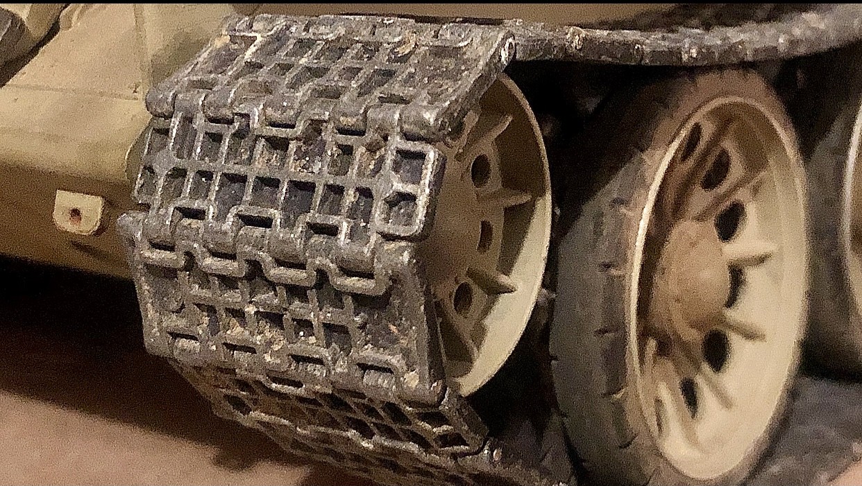

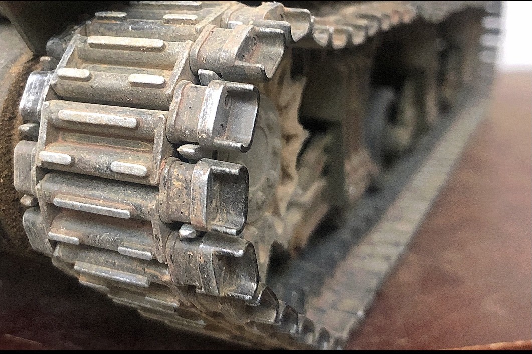

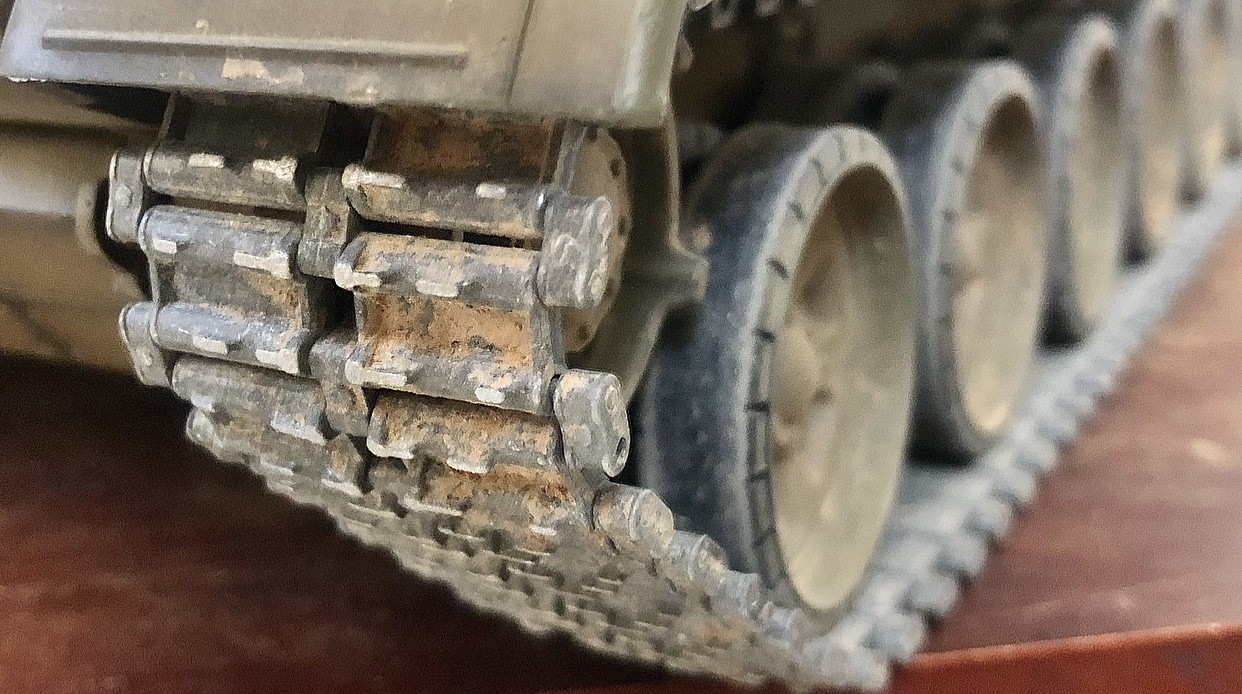

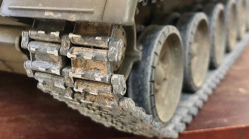

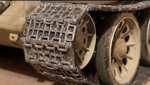

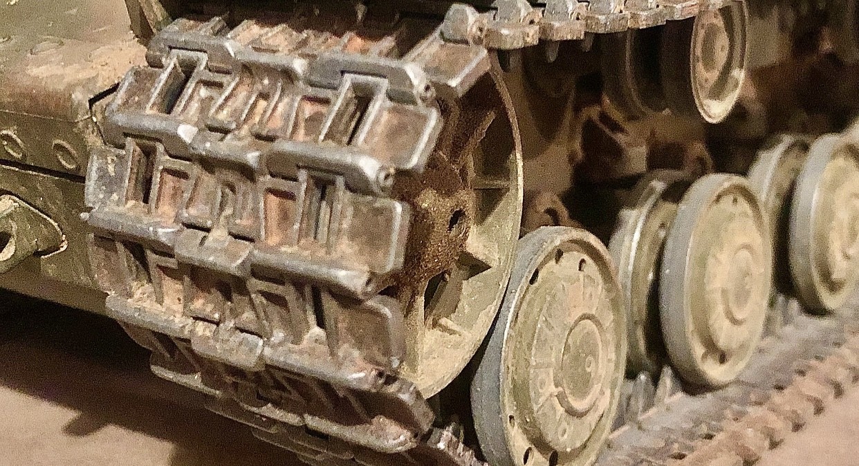

        A good base black is to use “Gun Blue” . It basically adds a black/gray rust to the tracks. It’s the same stuff used to “blue” gun steel. It can be found at any sporting goods store or gun shop.
        All paints and “blueing” will wear off over time some faster then others. What you will have left is usually the nooks and crannies that retain the applied “weathering”.
        Running the tank outdoors will add the best weathering to the tracks. Here are some examples with blueing, paint a mix of both and then letting natural wear take effect. As you can see they all end up looking similar.
