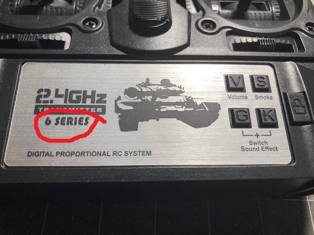

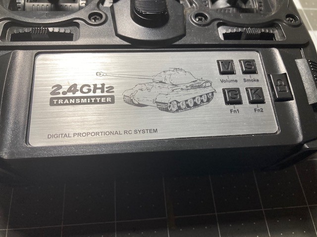

          Here how I recognize my HL radios. All of the 6.0 radios have the "6 SERIES" printed in the front lower left with the picture of the T90 (I think). All of my 7.0 radios have the Porsche Tiger picture in the front.

            But I might be wrong as HL can just put anything in the front :-)
