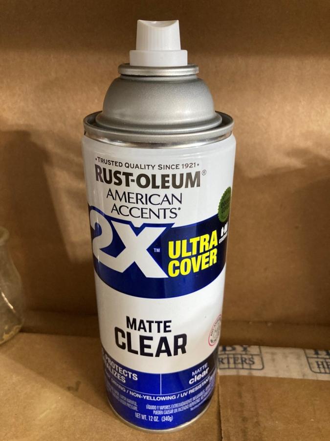

    For all my outdoor tanks, I sprayed a thin layer of this on from a distance of a foot. It's about $4 at Walmart. After I run the tank outdoor, I use an electrical air pump to blow the dust off. I also use a big paint brush. No effect on the tank. And I can put the tank back on the shelf :-) If anyone has other method, please share!

    • #3
      Ok cool. Does it make the surface glossy?
      • #4
        It makes them semi gloss.
        Dont worry to much about grease, oil, dust or even light mud getting on you tank. It will all add the the overall weathered look. Unless factory new real tanks are dirty grimy machines.

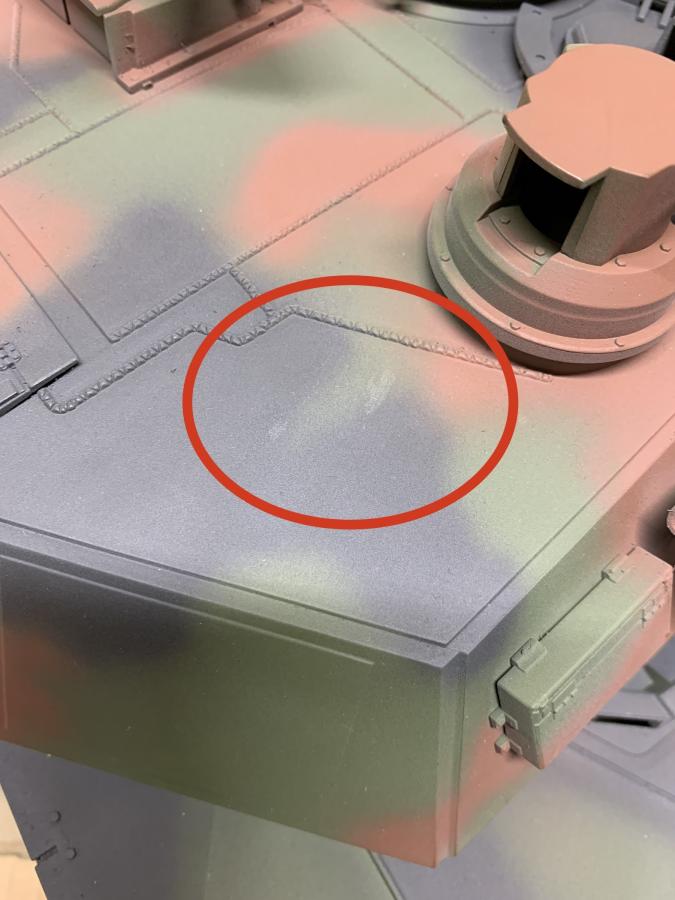

                  Click image for larger version  Name:	60A668F5-1206-4DDB-9453-DEC395327166.jpeg Views:	0 Size:	60.0 KB ID:	333681So for example, I blew on my tank to knock the dust off of it and a small droplet of spit hit the tank and it’s like it removes the tamiya matte clear. I let that dry on it’s own.
                  • #10
                    Have never seen that happen. You should probably redcoat your tank with a sturdier clear coat. I have used a testors dull coat in a glas bottle and airbrush it on. Quite durable.
