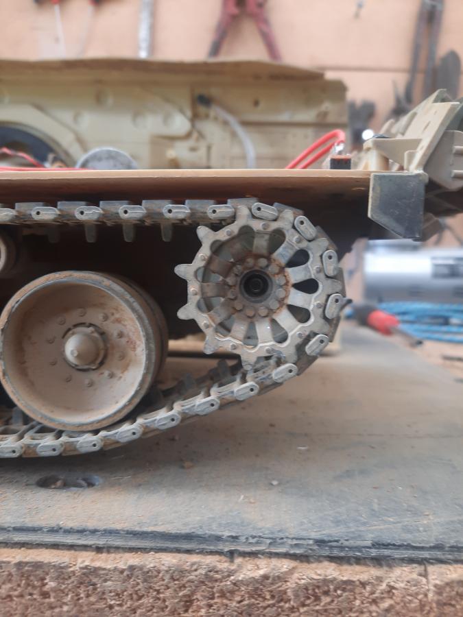

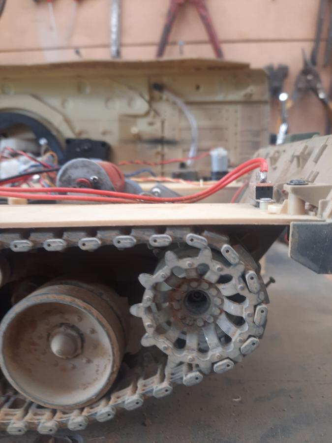

    Took the chally out for a run today and it just stopped. On closer examination found that the left track was partially detracking off the sprocket and locking up tight. The tension hasn't changed, everything seems to be working ok it just keeps riding up on the sprocket. Any ideas Click image for larger version

    The only thing I see is what looks like a loose screw stuck in the track. But perhaps that is just some random thing in the background, it seems blurry.

      Does your sprocket have a track retention ring set? Two rings that sit inside the sprocket that the track teeth pass through.
      If so the track teeth can “ride up” on to one of the rings and cause an issue similar to what you have pictured. There are many reasons as to why this happens but the most common is debris catch between the retention rings pushing the track teeth out of the ring slot causing it to ride up on top of the teeth of the sprocket. This situation then causes the track to become very tight and will most likely stall the motors.
      • #4
        Oldwolf what you saw was a tow hook, had to go and have a look myself. Rubicon yes it has 2 retaining rings but there is nothing stuck in there. I've had both sprockets off and swapped them around and it is still doing it. Would you recommend taking a ring out and which one
