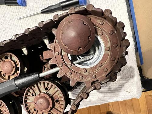

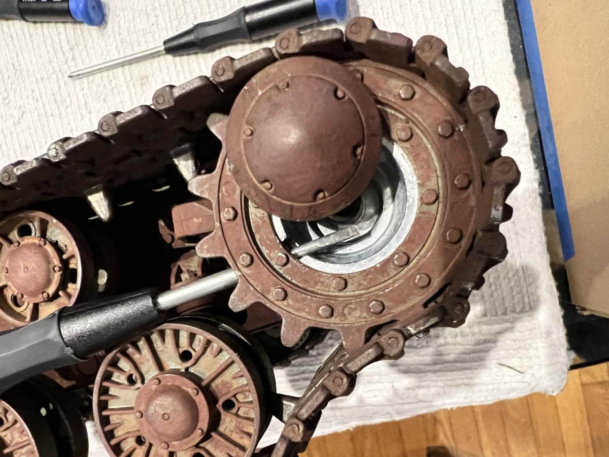

    Some of you might have already known this, but I didn't, so I am putting this out here. Had to check on a noisy gearbox and was struggling a bit to remove the press-fit hub cap in order to remove the sprocket. There is in fact an access hole to push out the cap from the underside, so here it is.
