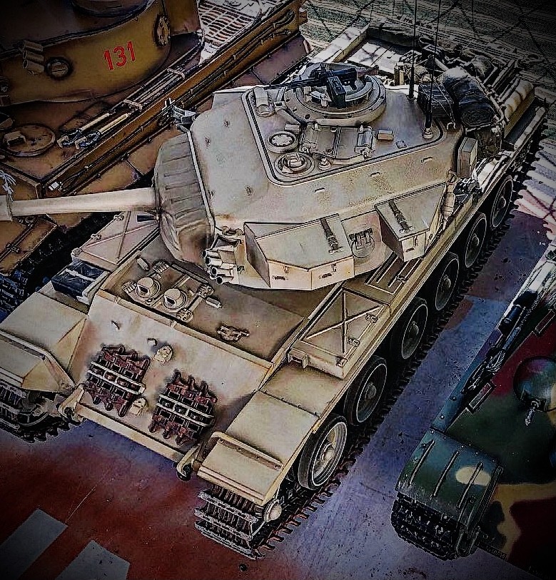

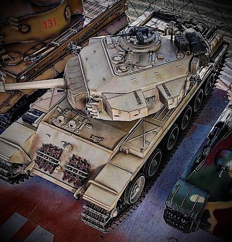

          • #65
            Forgot to post this last photo. Taken at the Feb 2022 LA Tank Clubs battle day. Click image for larger version
