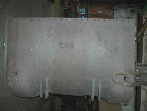

      I haven't tried to fit the transmission cover, but I also was just going to build up the thickness of the original metal one. This is interesting, found this on a JUMBO specific page...transmission armor cover, S/N 256. Nic's is also S/N 256. This cover is an extra as only 254 Jumbos were supposedly built.
      I am going to use Quik Steel to build up the surface. This stuff is tap-able. It is durable, and has a nice texture.

        That may be too dense to work wish, autobody bondo is what I prefer with final texturing and finish with spot putty but good luck.
        I have some good photos on my thread of real jumbo close up.
        yes there were 254 jumbos built with 4 being used for destructive testing stateside. Something like 60 were lost in combat and many were scrapped. Some are now monument tanks or gate guards here and there.

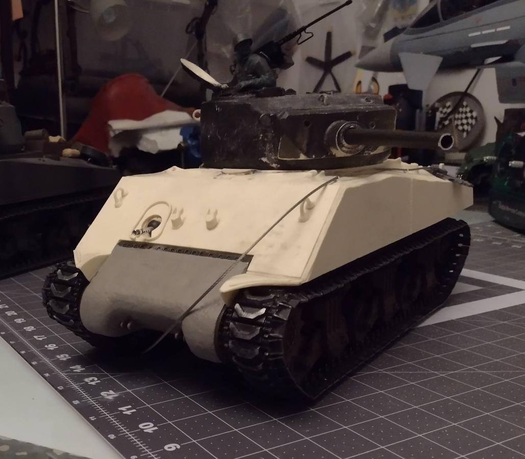

          Fitted the Torro IR 75mm gun and barrel recoil system, and completed the modification to the original Torro transmission cover. Pleased with the results. Also moved the hull machine gun, just have to complete the wiring.
          This has all been possible with a recent acquisition of the Torro M4A3 75 Sherman I found on eBay that was broken and needed some work.
          I used the plastic base of the metal turret fitted to the resin turret, as the resin had nothing to support rotation as it was more of a static model. It's been very straightforward so far.
          I also will need to fab a spacer so the turret has less movement due to the hole size in Nic's hull vs the Torro. Also have to mount the turret rotation gearbox.
          I love the way this model presents already. It's very believable, a great representation of the stop gap Sherman variant.

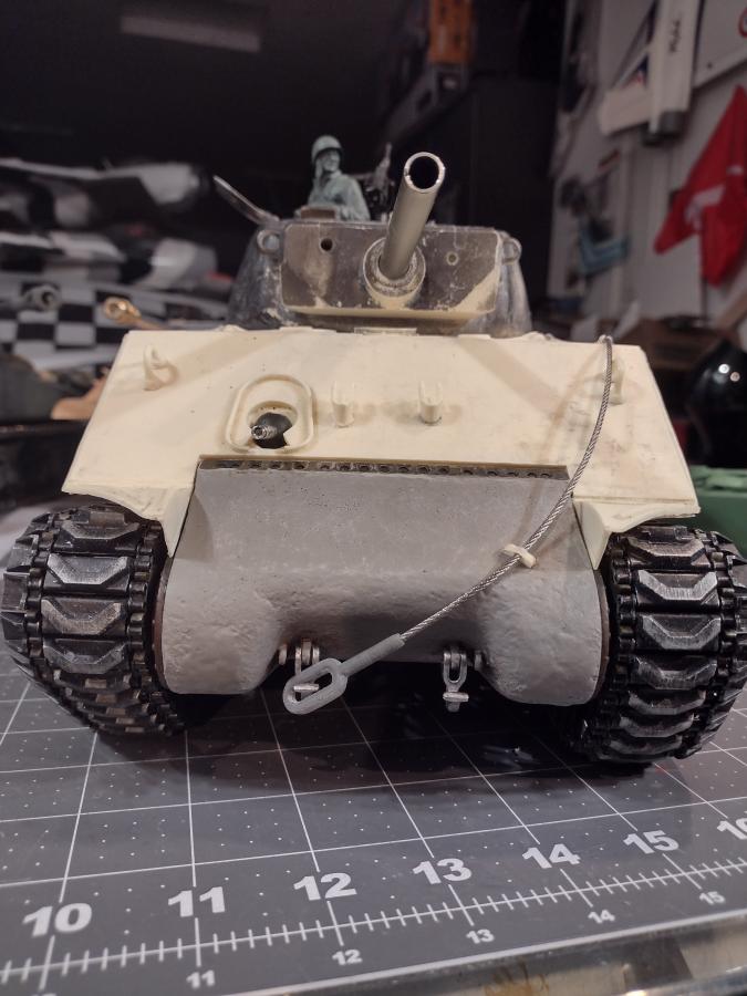

            Love the way they add realism with just a small addition. Makes it even more believable. Many Sherman's had this set up. I have to drill the transmission cover, as these clevis actually have pins and chains as well.

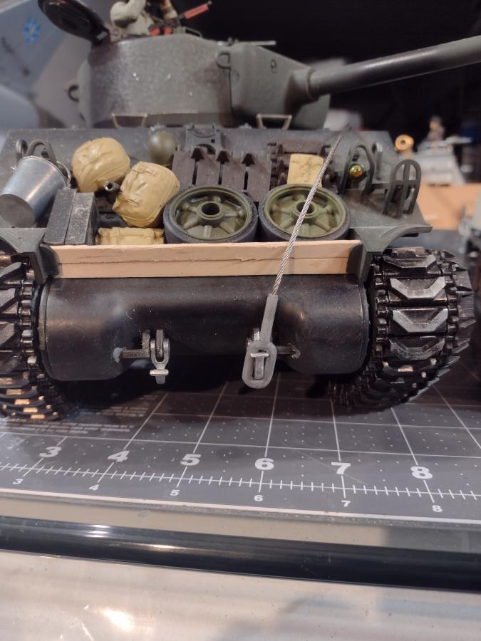

              Here is the other set, put them on my Torro M4A3 76W, and they look equally realistic here. This model is also a work in progress, just not to the level of the Jumbo conversion, which goes without saying.

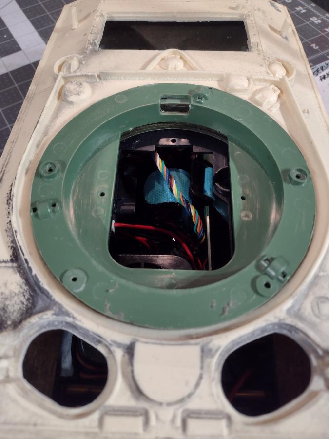

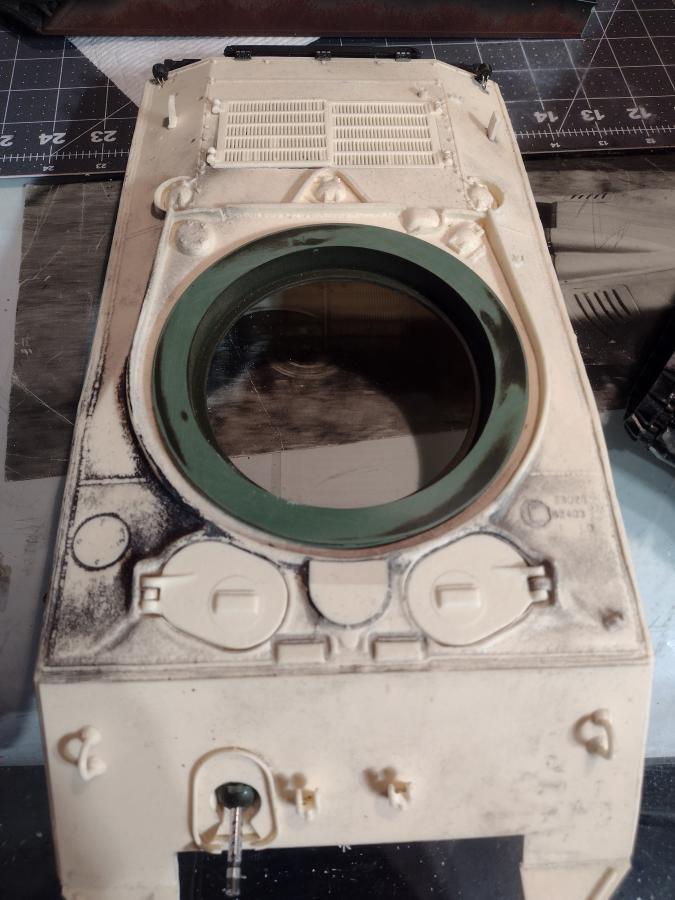

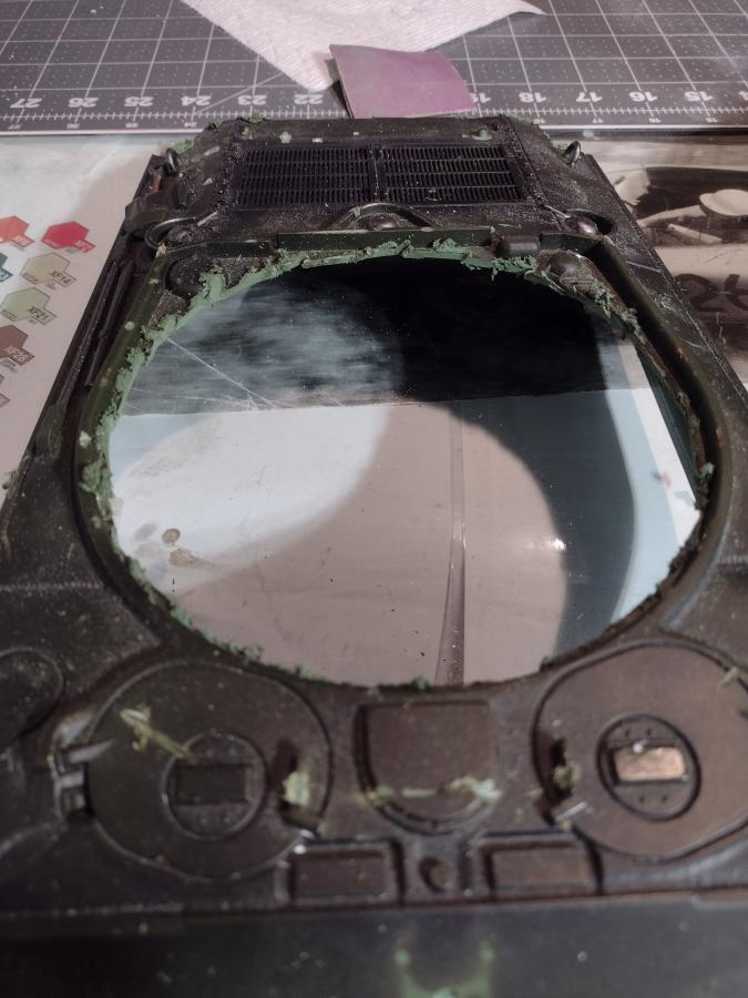

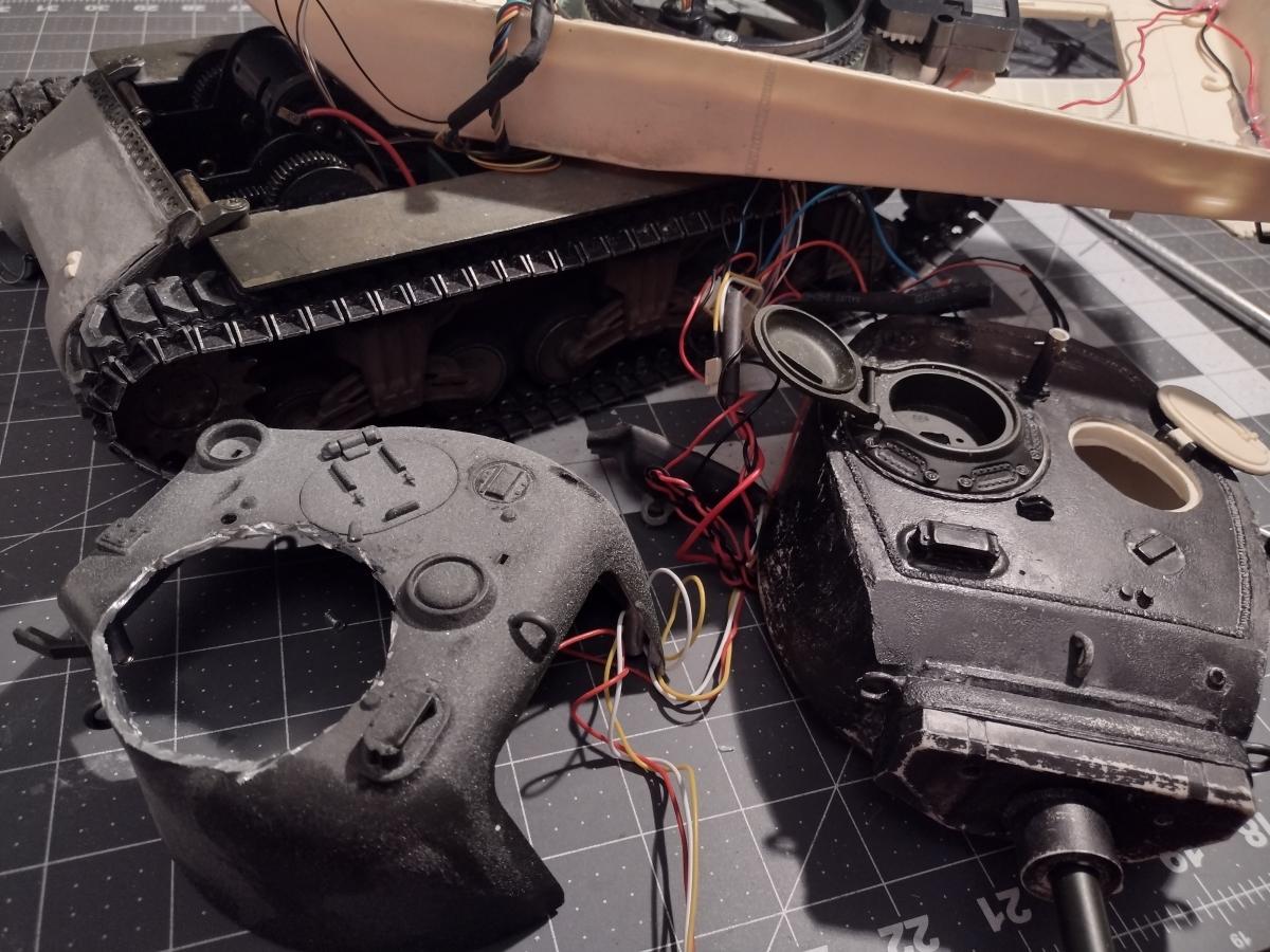

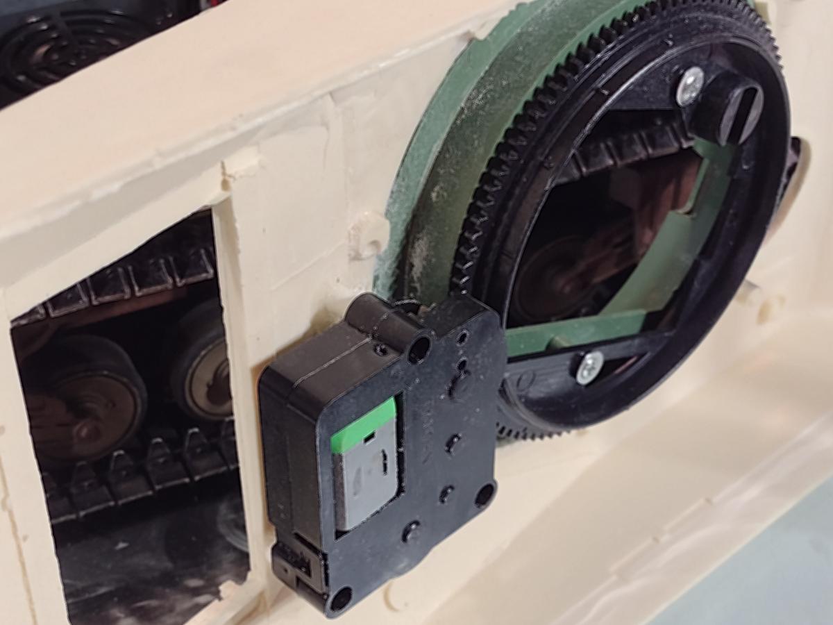

                  Had time today to do a little work on the Jumbo. I robbed all the parts of the wrecked Sherman that I bought off eBay to move into the resin hull from Nick's conversion kit for the turret rotation mechanism. I also added the section of the upper hole where the turret rotates as the resin conversion is really more designed to be a static model than it is to be a functioning radio control model. This will just make the model run with proven parts.

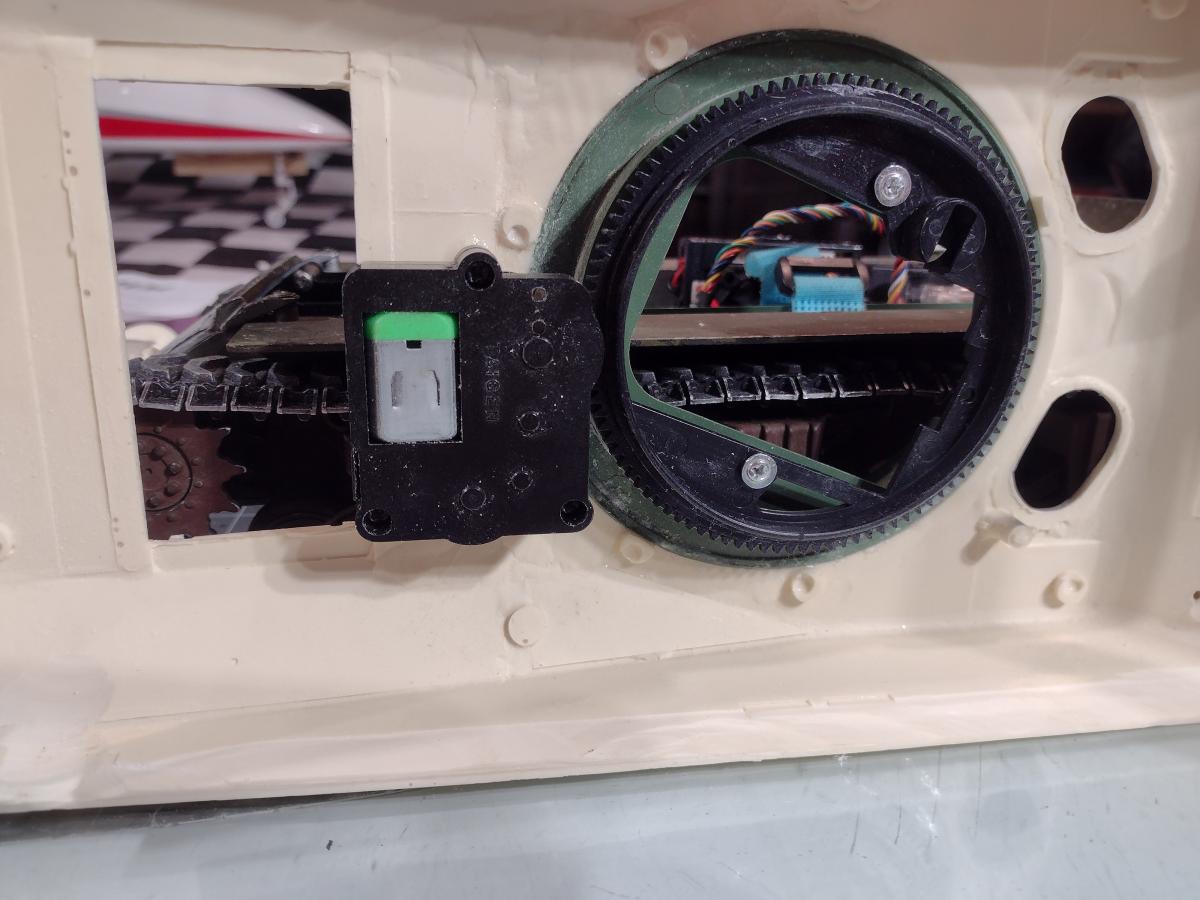

                    Here is the modified base of the metal 75 mm turret from the Torro model. I will wait to complete transferring all of the parts before I permanently attached the upper resin portion of the Jumbo conversion turret to the rotating base. This was an IR model with recoil gun and it should be no problem to make everything work as it did originally. That's the plan anyway.

                        Thanks very much. This method made the most sense to me, and wasn't to tough. I made the supports from plastic tube for the turret rotation gearbox.
