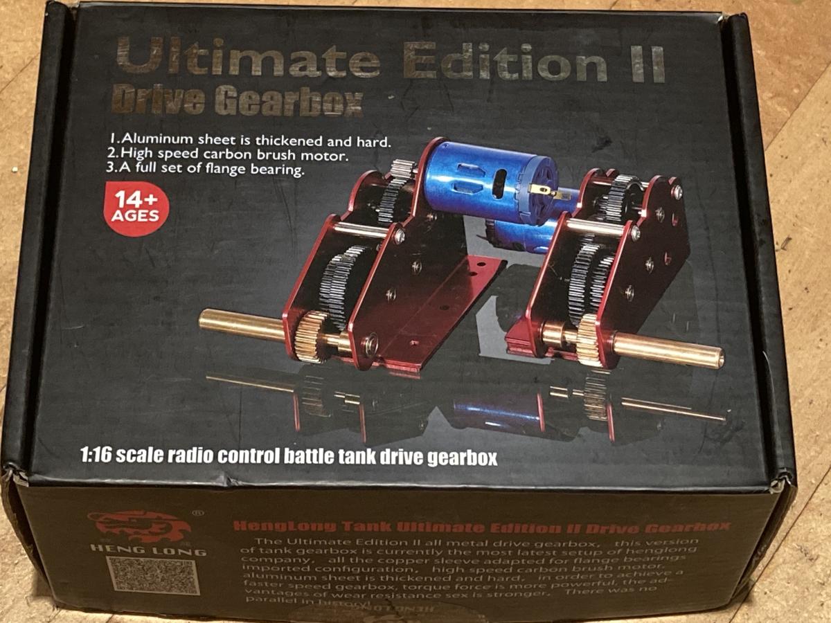

          if I could put taigen trannys (or HL Ultimates) in every tank I would do it. I’m much happier with them and their design.
          Do you mean this kind from HL(pic)? I do have a few installed in my HL IR battle tanks. I will stock a couple more of those then.
          In regard to Taigen tranny, Is the V1 the one comes inside the tank with all the NIB tanks from them? Is the V2 good enough for upgrading? Or the is the V3 one you are talking about putting in all your tanks?
          But I battled with the elephant and I liked it very much how smooth the tranny went. I would like to have 1 more. I will wait to learn more about both Modellspiegel and ETO and then get one. Or one from each :-) Thank you!

            The ETO tranny in your elephant would be similar to any other ETO for a Tamiya tank. ETO and Spiegel are only for Tamiya tanks.
            FYI, Tamiya trannys are pretty good. Unless you drive them as hard as I and Rubicon do, you don’t even need to consider an upgrade. Seriously it would just be wasted money in every respect. I’ve only blown a few Tamiya tranny gears driving really hard and they were heavily used tanks I got second hand. Tamiya also offered rebuild kits that fit the v2/3 trannys in all the full option kits. I’ve used them to repair the gears that I blew.
            realistically, I like the Tamiya trannys over the eto / spiegel design. But, I like the HL or taigen design better. It’s stronger and more widely serviceable.
            live been working on redesigning HL tranny to fit in a Tamiya Sherman, I can do it, just haven’t finished it.
            But, with even more than average driving, you won’t damage Tamiya trannys. Unless you drop the tank and bend a shaft or really get a bad rock jam or drive in course sand a lot like I do, it those trannys were already worn well.
            I would really just stick with the trannys you have in your tanks, no need to upgrade.
            FYI, Tamiya trannys are 5 versions.
            V1 has white plastic gears, only used in pre full option tanks.
            V2 was a new design and is pretty standardized with a shift lever un top to open it up and swap a gear around to a lower ratio.
            V3 looks the same but no tab and no ability to gear shift, mid 2000s this change happened and continued with nearly all the tanks still.
            V4 can be considered the cross drive tranny like Abrams and leopard 2 use.
            V5 is the new build it yourself tranny that is in the Sheridan and Centurian.
            overall, for your use, leave your trannys alone till you break one if you do, then seek advice. Likely it will be just repair it, not replace it.

              Upgrade to Ultimate II or Metal Red for HL?
              Upgrade to V3 or High Low 4:1 for Taigen?

                  If your tanks are running fine I don’t see a need to upgrade them.
                  the older henglongs had crappy metal trannys, they were cast gears that ate crap quickly. Upgrading to the red ultimate trannys was necessary. Not so with the newer releases. But if you have older ones or buy a static one, you will eventually need tranny replacements.
                  Now, taigen trannys are geared slightly lower ratio, meaning they have slightly less speed but more torque. But, the taigen shafts tend to only fit taigen sprockets not henglong. They are different sizes.
                  The taigen 4.1 trannys are ver very slow. If you understand gear ratios at all, the 4.1 is an 89:1 ratio of motor turns to axle turns. Vs the standard taigen 3.1 tranny of 39:1 ratio which is a great combo for speed and torque.
                  By contrast the henglong trannys are a 33:1 ratio, slightly faster.
                  but it’s difficult to mix henglong and taigen trannys between brands. Same with Tamiya.
                  since you have an issue with your Tamiya tiger, let’s discuss that, what is the issue? Does it run fine until it takes a few IR shots? If so that’s normal for that tank.
                  If you perceive tranny problems like clicking, jamming or motor turning but tracks not, the you have developed some worn out or bad gears. A 25$ repair kit from AAF will rebuild 1 tranny to near new condition. Kit does either side but not both, you have two trannys so if you have issues with both you would need two rebuild kits.
