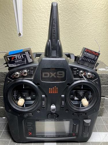

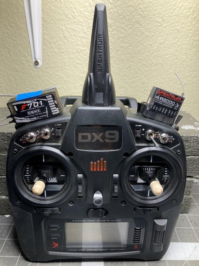

                      For most of my Tamiya tanks, I assembled them first. The rubber tires and tools were set aside. I painted the tank. I weathered the wheels, put on the rubber tires, and the tracks. Then I weathered the rest of the tank. The tools were last, of course.
                      I have a Spektrum DX-9. I used it on all my Tamiya tanks too, except one that came with the Tamiya transmitter. I don't own the Tamiya Abrams. But I think it should be the same.

                      • #12
                        Glad I can use my DX8. What receiver do you guys use with your DX8/DX9? Will something like this be fine https://www.horizonhobby.com/product...SPMSR515.html? Wondering if there's anything cheaper that will work fine.
                        • #13
                          If you look at my picture of the DX-9 that I posted yesterday, you can see the two receivers I put on top of the transmitter. Those are some of the kinds I use. If you need one, pm me and I can send one to you.
