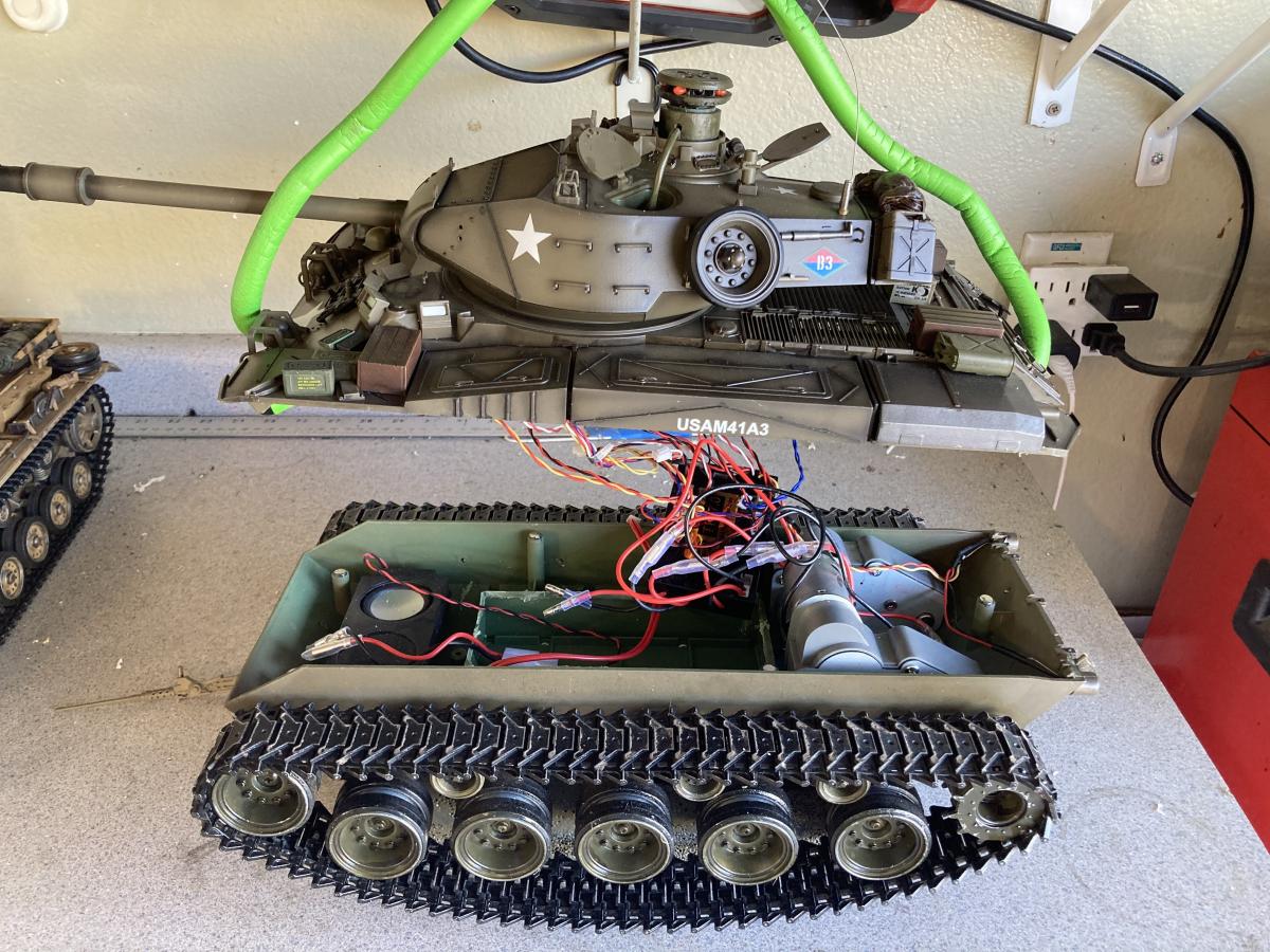

ID:	342841 And here how my tank crews set up the work on their tank. No worry about the accessories on top falling off :-)
