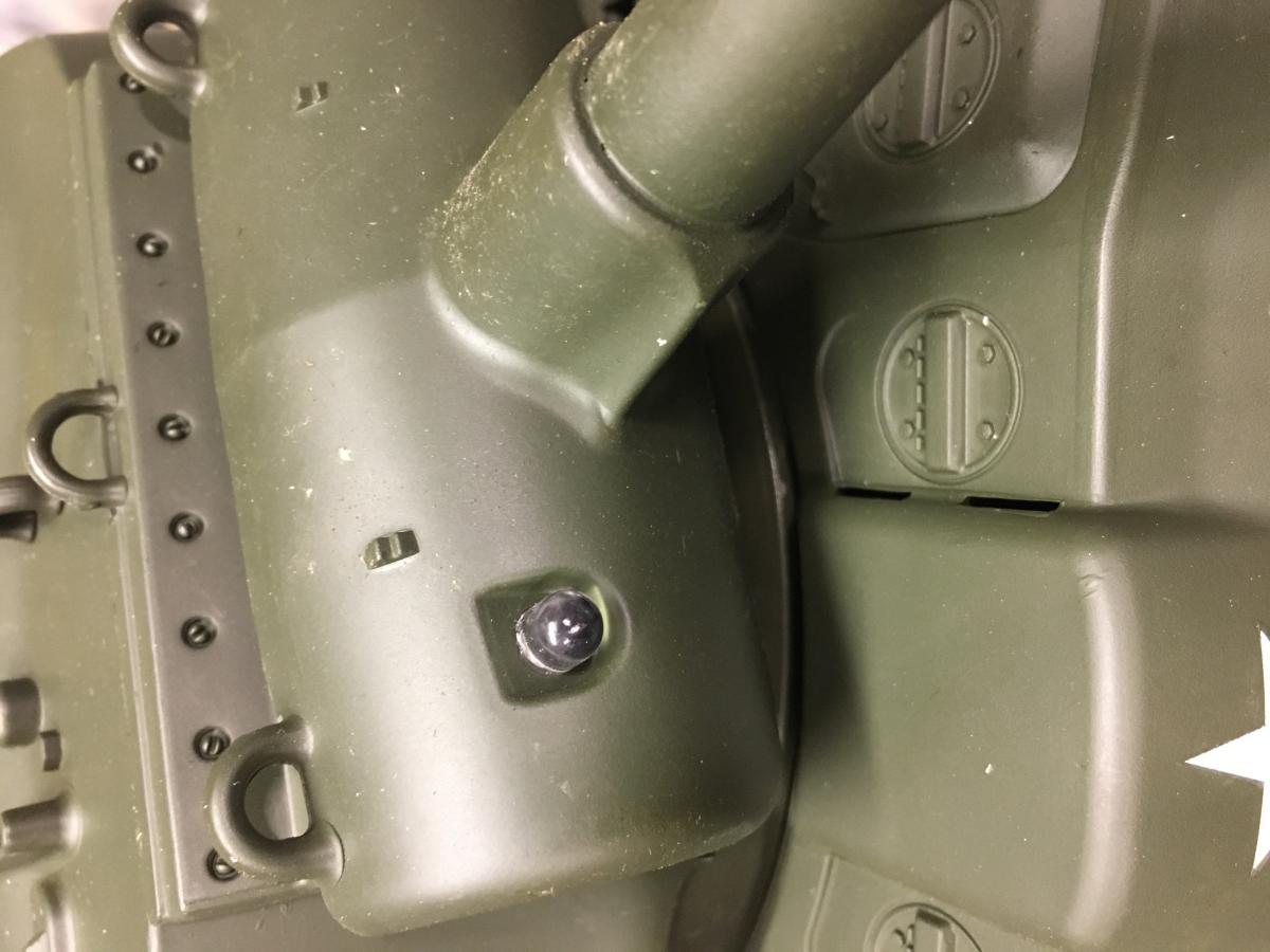

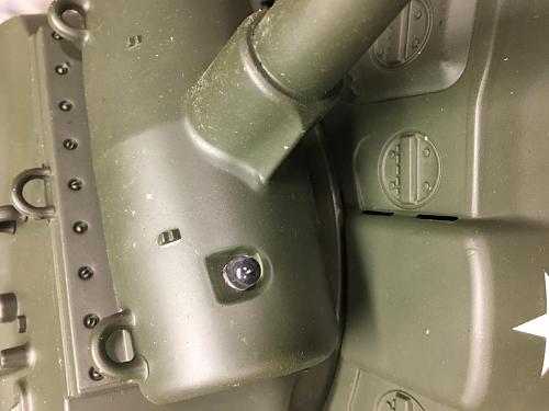

                    Does this count as the IR bulb on a HL? Click image for larger version

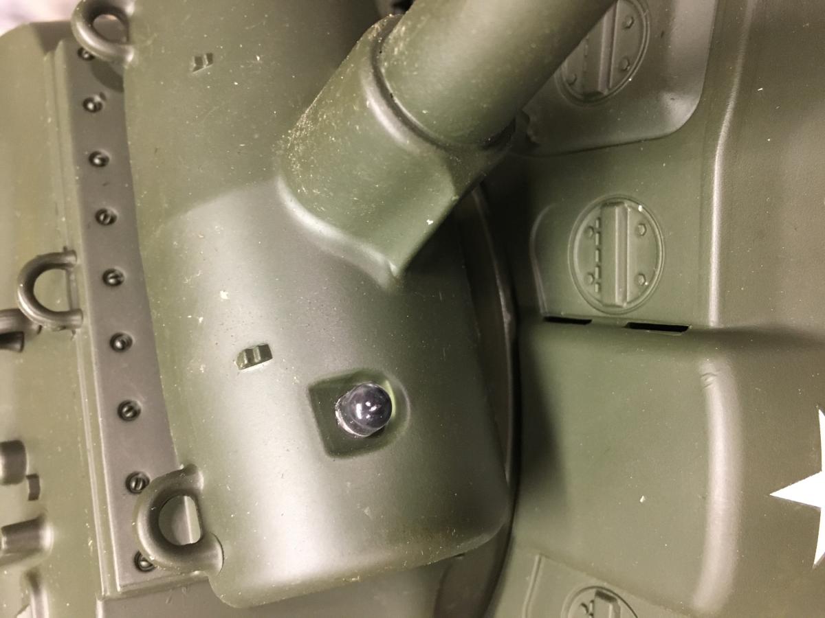

                    • #11

                      As far as the external “placement” goes it is incorrect for “club battles”. The IR emitter must be recessed or covered in some way at least ~8-9mm. Exposed as shown would hit everyone in 180deg arc including your own team.

                        Maybe I should make myself more clear. I haven't touched this tank as it came from the factory. Is that the IR bulb? I know it needs to be recessed9 mm
                          Is it a 6.0 or higher factory tank? If not it is the MG bulb not the IR bulb as the older 5.2/5.3 tanks for the most part did not come with them.

                            It is new. Built last year. My old 18 transmitter won't work with it. I don't own any 6 or higher. Waiting for Clark to ship me a board. I have a 150 tk coming.
                              New or old stock new? Is it a static tank? If static it is an older 5.2/5.3 from “left over” unsold stock that was “stripped” and sold as a “new static” tank. If it was new within the last few years it would be at least a 6.0 tank.
                              That said I would expect with a high degree of certainty the bulb to not be IR.
                              • #16
                                The pre-6.0 M26's had a "gun launch" LED there. Came on when you pressed the cannon button.

                                  Thanks Bob. So I will get an IR bulb.

                                      I already ordered 2 from Haoji. I got an Apple for my Pershing too. Lets try and get the 88 gun going. Bring a 6.0 MFU Thanks
                                      I cruised the Pershing around on a really old MFU and transmitter out of my Panzer and Bob is right the led is red and warns of a pending airsoft shot. I will dig it out once I get the IR emitter.
