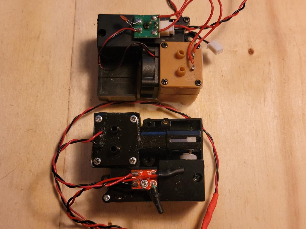

    I decided to try and make the 25mm fan conversion setup like I did for my Henglong Tanks-It works quit well. As we know, Henglong uses a 2 JST connection for the smoke unit. 1 for the heating coil, and 1 for the blower motor. Taigen on the other hand, uses 1 JST connection for both-presumably because its proportional controlled by the speed. So I thought if I simply combine both the fan and the heating coil together, using the stock PCB, then all should be fine. Not so much. Nothing happened. No fan motor spin, nothing. I then checked the resistance of both the factory setup and my rig. The factory Taigen has a resistance of 11.2 Ohm. My rig had a resistance of 1.2 Ohm. So I robbed the little resistor from a spare blower motor and put it on the Taigen PCB. Now both setups are reading 11.2 & 11.0 Ohm resistance....all from 1 JST plug. I figured a home run, but again NOTHING happens. I dont understand WTH is going on here. I hooked the stock Taigen smoke unit back up-works flawless.
    The smoke output is LAME on Taigen Tanks-even at full throttle IMO. I'm at a loss as what to do. Anyone have any ideas? Here is what I did. I even made sure the palcement was exact so all 3 screws would line up from underneath.

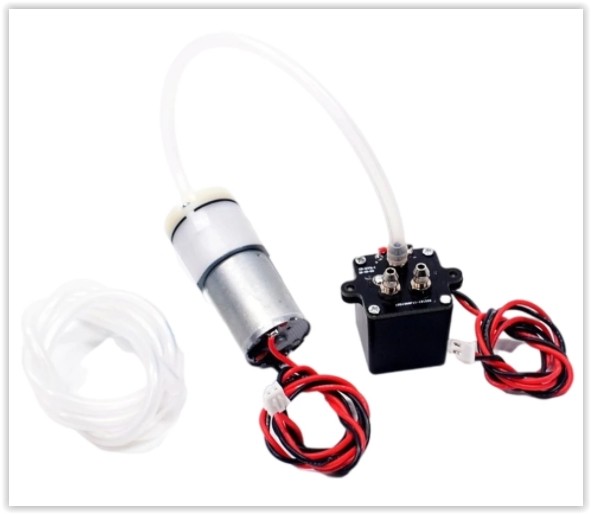

      Zippersnapper Long time.... Not sure you saw this before, I use the aquarium pump setup in my Taigens, and here's a sample clip https://drive.google.com/file/d/1Xzp...ew?usp=sharing

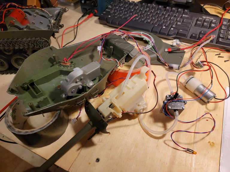

        Click image for larger version  Name:	20220401_155511.jpg Views:	0 Size:	126.7 KB ID:	341264
        But on the Walker Bulldog....I gave up on the Taigen Sherman....
            "aquarium pump setup" ? Is that what is shown in the Pic? Same as the flash & smoke for the barrel, but without the electronic board & LED. Hmmmm. The Taigen MFU has only one connection for both blower & heating coil....how is this wired exactly? By joining the two? Can you link me to where you purchased?
            • #7
              Got some from this place https://www.aliexpress.com/item/4001...rch-mainSearch
              Just merge the 2 plugs in my case. I also used a smaller pump (shorter) due to space. https://www.ebay.com/itm/383801359969

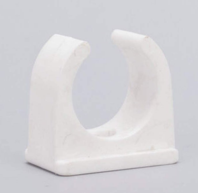

                  BTW, these 25mm ID clamps for PVC water pipe is great for holding the pumps in place. Click image for larger version  Name:	51s7+d-u+7L._AC_SL1500_.jpg Views:	0 Size:	23.2 KB ID:	341445
