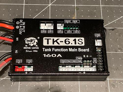

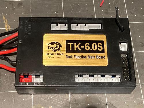

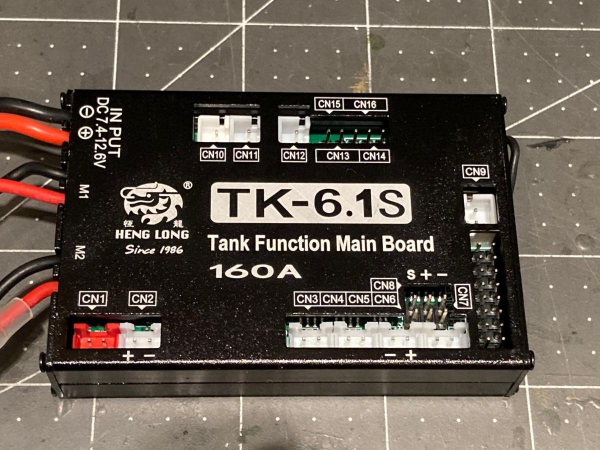

                        The HL TK 6.0S doesn’t have the recoil feature. The HL 6.1S does. I have both. I will bring both for you.

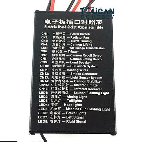

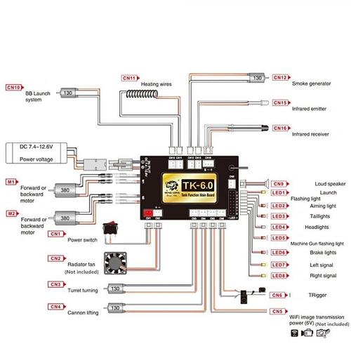

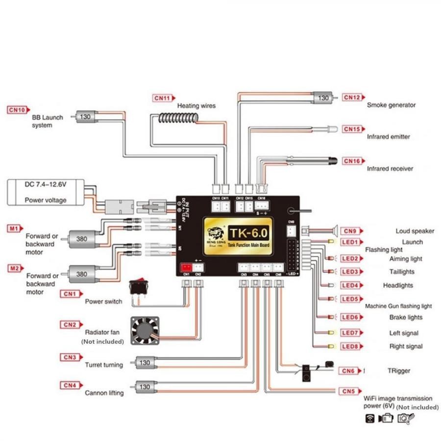

                          What kind of connector should I put on the IR and the recoil?
                          • #14

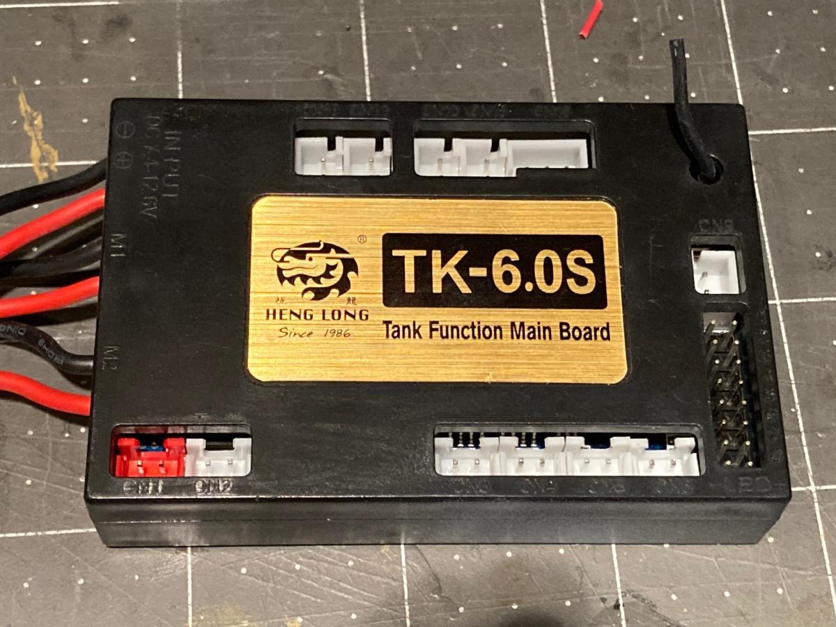

                            Here are the boards with the diagrams. I don't know the names of these connectors. CN15 for the IR emitter and CN7 for the recoil servo.

                            • #15
                              JST-XH connector double socket Has anyone tried a regular servo into one of these. Obviously, you would need an adapter. My guess is it won't work.

                                  I found only one JST-XH connector in my box of junk. I guess I can connect that to the IR bulb to get it going.
                                  • #18
                                    David and I tested it on one of his Heng Long transmitter and MFU and it technically works. IR and Muzzle flash work even though there is a tank engine in the back ground. Just have to figure out how to get the rotation done now.

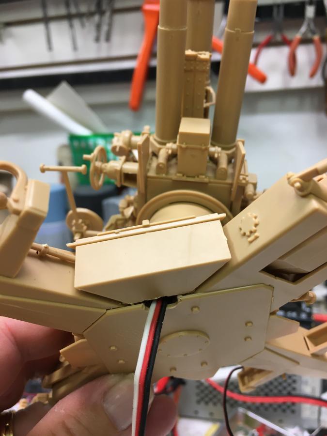

                                        Made some nice progress. I was able to completely conceal the 180 degree turning servo in the base. Now I don't have to make some platform for the gun. Now working on the IR bulb which was so powerful it would go off in every direction. I ground down the IR bulb to fit it into a brass tube.
