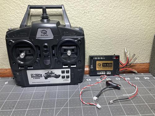

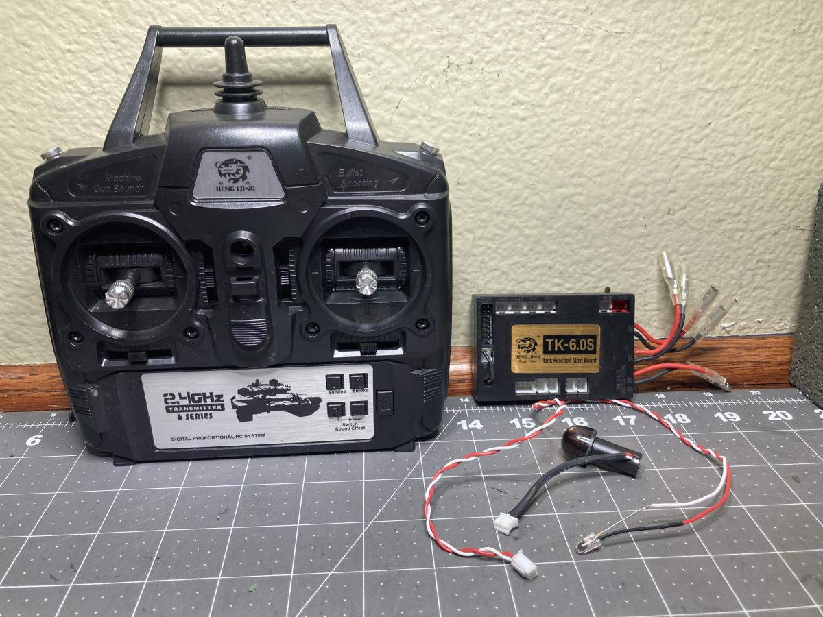

                                    Here are what have that I think your used tank might need: transmitter, board, an emitter and an IR receiver. I will send them to you.

                                      Next time I definitely will buy a brand new one or I will watch it run before I buy it. Lesson learned
