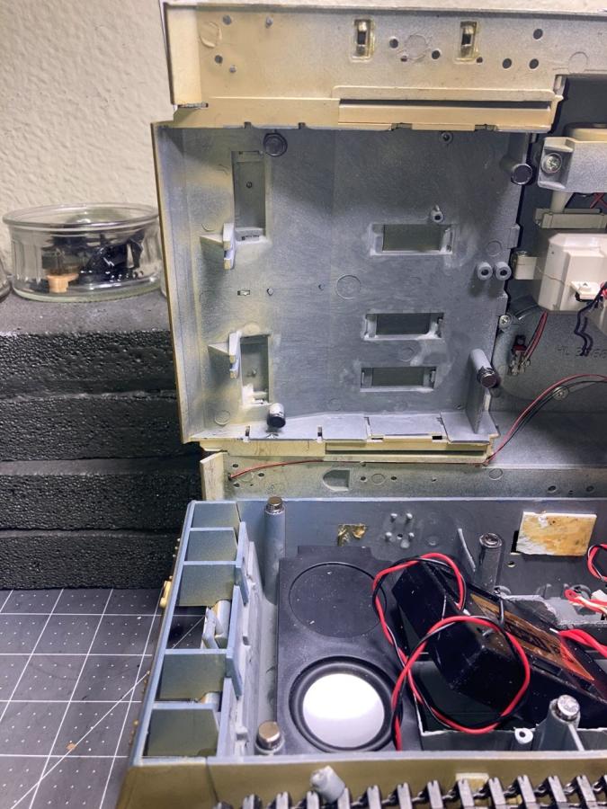

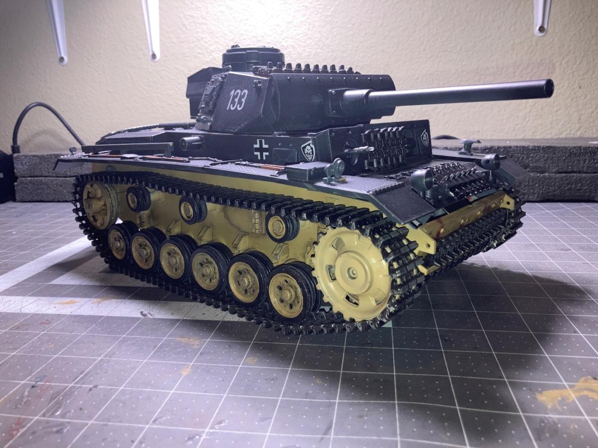

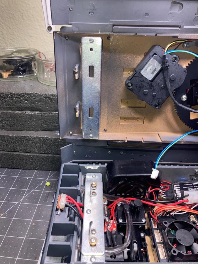

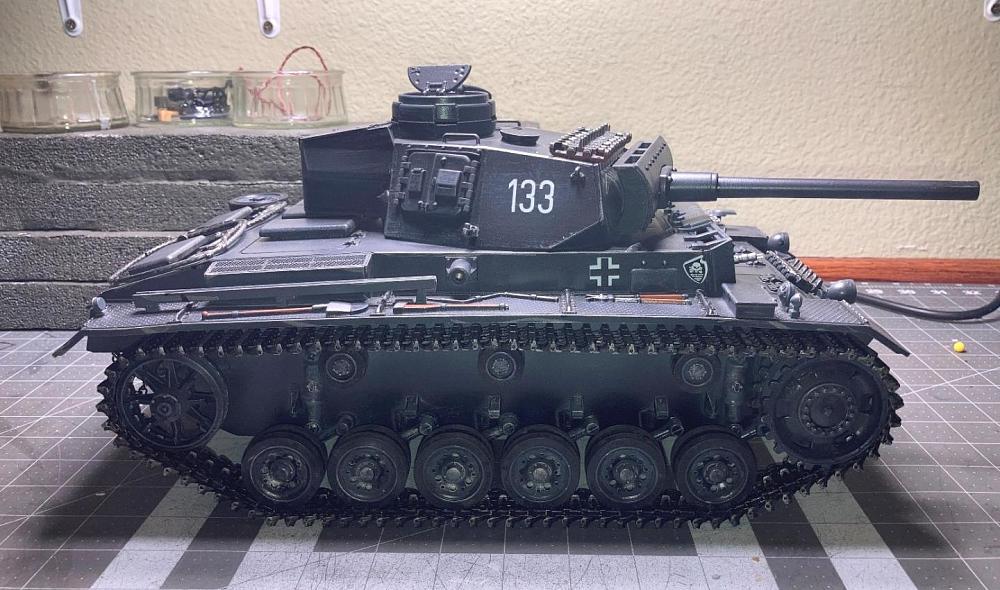

      OK, I hope I am able to help you making your decision.... I have a BB Taigen Panzer III.

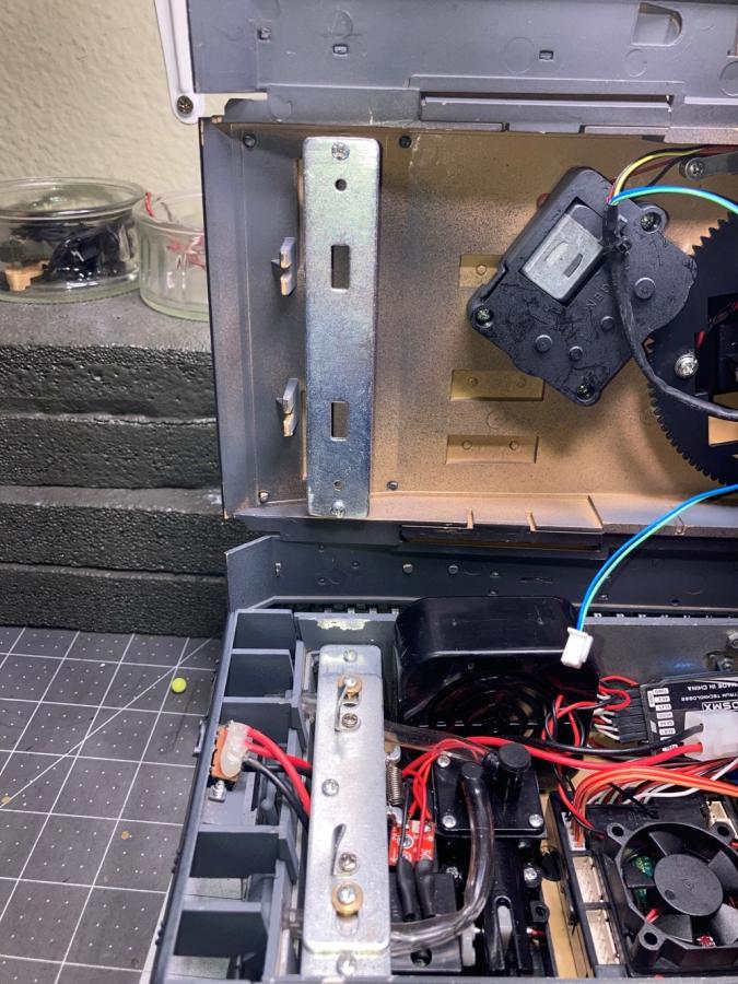

        The way to open the upper hull are the two hooks at the rear and the bar on top.

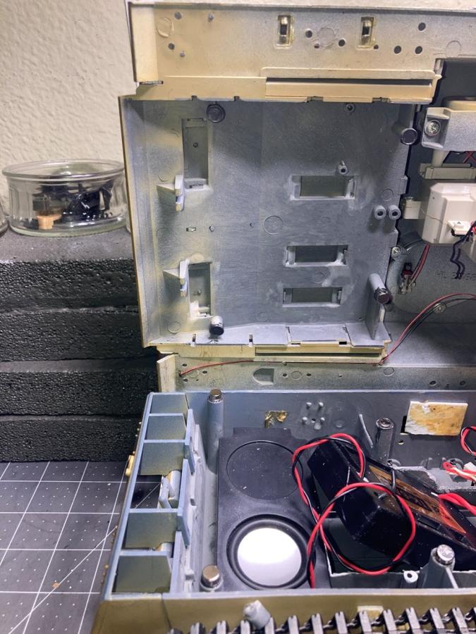

          And I have the HL Stug III and the compartment at the rear is slightly different.

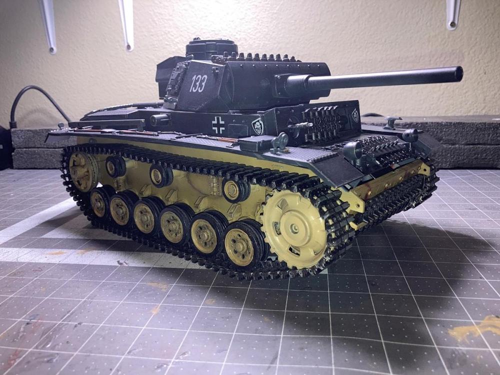

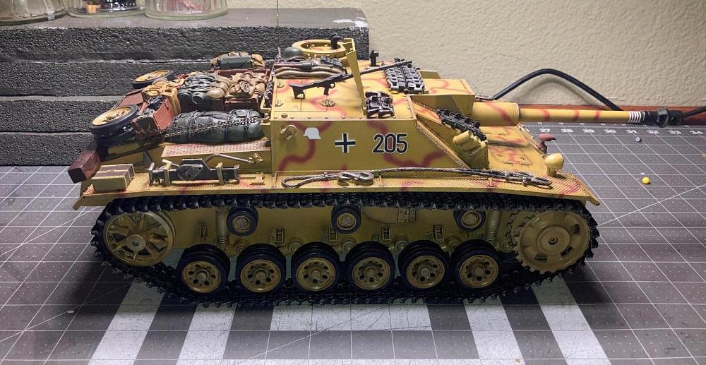

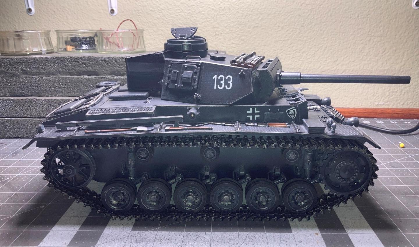

            I detached the electrical attachments of both tanks so I could separate the 2 hulls. The upper hull of the Taigen Panzer III doesn't fit the lower hull of the Stug III.

              But the upper hull of the Stug III fits perfectly onto the lower hull of the Taigen Panzer III.

                It is quite secured too. And since there is no turret, there is no worry about the wires from the upper hull get tangled with the lower hull's component. There are plenty of room in there. Hope my effort helps your plan in putting your Stug III together.

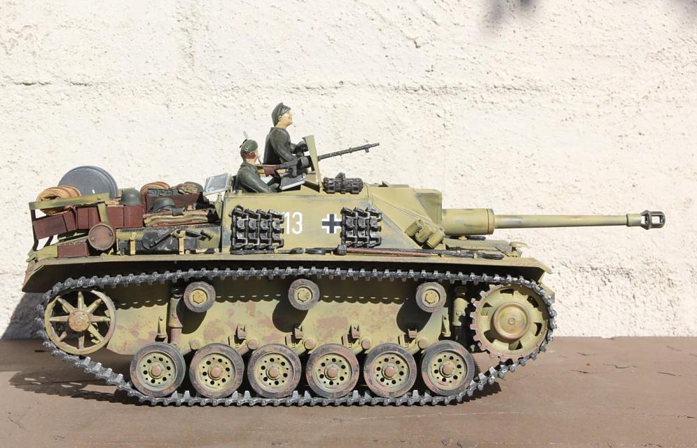

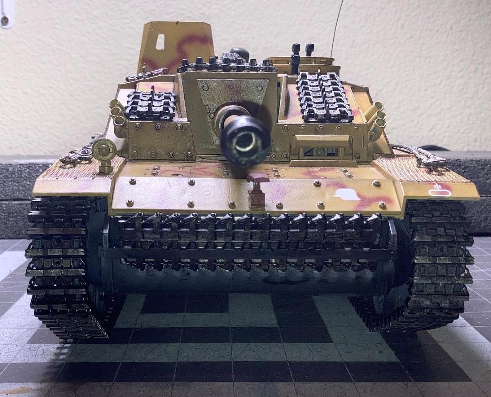

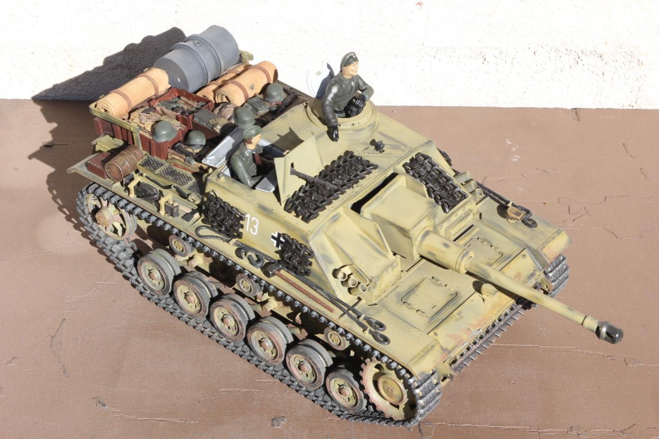

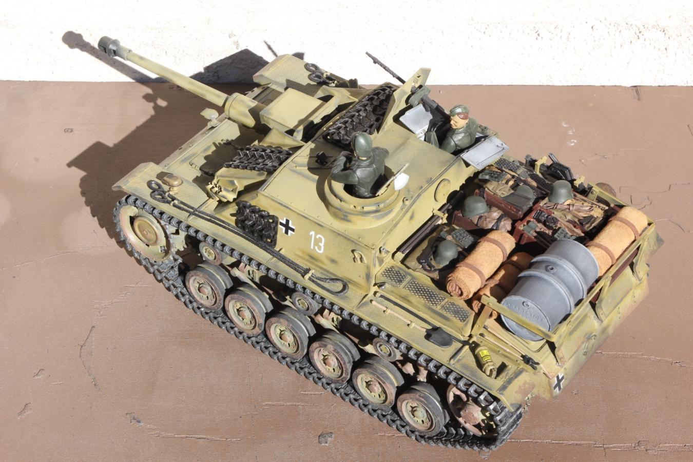

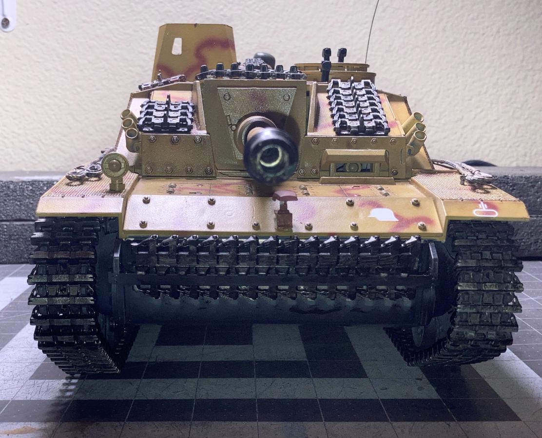

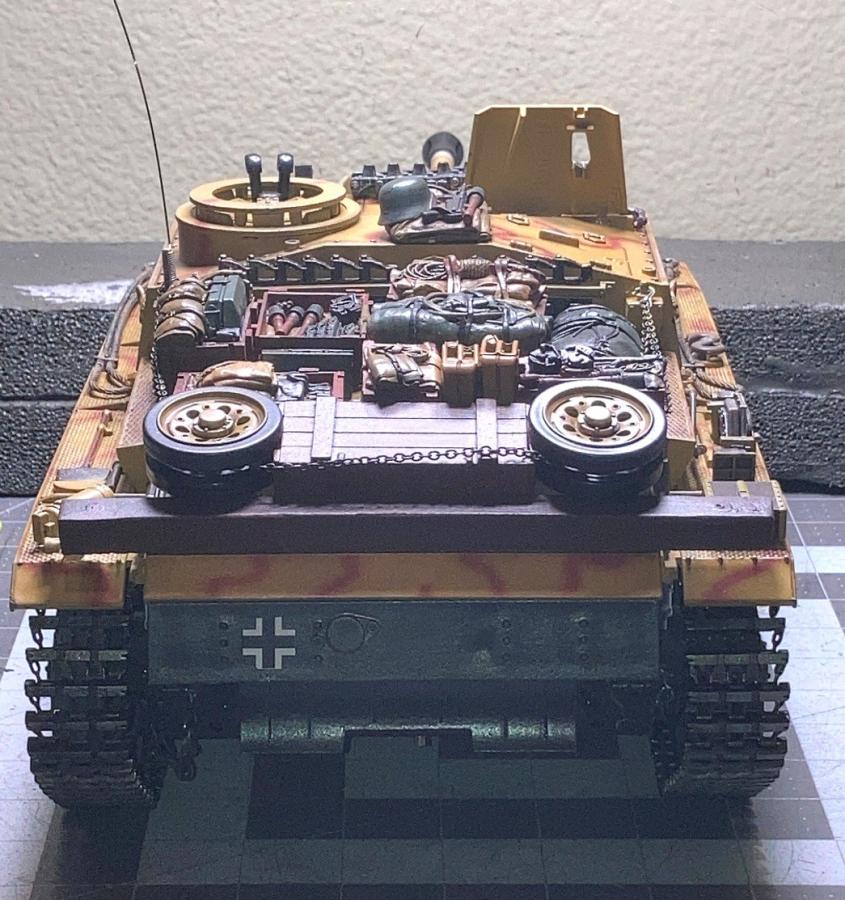

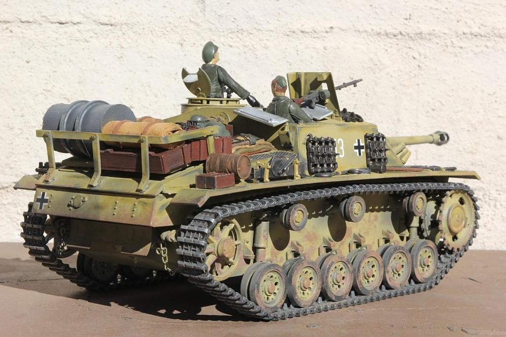

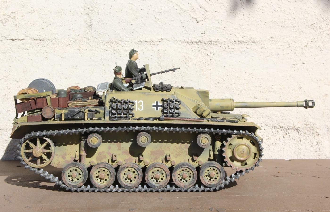

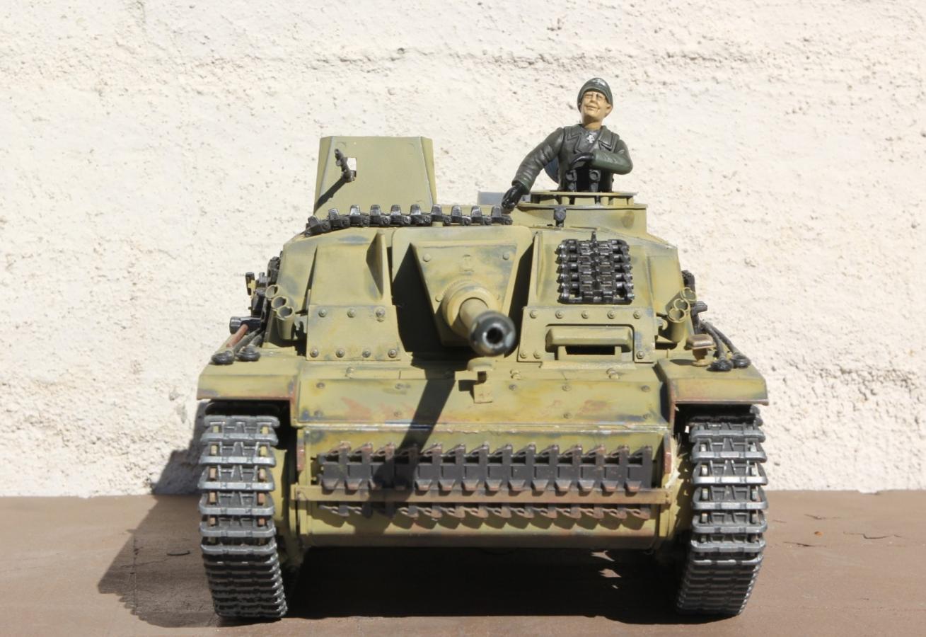

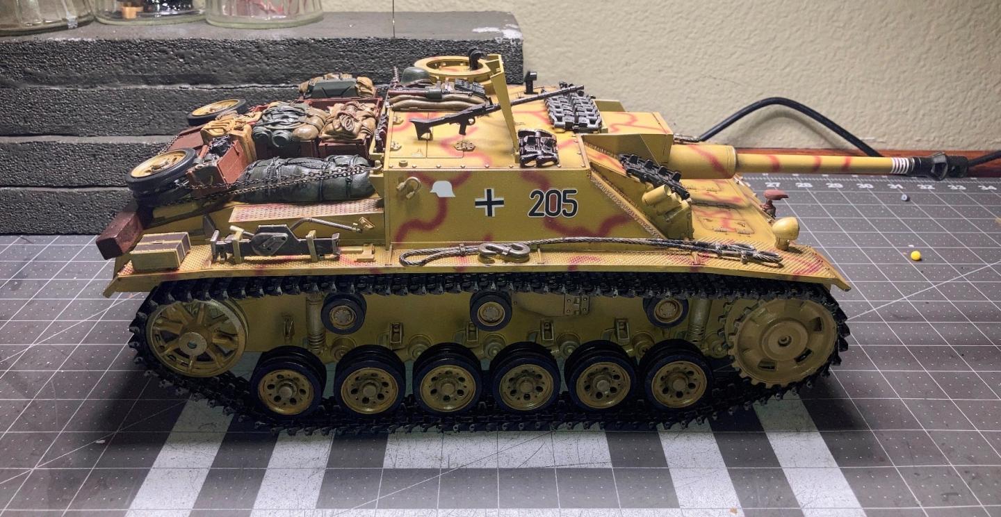

                    My latest Taigen Stug III.....
ID:	364396Click image for larger version

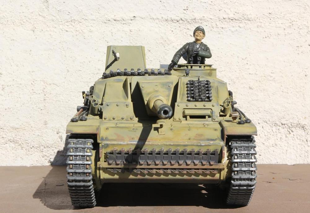

ID:	364399Click image for larger version

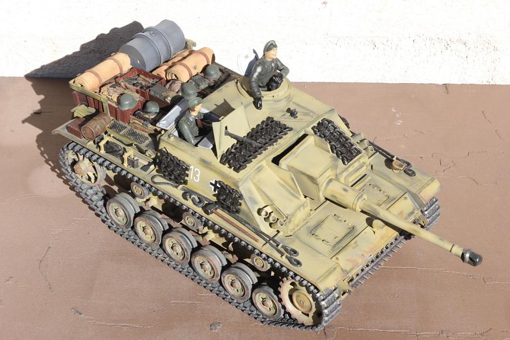

ID:	364402Click image for larger version

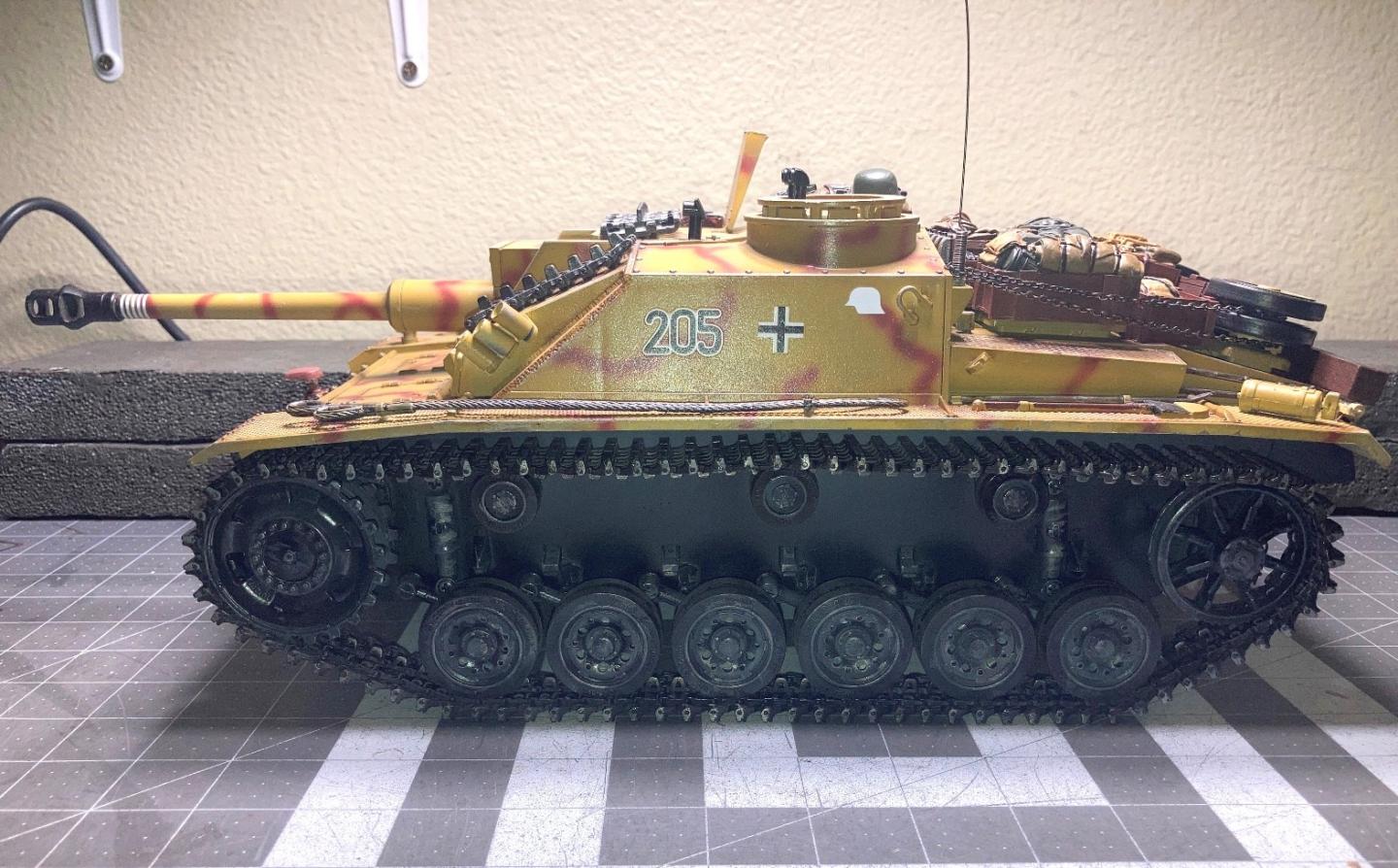

ID:	364405Click image for larger version
                          • DavidN
                            • May 2021
                            • 3189
                            • Los Angeles, CA

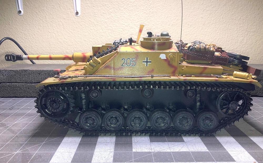

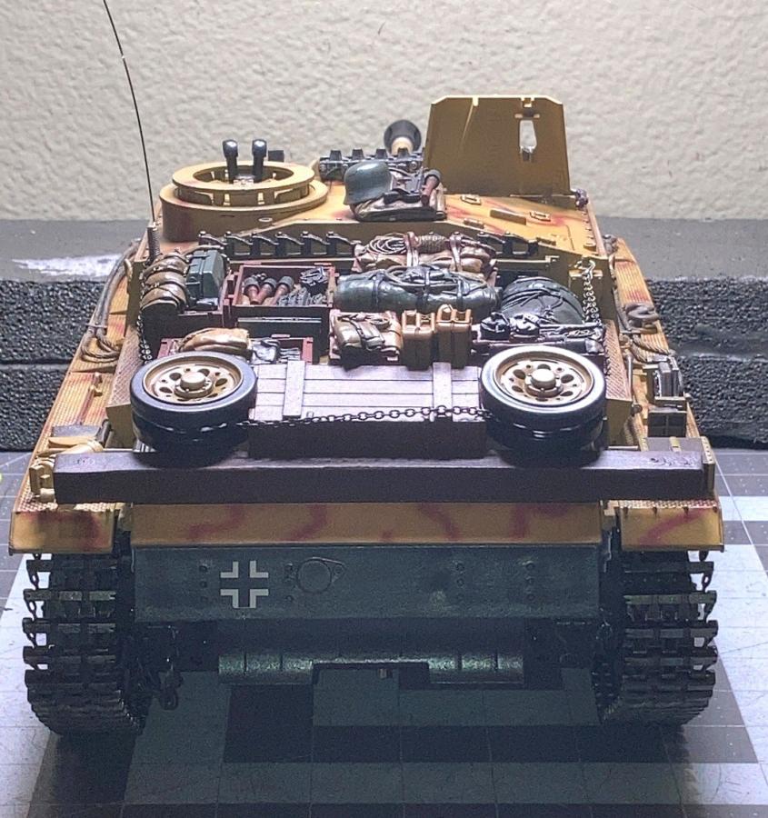

                            It was a purchase. I only added the 2 figures, extra protection track links, and the accessories on the rear deck. It has the Clark's board inside and controlled by the S-bus transmitter. It has very nice engine sound.
