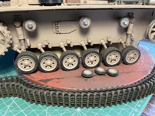

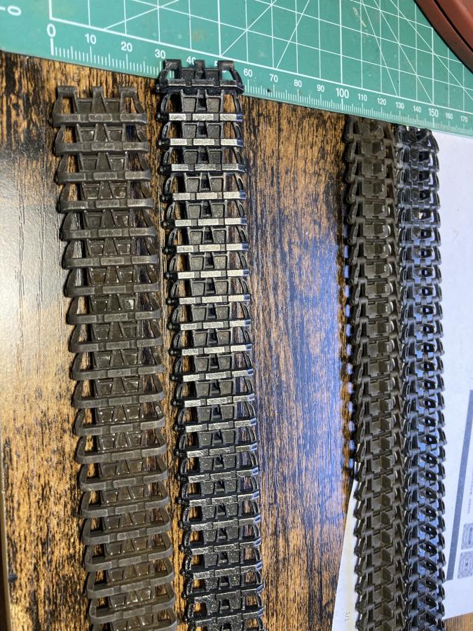

    1 - Track pins - These are working their way out after every drive. Both sides.

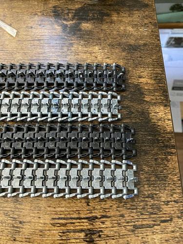

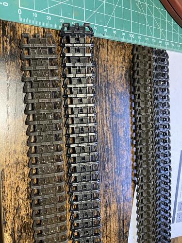

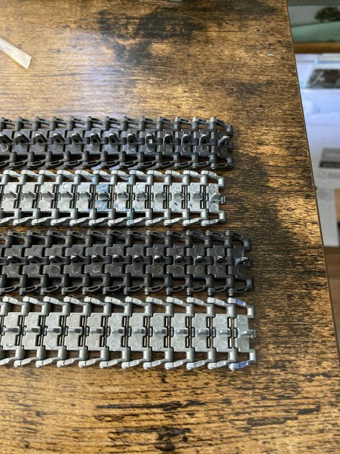

    Solution: I replaced it with a set of HL Pz IV tracks I bought for a project 2 years ago.
    Today I burnished them and mounted. Next time I will scrub a little harder. You can see where air bubbles collected. I mounted both upside down and had to re-mount them.

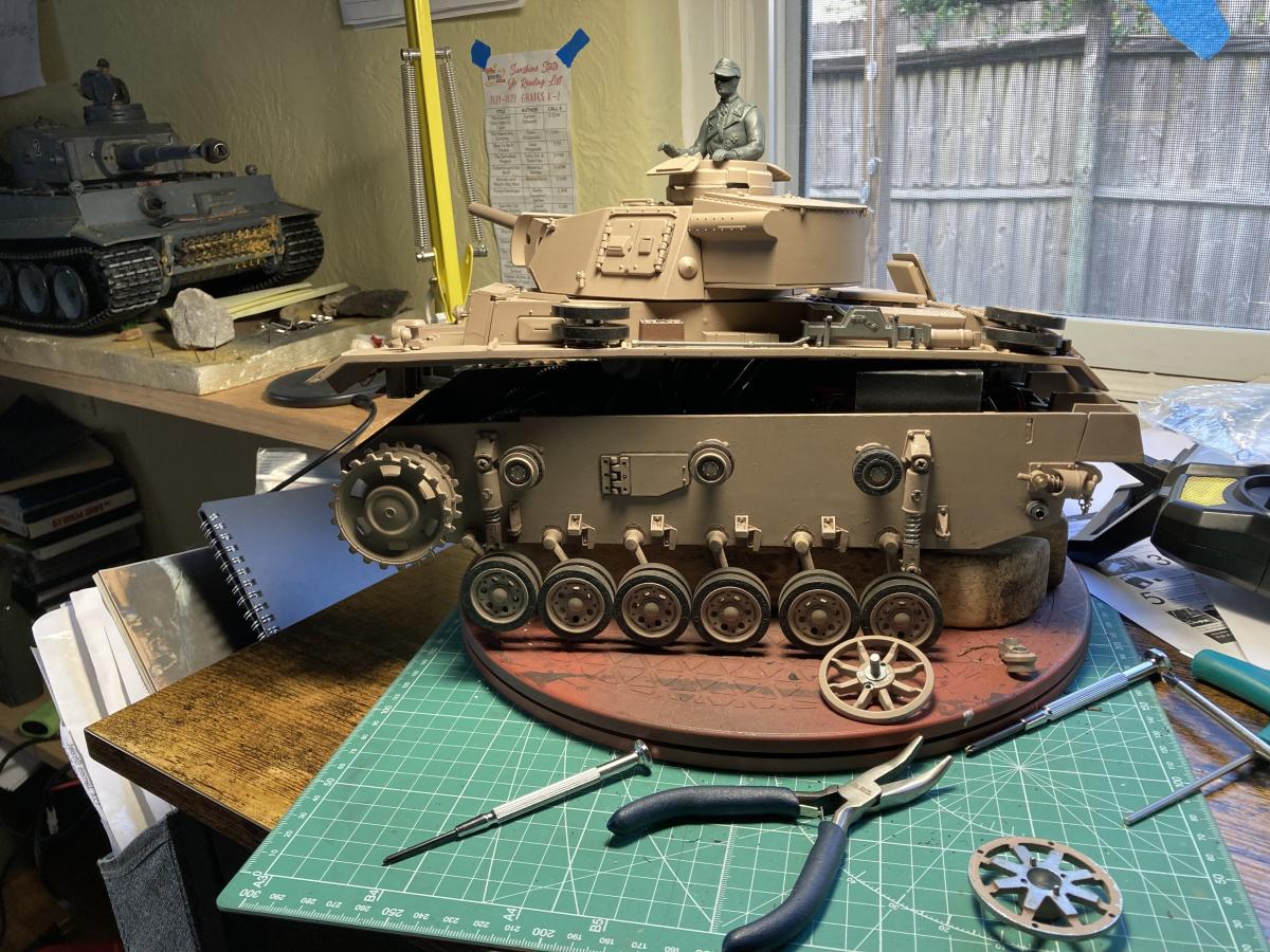

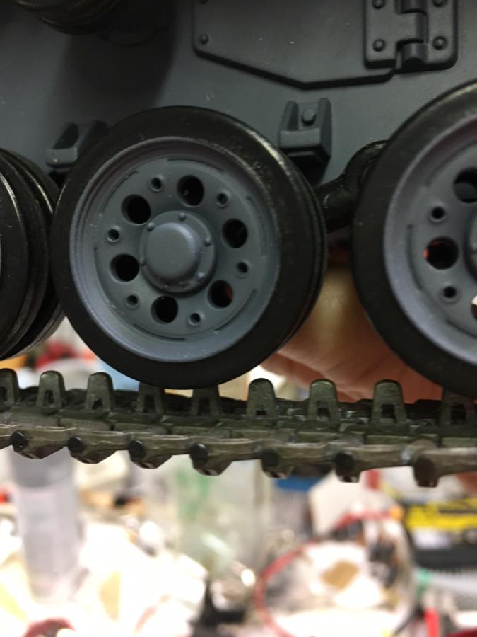

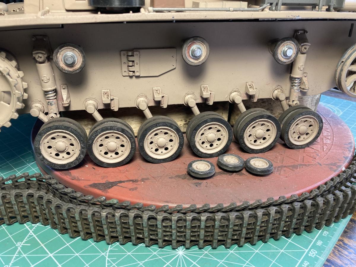

    2 - Track wheels - TC left, track return wheels, are coming off.
    Solution: (possible) superglue to the hub, not axle of inner wheel.
    3 - Spring - TC left rear shock absorber was lodged inside the housing.
    Solution: superglue at the base of the spring.

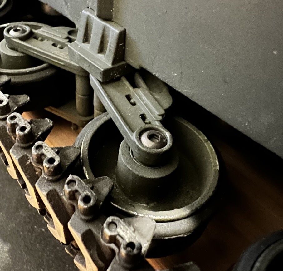

    4 - Idler wheel, both - Does not appear these were tighten at assembly.
    Solution: Tighten and they are both truer however the idler wheels are a little sloppy
    5 - De-track, TC left. Took a link out as it had one more than TC right. I had thrown the left track before.
    Solution: Not sure.

        Panzer III are notorious for throwing tracks. solution= correct tension. Not sure the Mato has a track tension adjustment on the back, but they do sell one. I put it on my Heng Long with metal tracks and wheels and set to 1/4"sag and it solved the issue. Take a picture of the back of the tank and the idler wheel.
                Thanks. It does have one. I will adjust that tomorrow. I was thinking about putting a thin washer on the screw holding the idler wheel. It has a small gap.

                      Adjust the tracks till you get this much sag. too loose and it will de track and too tight and it will bow the Idler.
                          Excellent! Thank you very much.

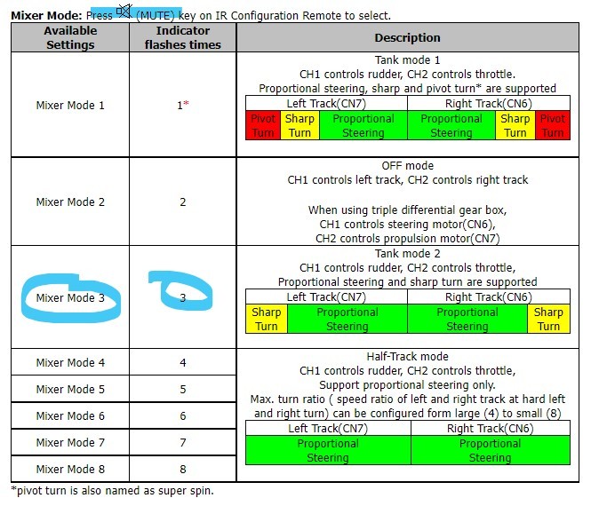

                            My Mato metal PZ3 only sheds tracks when they get loose. Have you adjusted the Clark board to limit the steering to remove the neutral turns? As in skid steer only? Makes the control even better because of the short track base.
                            • #15
                              I have not. As this is my first Mato and Clark, how do I do this?
                              • #16
                                On the Clark website for the TK-22 which I believe is the board you have in yours, you use the Sony remote and battle system to set the track control to #3 using the mute button on the remote. It turn off the "super spin"/neutral turns. It just makes the tank behave more like the real one using only the skid steer. It will change the way you drive as moving the stick directly left or right won't make the tank move. You need to add some forward or reverse throttle into the left or right for it to turn.
                                • #17
                                  Thanks Tank! I don't have the remote or IR.

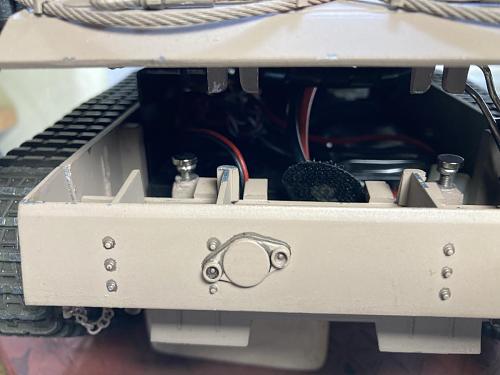

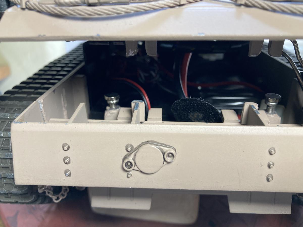

                                    Weather (humidity and downpours) along with last week of freedom before school starts, have kept me from tank work. I did manage installing magnets for the upper hull and remove the factory thumb screws Click image for larger version

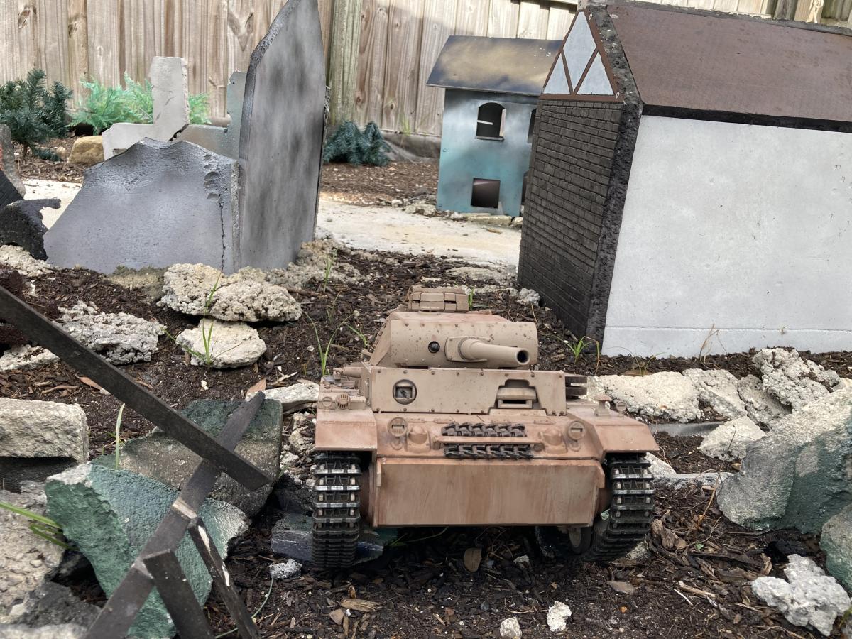

                                    • #19
                                      In my excitement I forgot to super glue a track return wheel on. Yep. Lost one. Tracks adjusted and no de-track. Did some pigment for now but will re-spray later. Drove the Pz III hard for about 30-45 minutes and it ran like a champ.
                                      Click image for larger version  Name:	image_82431.jpg Views:	3 Size:	227.3 KB ID:	352506
                                      • #20
                                        What exactly do you mean by "super glue a track return wheel on"? Aren't they screwed on?
