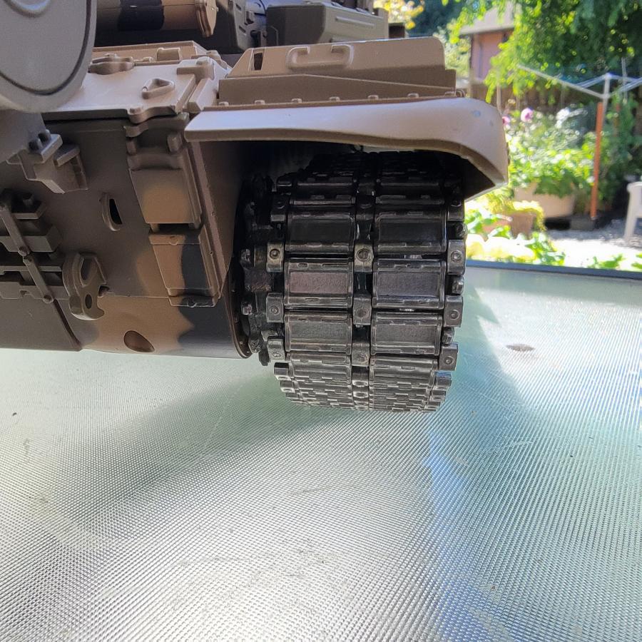

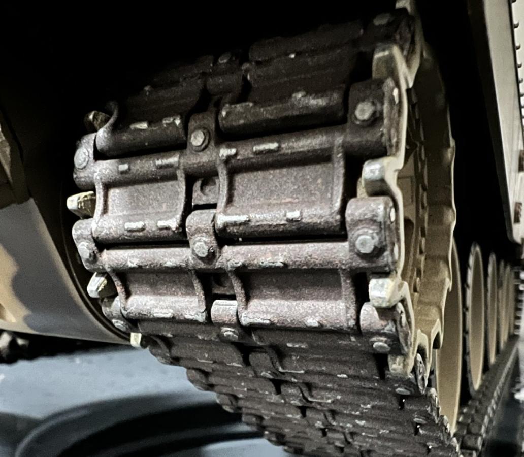

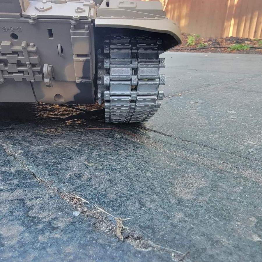

    Hey Folks!
    I bought this Mato T90 about 3? months ago now and it has been nothing but problems (Mato's horrible customer service doesn't help), Iv had to fix the wiring to and now am trying to figure out how to fix the drive Sprockets as It appears one of my metal ones is miscast and throws the track constantly. Does anyone have suggestions on fixing this other than just replacing the sprocket? (Iv been eyeing the HL metal ones from toucan hobby but have no idea if they work with mato tracks)
    Any advice would be great!

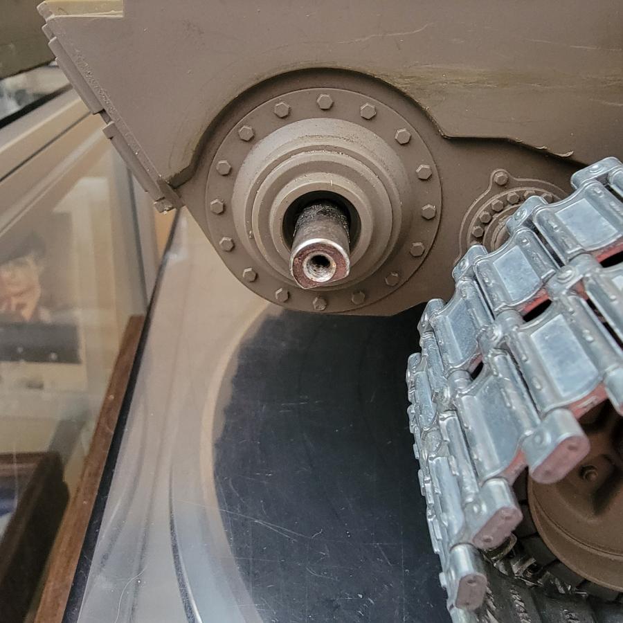

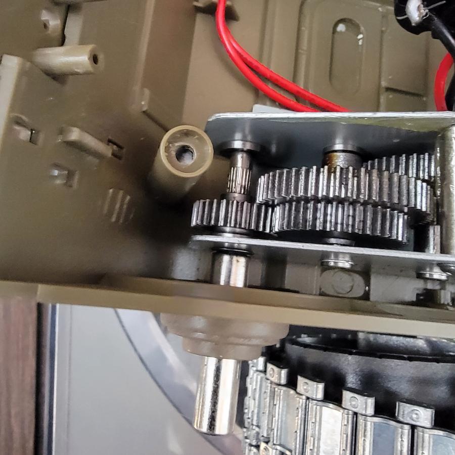

    The fix is rather simple. But before I get to that, first question do you have drive shaft hull bearings supports?
    • #3
      What do you mean? Im fairly new to Rc tanks.
      • #4
        Does the rear drive axle have a support bearing in the hull? It would be visible when the sprockets are removed. The bearings improve the axles rigidity and keep them properly aligned. It is important to have when running metal tracks and sprockets on the T90/72.
        If you do not have the bearing the first step to solving the issue is adding them.
        • #5
          Hmm doesn't look like it......
          • #6
            Nope you do not have the support bearing. Ok then that issue number one. You should add one on both sides. Once that is done then see what happens. I suspect that the issue will be reduced a fair amount. If it continues then on to the next tweak which is also simple.

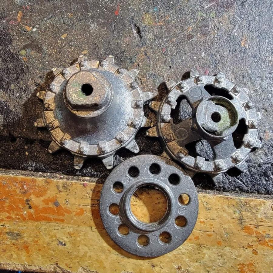

                              Your pix on the right makes the sprocket look like it is too wide, are you sure the outer hub+2 discs+ inner hub are just not seated well due to casting flash rather than warp? Here is how tightly mine assembled:
                                Click image for larger version Name:	IMG_0249.jpg Views:	0 Size:	117.5 KB ID:	352941
                                I have mato tracks\Sprockets (with 1 sprocket being a miscast I tried to fix...), They only have 1 ring which could also be the problem. Im honestly debating grabbing some metal henglong Sprockets to see if that fixs the issue also.

                                  Sprockets alone be them HL, Mato or Taigen/Torro will not fix the issue you are having with de tracking. Unfortunately it is a design problem that tends to show its face more when metal tracks are uses and more so on the right side.
                                  Like I said the fix is easy and I will tell you once you have the bearings installed. Without the bearings the fix is less effective because the sprockets still have to much random movement and this leads to de tracking issues.
                                  Dual track retaining rings vs single ring is also not the solution and actually causes more issues then they solve especially if the tank is driven in loose soil or sand as this material tends to pack between the rings and cause the guide teeth to ride up over the material and thus the track moves off the sprocket.
                                  I have several T90/72s some dating back to the 5.2 version and have seen the issue on a dozen others. I have also fixed the issue on all of them. Take a look at my Instagram @ Fsttanks to see some of my T90/72s being driven rather hard and with no track issues.
                                  There is no harm getting a set of HL metal sprockets, I actually prefer them over the Mato ones. HL has two versions one with 1 retaining ring and one with two retaining rings. Either is fine but use only one ring.
