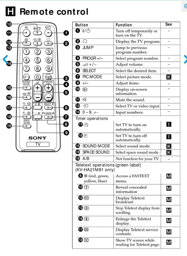

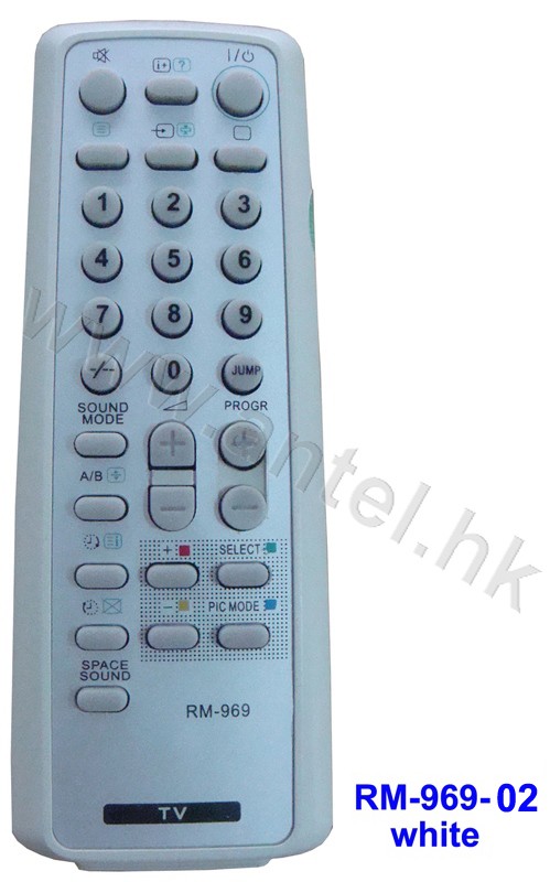

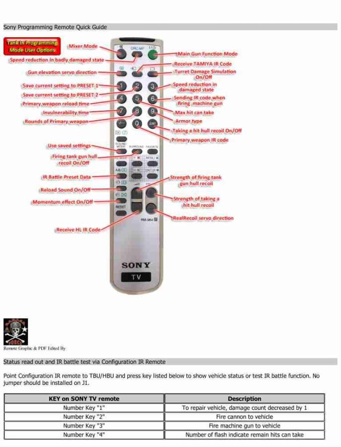

    Here is some info about the remote I think you have.
