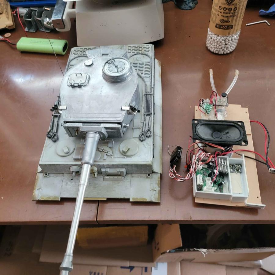

I was just about to order the parts I need to fix up my taigen tiger 1 however after seeing the total im on the fence. Id have to order the following parts totaling $365 Canadian and am wondering if I would be better off just buying a used taigen and stick metal parts on it. The finished build would look like this,
Mato Full Metal Turret w\Recoil and IR (Already have it)
Tk22 Board (Already have it but will prob upgrade it)
Plastic Taigen Upper (Already have it)
Tiger 360 turret ring
Upgraded Smoker(Already have it)
Taigen Early Tiger Metal Tracks (Already have it)
Taigen MEtal Suspension Arms
Taigen Early Tiger I Metal Wheels
Taigen Tiger I Metal Hull with 4:1 TG 270 Gearboxes
Taigen Tiger I Metal Sprockets & Idlers Early Version
Any Suggestions would be great! (Also anyone know if a Taigen Commanders Copula fits on a mato turret?)
