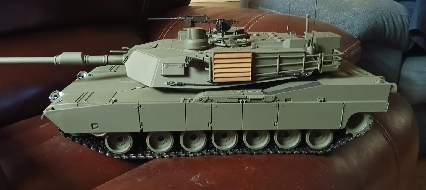

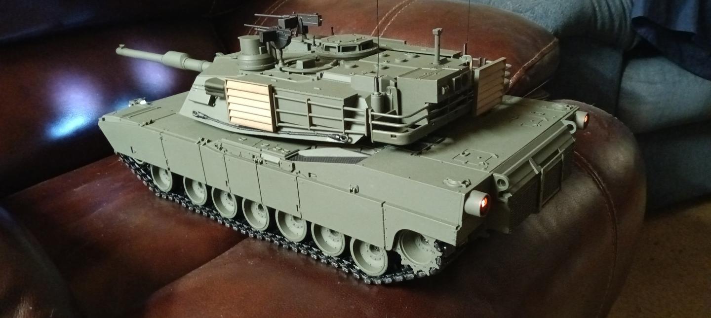

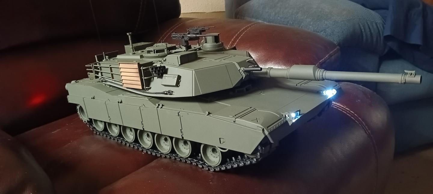

                        This is the pro edition with the metal running gear. Been painting the base colors. I'll tell you this: when buying an RTR tank make sure you break it down and recheck all the screws and fasteners or anything that has threads. I found two road wheels were barely held on by two different screws and two different sized washers and both arms were stripped out. So the solution was to take two of the 5 screws from the turret ring and use them which they fit perfectly and tightened down to hold the road wheels on. Then I used the two screws I removed and put them into the turret ring and they also tightened down. Case closed. I also had to make an extension for the loaders machine gun to get over the optic unit and also cutout a small hole so that I can turn the power switch on and off without having to rotate the turret before shutting down the tank. I just use a small screwdriver to turn it on and off through the rack next to the AC unit on the back, I assume it's an AC unit, looks like one, not sure though. I'll have to look into the real one and find out what that big box is. I worked on the Bradley's in the military (63 Tango) but didn't do anything with the M1's.
                        However, You know how they say never to volunteer for anything in the ARMY?? LOL well I did on one occasion because the driver of an M1 was sick so in formation that morning they needed a driver and asked. I was the first to raise my hand and step forward! lol I was glad I did. What an experience that was during live fire exercises.​
