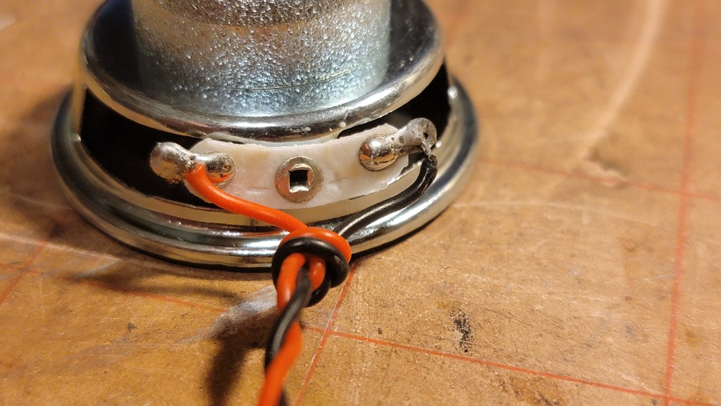

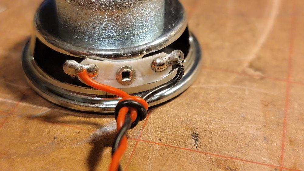

    If your tank isnt as loud as you think it should be, check the polarity of the speaker. I found one of mine to be wired out of phase. A quick batt pop test proved it:

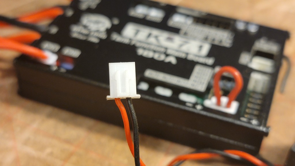

    The positve on the JST should be orientated on the left as seen here:
    Testing before and after made a big difference....naturally.

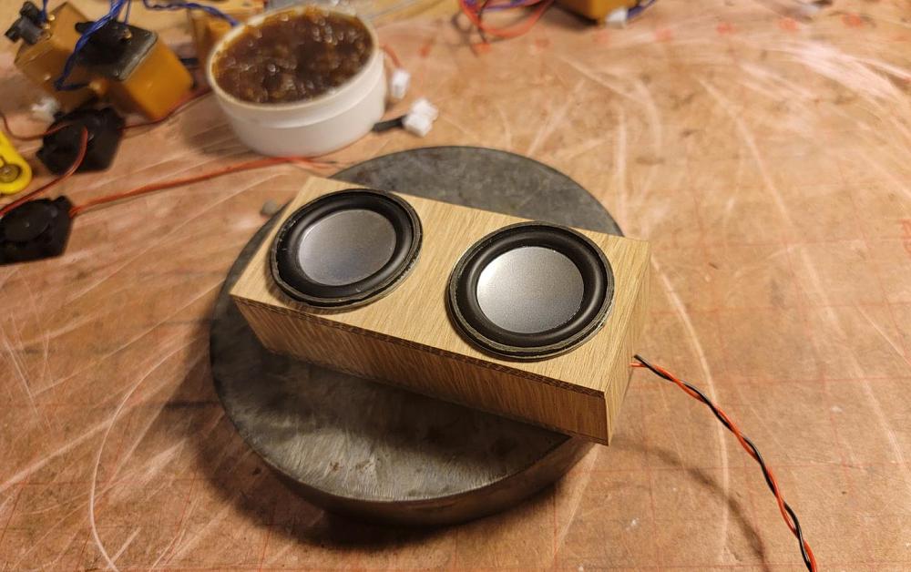

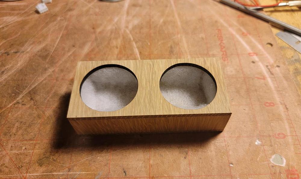

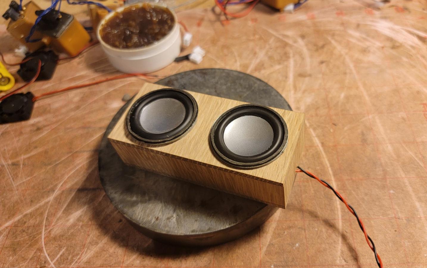

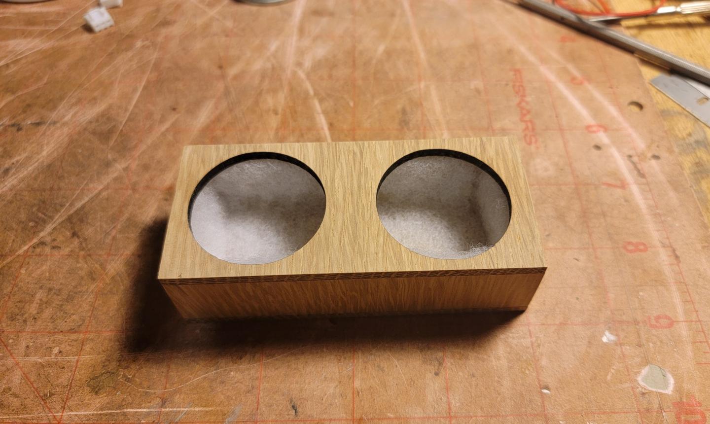

    Ahhh.......much better......
ID:	361838Click image for larger version

      Curious as to how this turned out for you did you wire the speakers in series or parallel?
