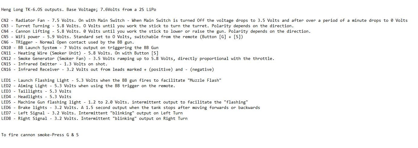

          Tony, looking at your original post you say there is no flashing light . I think were assuming that the tank in general is not operational rather than a possible headlight LED burned out or pulled loose from the Board. I see you have checked all the connections going to the Board presumably with a multimeter. Below is the voltage output for all ports. I have found that having a JST and Dupont plug with bare wire makes it easy to plug into any given port and test its output. I would advise checking the outputs to see if your getting anyting. The main switch -CN1 would be the first place to check by doing a continuity check. This of course will only tell you if the switch itself is bad (or by doing the same thing on the switch). If you plug in a jumper JST on port CN1, then the board should come to life the second you plug the battery in. If it doesnt, or your not getting any voltage from any of the ports, then that 7.0 Board is DOA.
          Click image for larger version  Name:	Capture.jpg Views:	0 Size:	159.0 KB ID:	369444
          Let us know your findings
