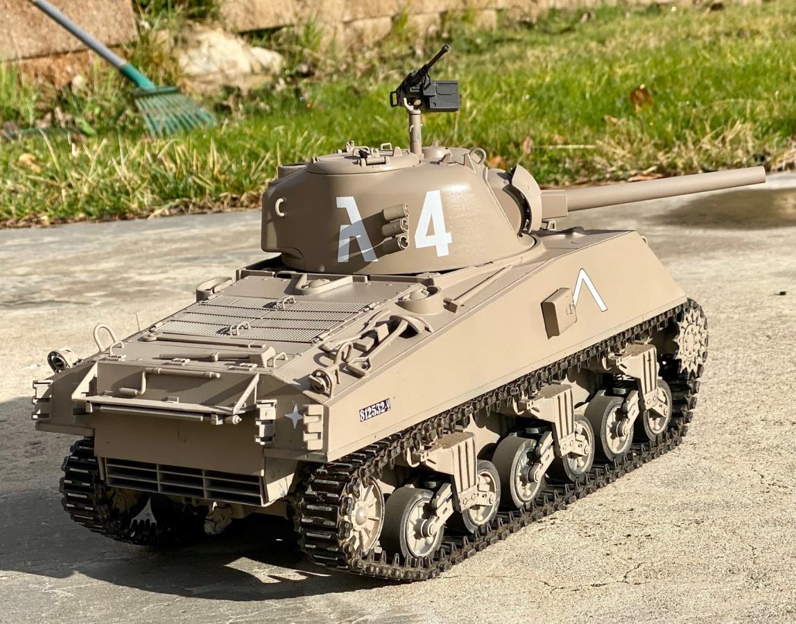

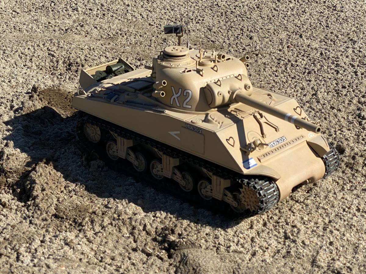

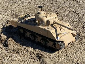

            Chef, here's what I had and what I used for inspiration:
            Click image for larger version  Name:	M4 IDF 08.jpg Views:	0 Size:	308.2 KB ID:	369564Click image for larger version  Name:	M4 Israeli 01.jpg Views:	0 Size:	167.8 KB ID:	369563
            Here in Southern California it seems that tan tanks fit in better!

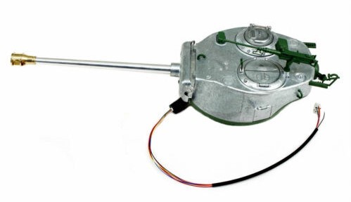

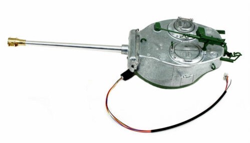

              Got an idle (for now) question for the cognoscenti: I'm working on the Mato Sherman, and I notice that Torro makes a 76mm turret for their Sherman. Will the Torro turret fit on a Mato Sherman?

                The taigen / Torro brand tanks have a different (larger) turret ring than the henglong tanks use.
                I do not remember what size the mato metal hull uses but I think …. It’s the henglong size ring.
                I have one you can test with, I can drop it off tomorrow if you want.

                  Thanks. I'll compare the Mato with a HL I have. I think they're the same, which would make the Torro swap infeasible. Ah well, just a thought.

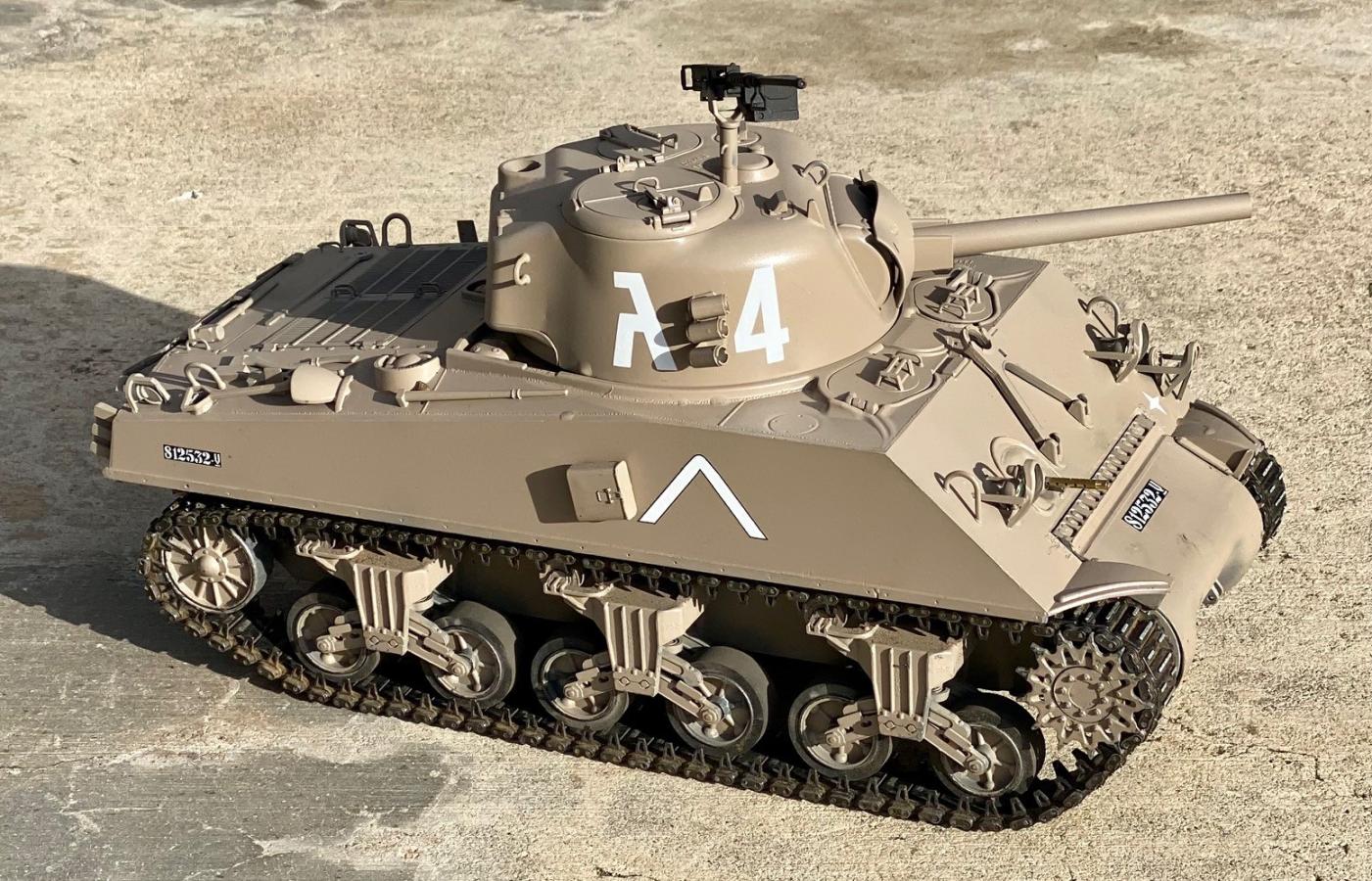

                      Notta...

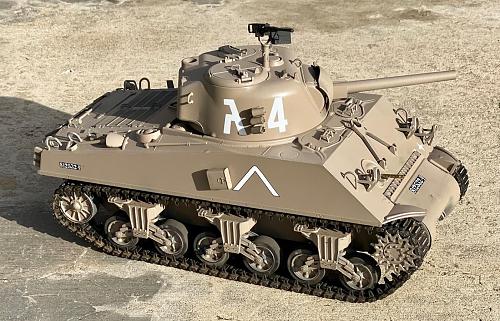

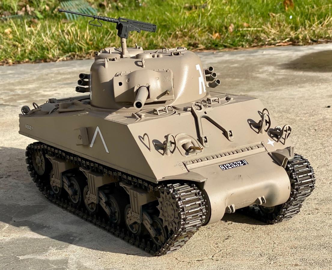

                      Not a Super Sherman, but he wants to be! Like movies that say "inspired by a true story" which means accuracy be dammed, this is a regular Sherman dressed up in Israeli colors. They were definitely present in Israel, but who's to say how they were painted up. The color is IDF Grey Sand, which looks dark in the bottle but lighter in the daylight. It's destined to be an L.A. Tank Battle event IR fighter; short barreled, small tank to navigate around buildings. The color will also fit in to the San Diego battles, full of sand and at longer ranges.
                      No detailing or weathering applied yet.

                      • RichJohnson
                        • 1276
                        Loos good Bob. This was basically what they had till the M50s were built. You could build it into an early m50 with a couple shapeways parts if you wanted to but it looks good,
                        what brand paint did you use?
                          Thanks! Just a personal preference, I'm going to keep it all metal, otherwise I'd consider a T-23 turret! The smoke launchers and the first aid boxes are metal. I'll take a look at Shapeways just for fun. For paint, I sprayed it with flat black automotive primer first, then airbrushed Vallejo's IDF Israeli Sand (year 61-73) #73.614. They call it an Acrylic Polyurethane Surface Primer, but it seems to work just like their paints. I'm working on the weathering now.
                          Ultimately I intend running a TK-50 board, but for now I've installed an HL 7.1.
                          Edit; you're right, Shapeways has some good stuff! maybe for a future Sherman..
