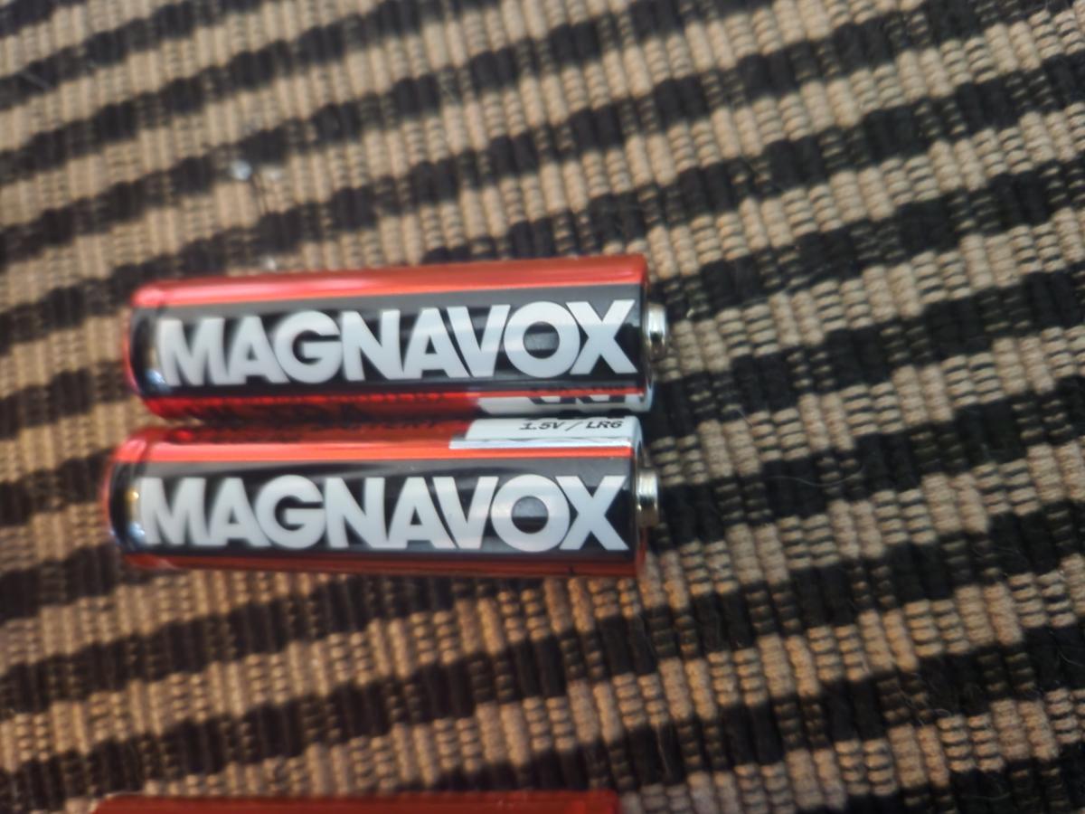

                              I found a AA battery that works without having to modify the battery box. I purchased these at a discount store called Ollie's for $2 a pack of six.

                                Battery has limited shelf life. It may not be the best idea to buy surplus stock from discount stores. Beside, you can buy fresh Alkaline AA cells from Costco at the same price of 33 cents per cell.

                                  The issue is that some AA batteries are slightly shorter than other AAs and therefore weren't making contact in the battery box. At least that is what the diagnosis was in other threads. He was making the point that those AAs worked in his halftrack.
