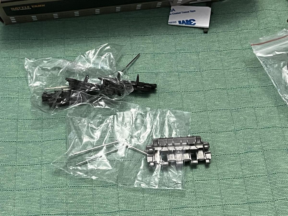

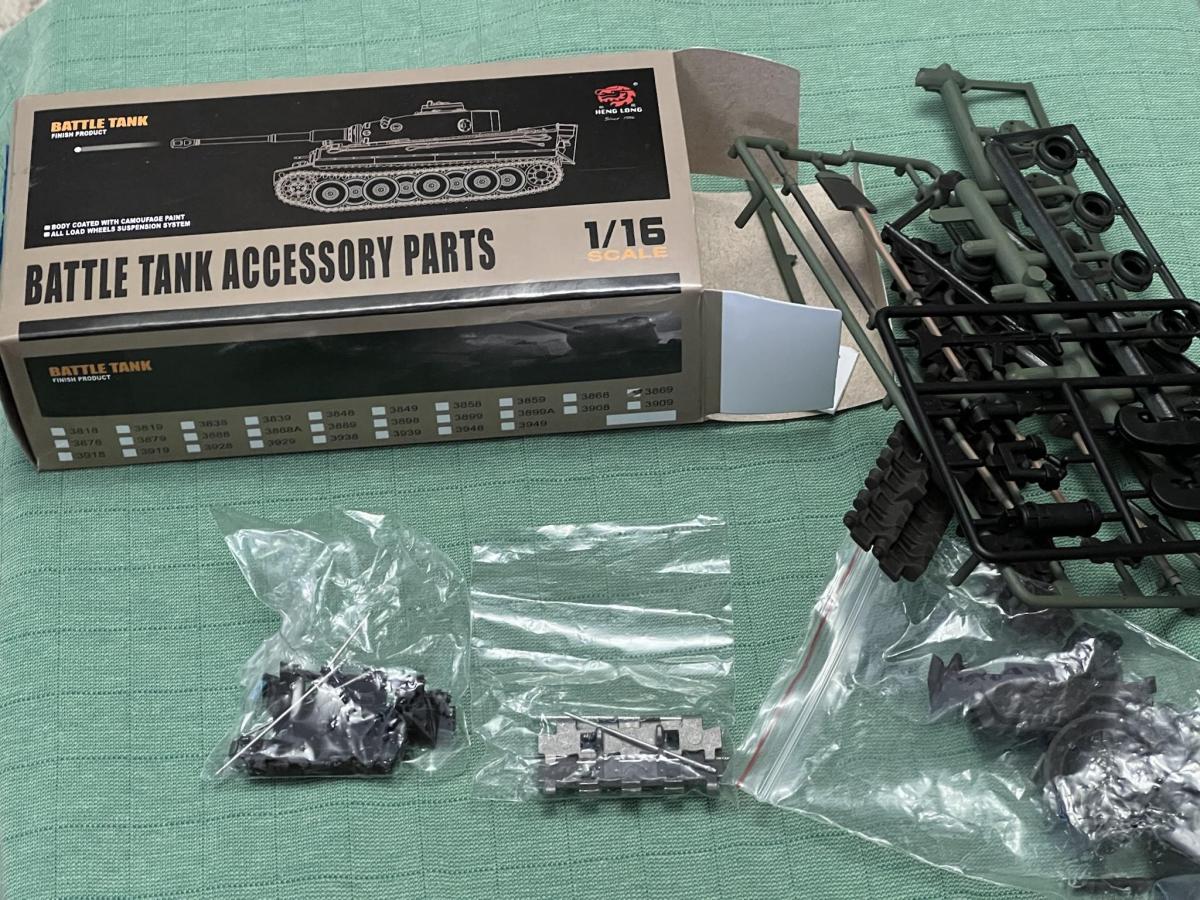

    All of my RC tanks have come with extra links and pins. Check to see if yours came with some. Usually in the small accessories box. If not Ebay, Amazon and dealers like Motion RC have them, but usually as a full set of tracks not just replacement links.
    Click image for larger version  Name:	ZJXLU54.jpg Views:	0 Size:	229.4 KB ID:	371786Click image for larger version  Name:	cSfsReM.jpg Views:	0 Size:	278.0 KB ID:	371787My Pro models have come with extra metal ones as well as the plastic ones. It must be easier for them to just toss the metal track links into the box than fish out the plastic ones.

      None of my H-L metal tread tanks included extra metal tread links, they included a couple plastic ones.
        Well that kinda sucks. All 5 of my Heng Long did and they are from different vendors. So did my Taigen.

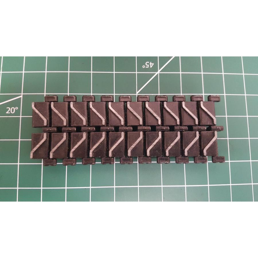

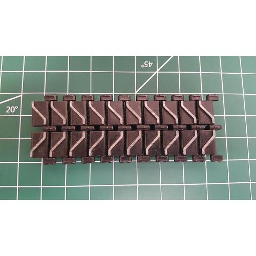

          I got my loose metal track links from Taigen tank in package of 10 links. They have 2 variety for the Sherman. However, I am not sure if the Taigen links work with the Heng Long track.

            The Heng Long metal track is very poor in design and quality. You may be interested in an upgrade using the Taigen track.

              If you want to go with the taigen track you will have to use their sprockets. Taigen track will not run on hL sprockets.
              If you cant find extra HL metal sherman track send me a PM. I dont recall noticing it on ebay so not sure if its available. Though it should be on aliexpress under tankzhang or henglong factory store. Your going to have to buy just a whole set of two tracks probably.

                          Originally posted by keilau
                          @JimboBimbo​ has the Heng Long track. Anyone knows firsthand whether the Mato or the Taigen link can be used with the Heng Long track?
                          No they can not. They are much larger links and both require their one of sprockets to run their tracks. Mato-Mato and Taigen-Taigen (Torro) .
