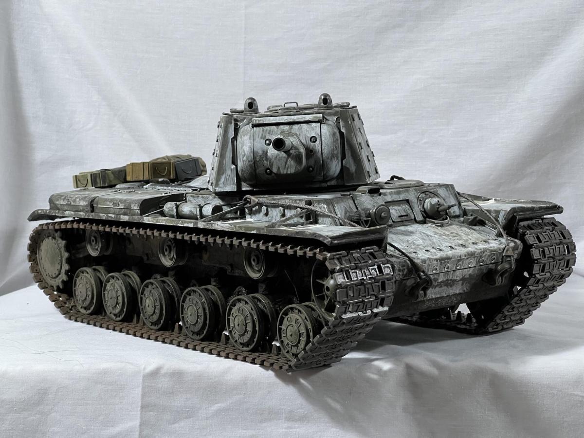

              I get where you're coming from.The cables above I first sanded then are painted with Tamiya TS=1 Red Brown and lightly with TS-38 Gun Metal and weathered with Tamiya Weathering Master set "C" Orange Rust, Gun Metal and Silver.
ID:	373027As for the paint. It hasn't flaked off but I did apply the Red Brown with probably 3 light coats since I was doing the tracks at the same time. As per the weathering, it lessens with use and touching but is pliable and I just reapply it. I've never clearcoated over the weather master stuff but I've heard you can. I've just heard like pigments the clearcoat may change the finish or color.

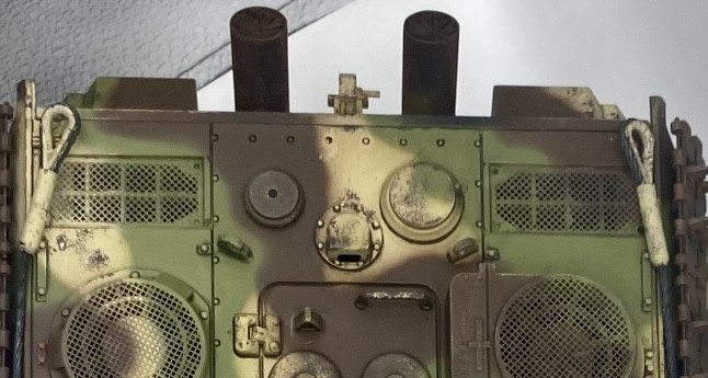

                I cleaned and primed mine with black Tamiya spray paint, airbrushed the ends with Mig Ammo acrylics, then sealed with acrylic matt varnish…… They still had minor peeling on the heads. I just used lighter base coat and some chipping color and touched then up after installation. I believe with more movement they would peel again.
                Click image for larger version  Name:	7DB28C1F-0150-4AE4-BBDE-5E2EE90E4FBE.jpg Views:	0 Size:	65.1 KB ID:	373064

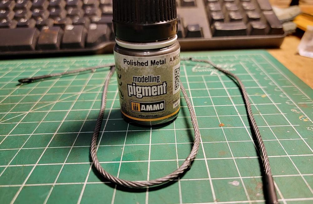

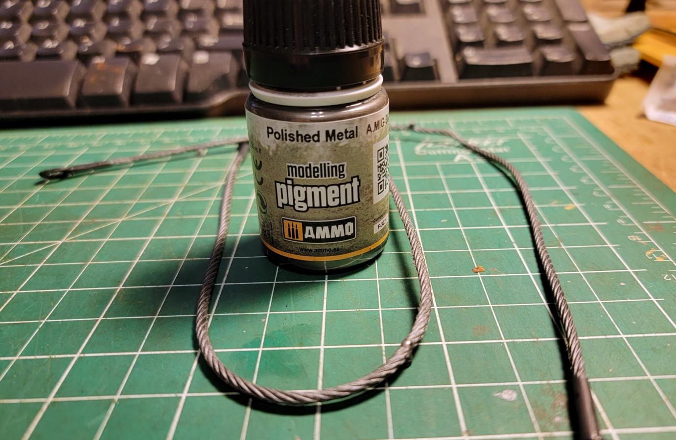

                  Pigment mixed with Mineral Spirits does a fine job, havnt had any peel or flake off...
Name:	Steel cable.jpg
